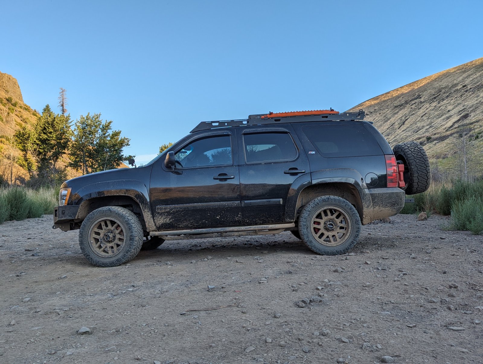

you could probably save yourself a whole bunch of money and hassle buy just buying this one
