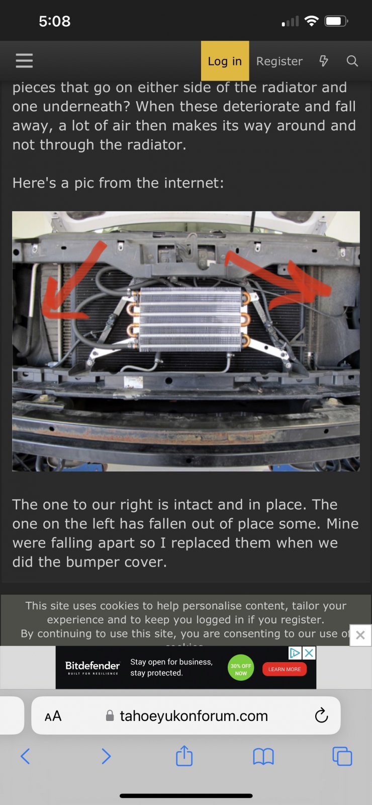

  6. Checked operation of fans, pressure test is perfect, and stared at the truck for far too long. Noticed the rubber (?) baffles to the left and right of the radiator are torn and have fallen down. Figured the air is getting sucked around the radiator by the fans instead of being pulled through. Began researching and found that people have had this issue on this forum, baffle replacement has been recommended and fixed the problem for some but most threads are left dead. I’m trying to justify this working before I spend the time and money fixing it. I ran the truck with the pressure tester on it for an hour in my driveway. It never moved above 210f. Hood was up because the pressure tester wouldn’t let it close. Closed hood, and drove to find the issue was still there. My thought is that the air is not being pulled through the radiator and is being recirculated under the hood due to these baffles failing. When the hood was open, the air could easily escape causing the issue to disappear. The truck is currently at the mechanic who repaired the wiring after the squirrel damage as I decided to get a second opinion. They have double checked all of my work, found the radiator to be in good condition, and are stumped as well. Their top guy, who has thirty five years of experience, doesn’t believe the baffles could make a difference but the posts here say otherwise. Even the parts manager at the local GMC dealership said that he has never ordered a set prior to the ones that I ordered. Is there something I’m missing? Hopefully I touched all the bases. Thank you for your thoughts!

And yeah, the baffle curtains' job is to make air do its job - to go THROUGH the radiator instead of around it.
So, replace / properly install those.

The baffles don’t do much at idle - they’re there to keep ram air from going around the radiator at higher speeds such as when climbing a mountain with a heavy trailer.
