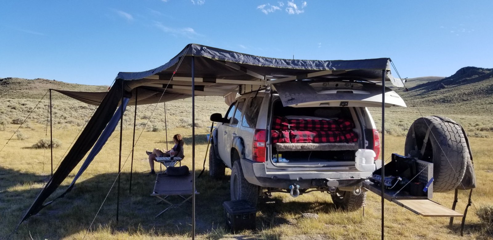

My input won't be what you are looking for because I wanted as close to OEM as possible for ease of service and repair. I did 18" GM aftermarket wheels with Nitto Terra Grappler G3 tires - 265/65/18. They handled everything the CO, NM, and WY roads and passes had to offer
A few questions about gear. You said maybe 150-200lbs. I would ask are they just doing day trips? In order to REALLY get out there, you are talking a good 12v fridge, pots/pans, food, extra fuel, extra identical spare tire, extra water for food, water for cleaning, tools for recovery and repairs, extra vital fluids, etc........Then sleeping? Ground tents or RTT (which weigh 150lbs, require a good rack and air deflector).
Is he set on his ideas, or can there be wiggle room to use as a good base and then grow from there? If so, then maybe upgraded springs, good tires, etc. Also, if it has the air shocks, then maybe stiffer springs with those as an asset would work quite well.
Just my thoughts. Happy to help how I can. Overlanding is fun!!!
