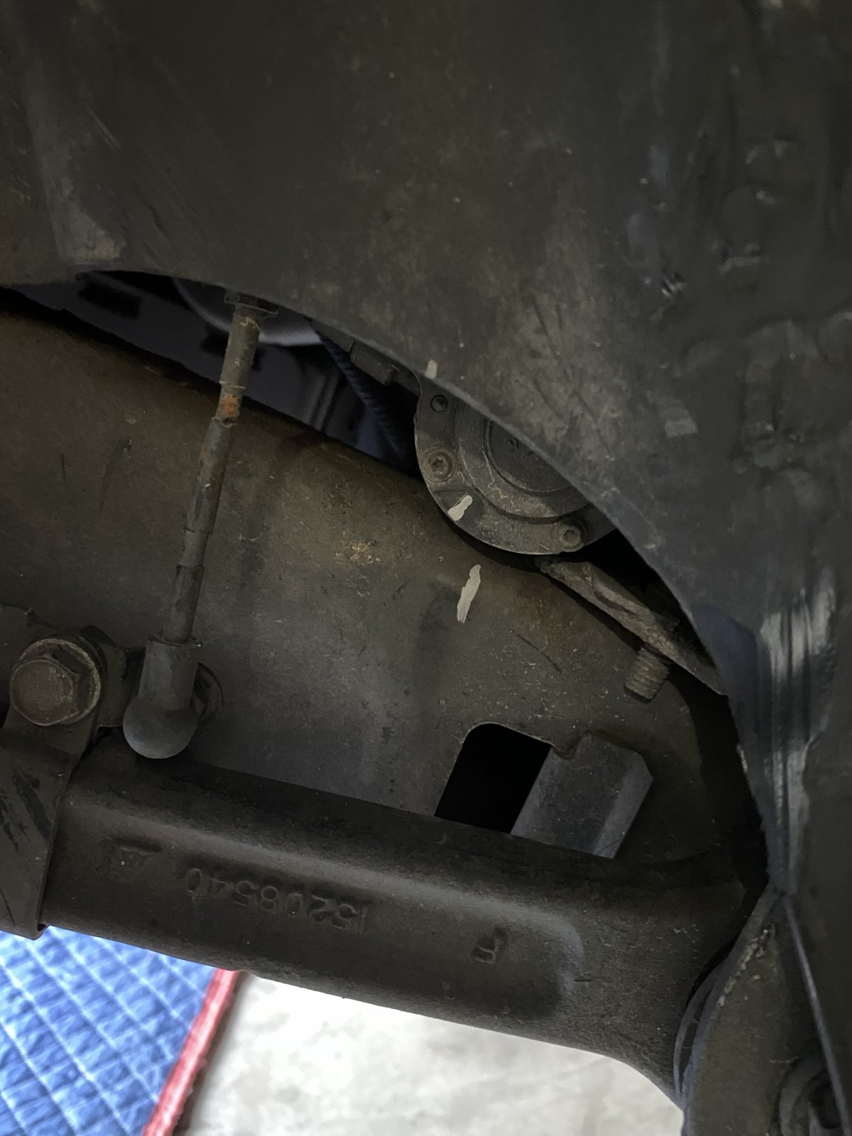

If you have ALC, you just need to make longer links for the sensor rods to put the sensors back where they were when it was at stock height. With it sitting on a level surface at stock height, before you do anything, mark the sensor locations at each corner so you'll have references to aim for when making your links after the lift.
Mine with the stock link and reference marks, misaligned cuz I lowered it:
Realigned by making shorter links out of stainless 10-24 all thread rod:
Lifting would require longer links.
