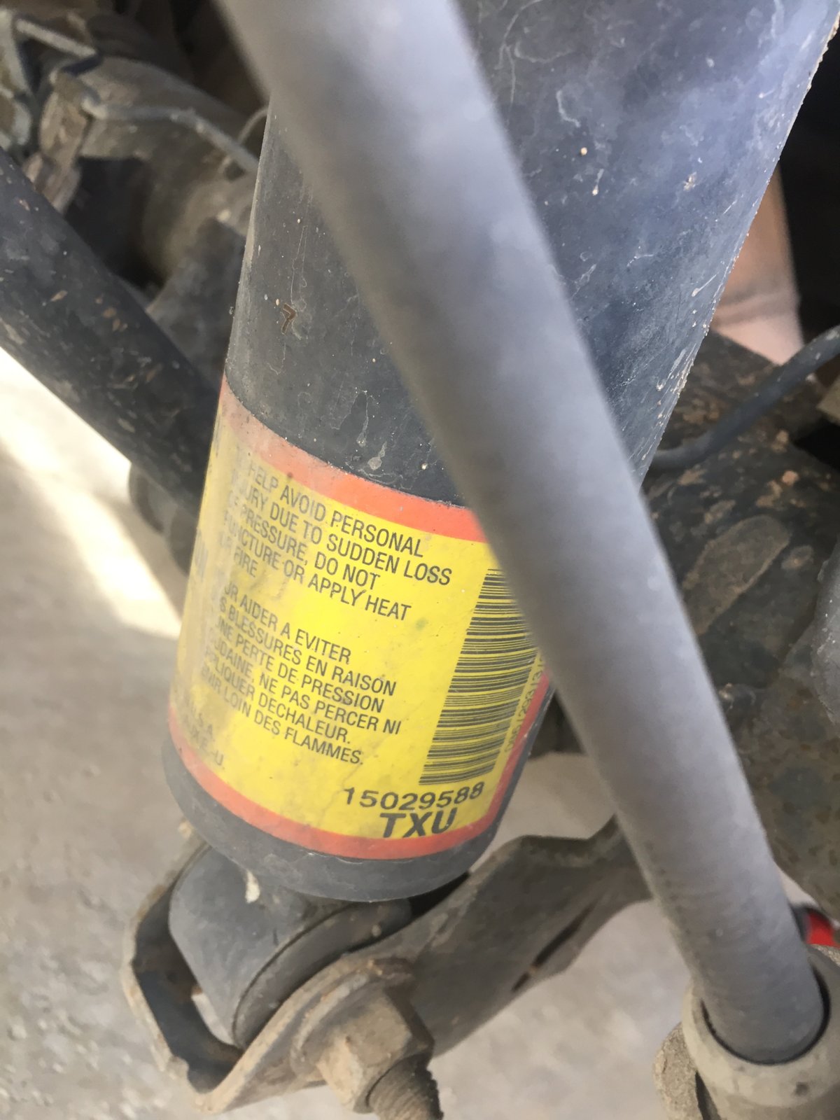

I have a 2004 Yukon 2wd with torsion bars but has 175,000 miles on it. Overall the truck drives OK however it can be rough over potholes and expansion joint etc. . I recently put new tires on it so I have ruled that out.

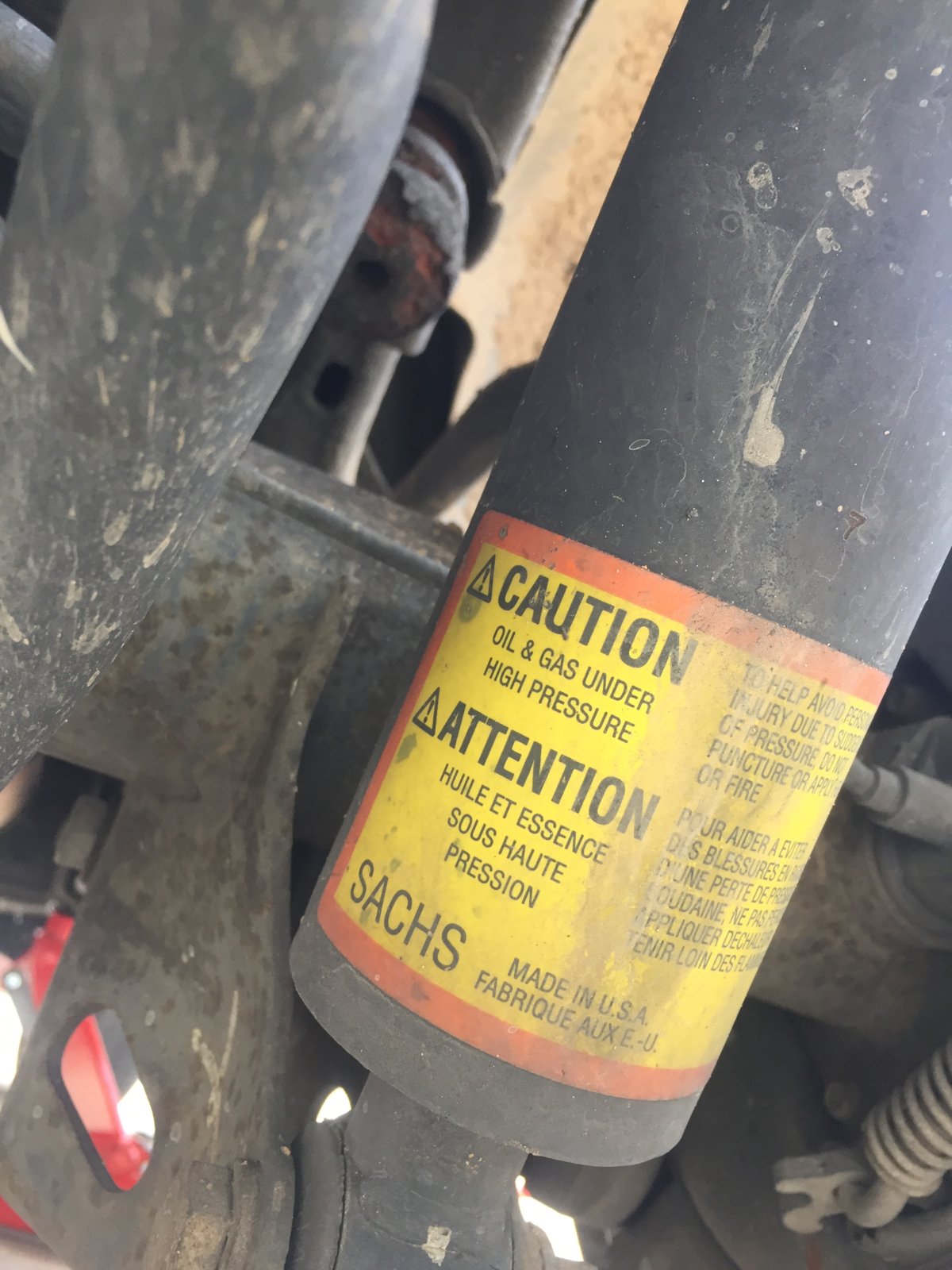

I believe that the truck has OEM shocks front and rear but I wanted to confirm. The front shocks are blue. I have attached a photo of the rear shocks. Correct me if I'm wrong but I believe that these are the self adjusting shocks that are OEM.

Also, can anyone confirm that the picture I posted of the rears are the ZW7 PREMIUM SMOOTH RIDE NIVOMAT? My glove box is stamped with ZW7 so I've confirmed that!

how much do you want to spend? Order online or off the shelf @ big box store on the corner?
Keep in mind that the rear Nivomat shocks are exclusive to the stock zW7 springs. Unless you replace the rear springs, you must buy an OEM replacement shock that performs the same way;
I'm looking @ Rancho replacement shocks sold through NAPA warehouse up the street from me.
https://www.napaonline.com/en/p/RS_RS5262?searchCategory=7.11&searchIndex=App
I'm still trying to decipher "important info"
w/o z55 autoride, except w/zW7 premium
Does that mean it can be used on zW7?
