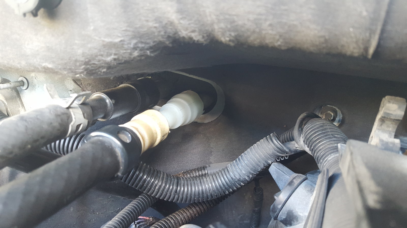

Here's the heater hose connecters I replaced.

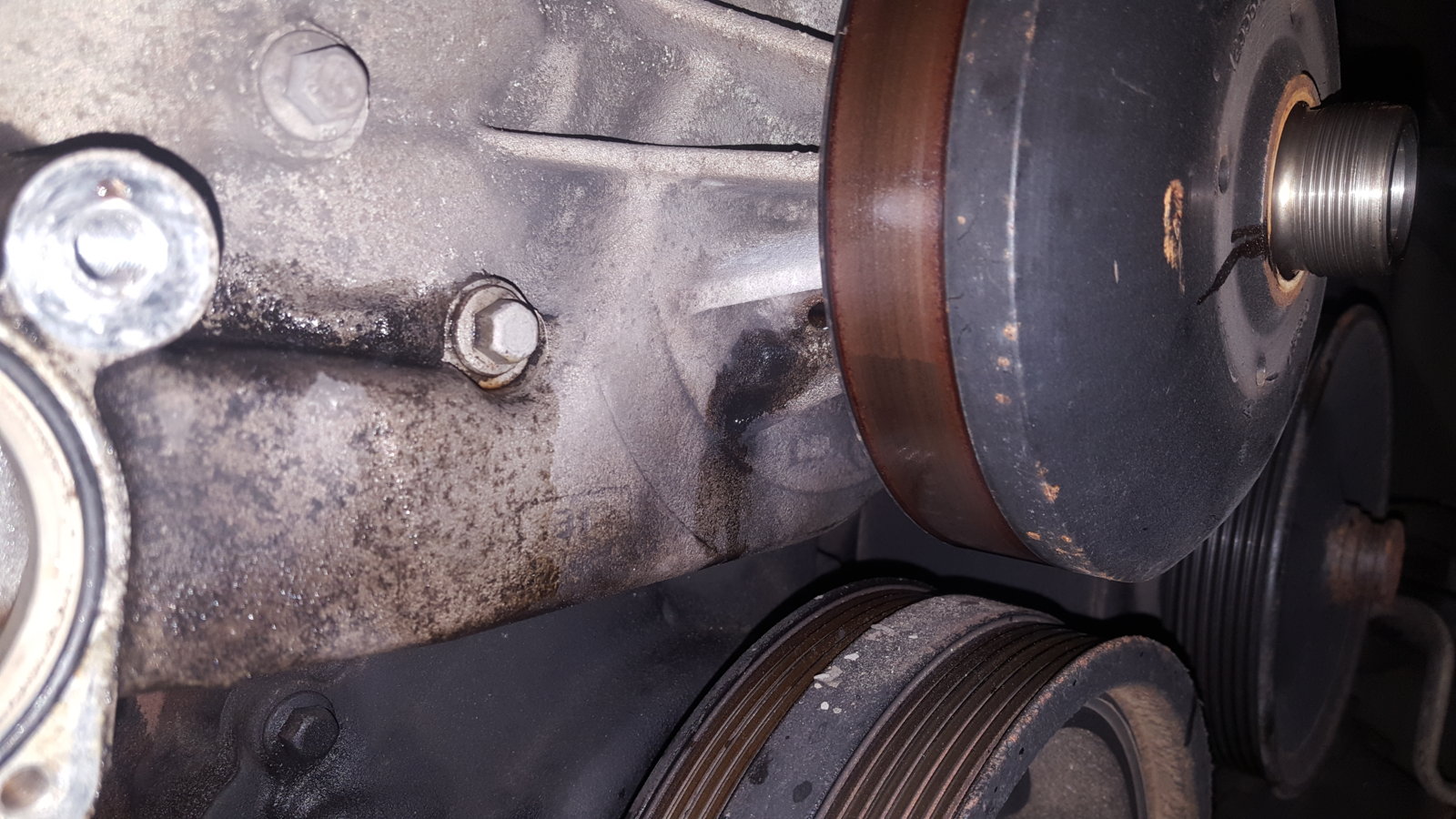

Here's the old original water pump.
Heres' the new. I did not replace the thermostat as I had purchased the wrong one. The one I need is the thermostat and the whole housing there. Yes, I know I gotta go back in, but it was a last minute discovery that I did not have the option to rectify immediately. I don't see any leaks from there though.
