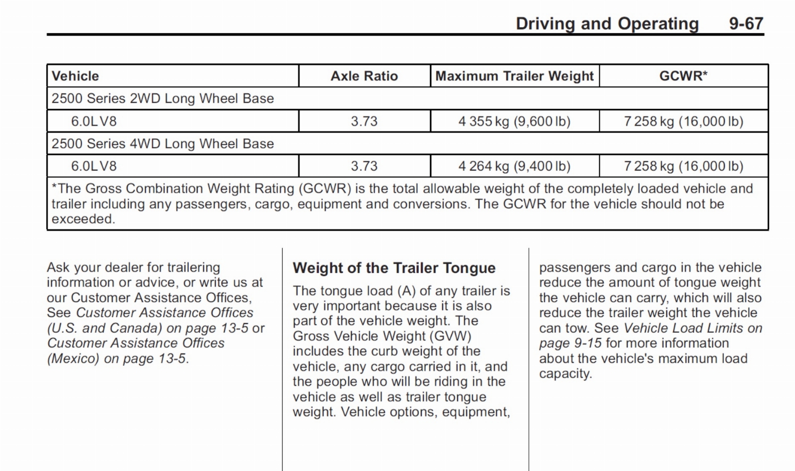

Have you calculated your GVWR and GCVWR for this trip? How much will your truck weigh with everyone and everything in it, including tongue weight? How much will both weigh together; been to the scales? Does it exceed 14,000 pounds?

You might want to get your rig weighed, to make sure you're not overloading anything. I'd bet $1 that you're overloading your rear axle.
I also would've recommended changing the fluid in the rear axle. That's the weak point on your powertrain. If you're having to install helper airbags, you're overloading something.
Keeping the transmission too cool can cause problems as well. These trucks are designed to operate at 200°. On my trip a few weeks ago, I had the transmission up to 241°. I wasn't concerned at all. I really don't get everyone's urges to add extra/larger trans coolers. The stock cooler is more than adequate.

190 Trans Temp no prob but why in that pic is you engine Temp so high. You gonna blow a head gasket.
I was climbing 8-10% grades with a GCW of over 16,000 lbs in the Rocky Mountains. The engine was working a little hard. Once we reached the summit, we stopped and let the engine cool down.
