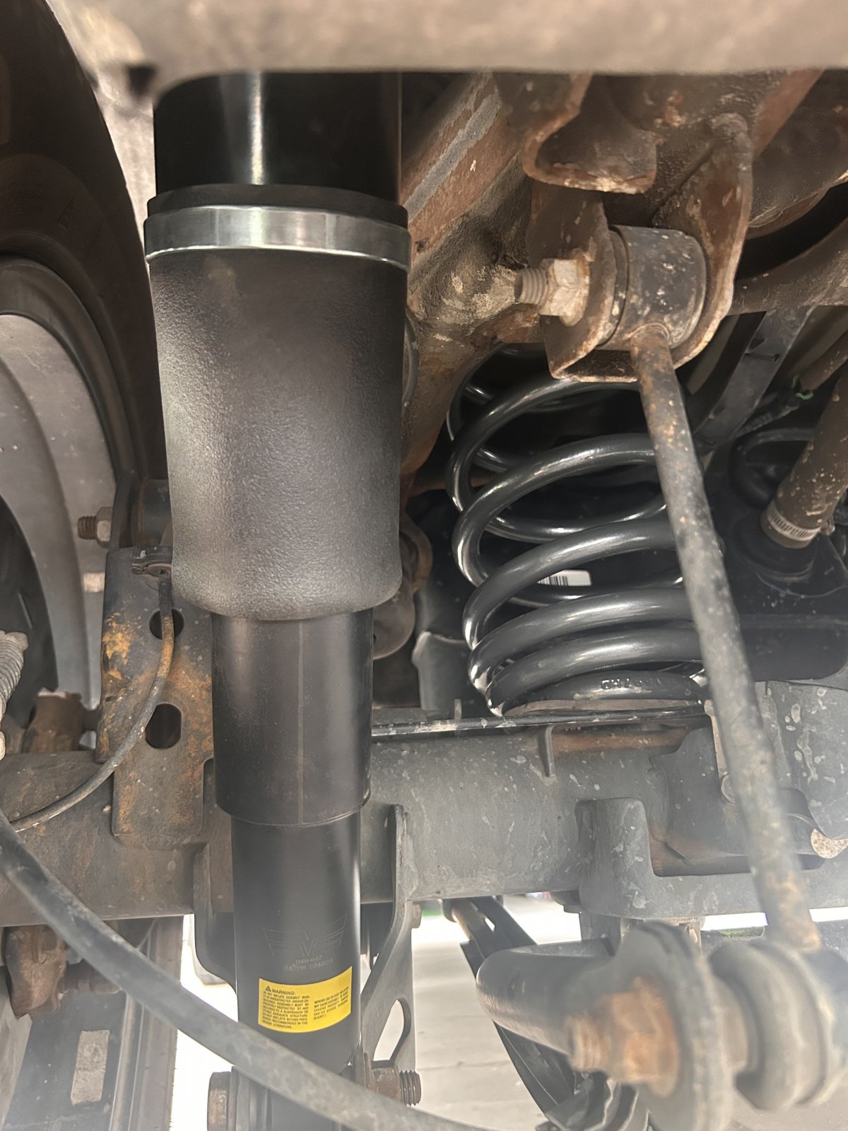

As the title states, has anyone kept the air shocks but run an aftermarket dual rate coil? Curious if this would ride terribly. My thought/hope is it would make the new air shocks last longer by taking some of the stress off while still keeping the leveling capability. We’re loaded to the gills in the back of the suburban on a regular basis.

Yes, still well within 1750 payload limit. Back hatch area is loaded floor to ceiling with cooler, bags, and all the accessories for a larger family’s road trip. Shocks are blown, replacing them this week and debating on adding the dual rate coils at the same time. I suspect it would ride rougher unloaded but looking for any real world experience.

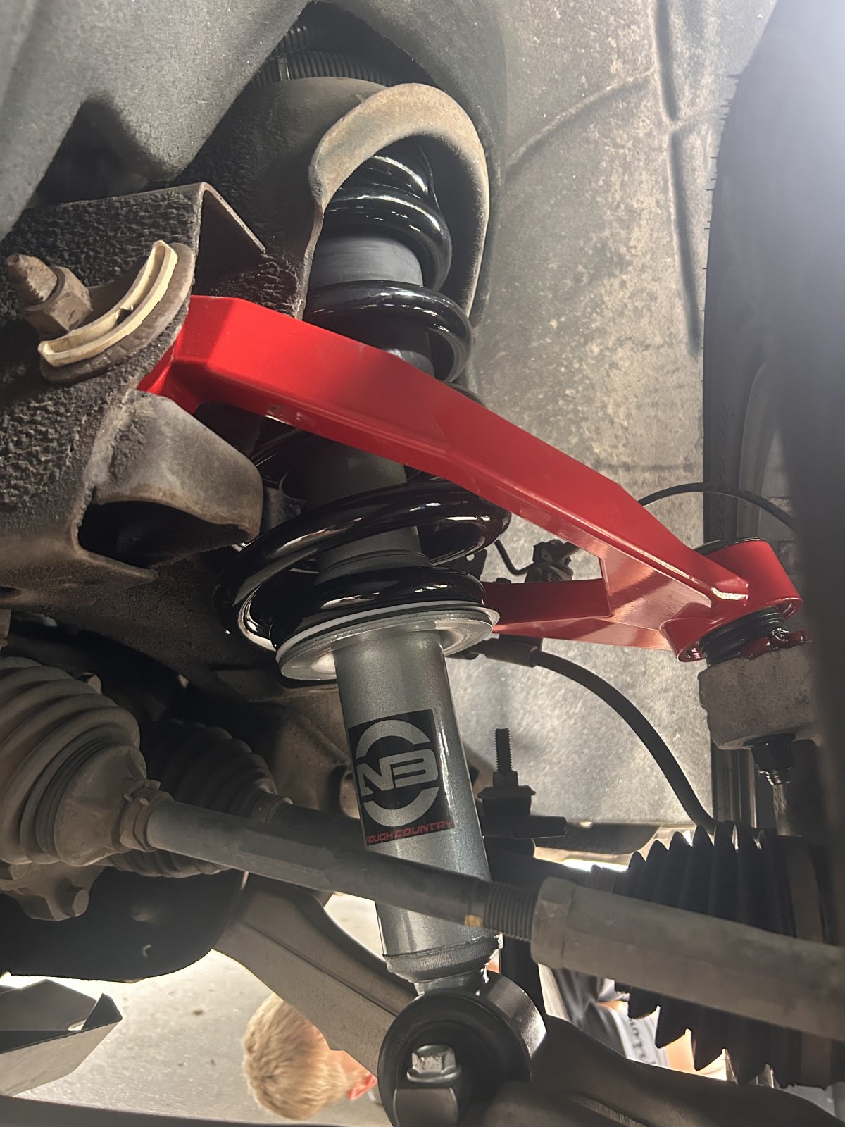

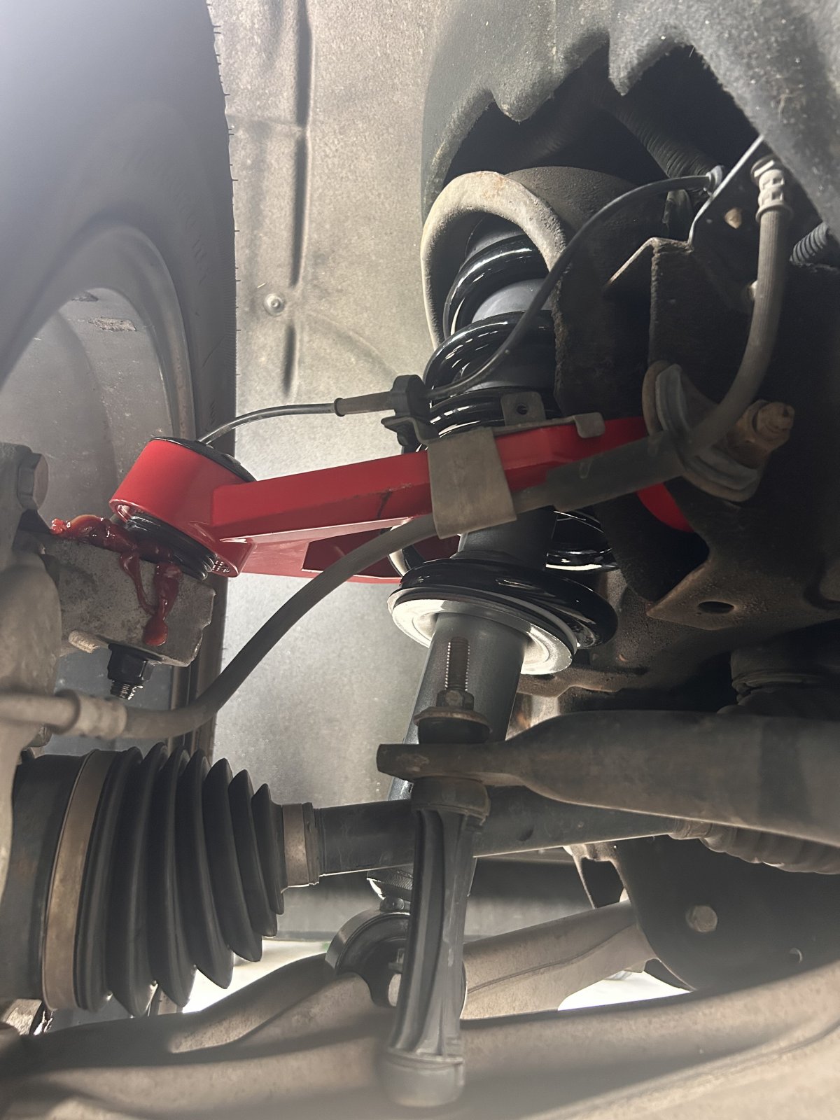

Well, had already ordered the parts so decided to give it a shot and return the coils if it was too rough. Extremely happy I tried it, even empty it rides great and still have the load leveling capability with extra support from the dual rate spring.
- Rough N3 2” struts
- RC UCA’s
- Simcoe rear coils (351-897HD)
- Dorman airshocks (949-847)
