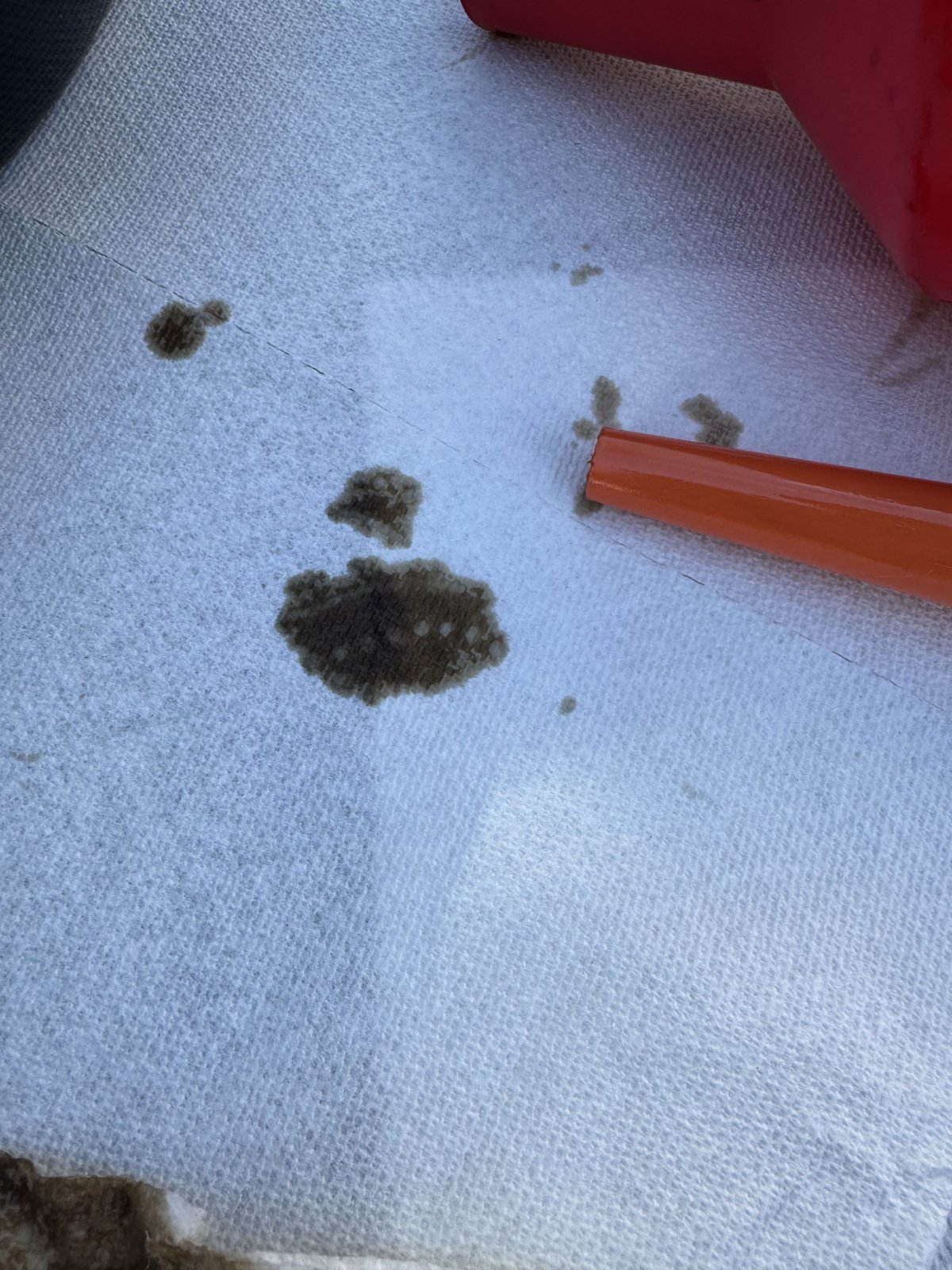

I had a warm afternoon and a spare hour, so I swapped in the new transmission thermostat bypass.
I wanted to get it done before I service the transmission because I’ll be doing some mountain driving soon, and don’t want to strain the old transmission fluid any more than I have to.
The swap was fairly easy, just a little tight with the front driveshaft in the way. Also I hadn’t seen it mentioned before, but the small plate that holds the transmission lines on the thermostat is not symmetrical. Meaning you’ll need to be sure to double check the orientation otherwise your bolt won’t line up.
Other than that, the install was a breeze, and I only lost a few oz of fluid. I added half a bottle of lubeguard to help the aging fluid until I can do a drain and fill or a pan drop.
Took it for a test drive up the westbound side of i70 where it climbs out of Golden, CO (65-70mph up a significant grade). The hottest temp I saw on the climb was 140F. Driving around town on the way home, I reached a peak temp of 153F.
This was all at ~40F outside temp, so I feel like it shouldn’t have an issue warming up to proper viscosity levels even on super cold days.
One thing I am curious about though, is where the transmission cooler is housed - is it connected to the radiator or the ac condenser?
I searched around and got my answer in a 6L80 thread - my 2019 has two transmission oil coolers. One is built into the radiator, and the other is built into the ac condenser.
