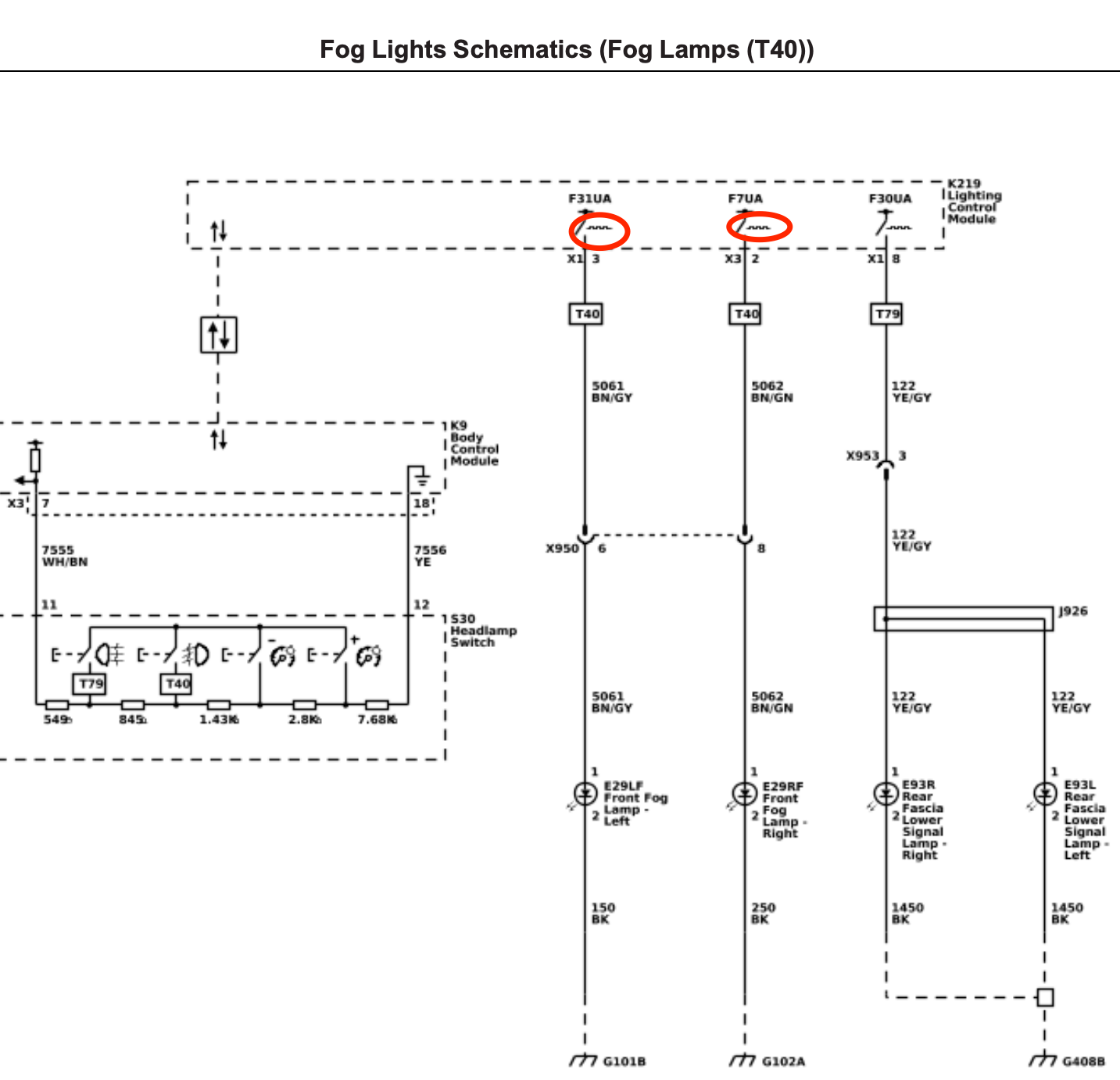

I don't think the light takes straight 12V, It takes a Pulse Width Modulated input of some sort (to the LED's). From the Schematic below, see red circled indicators. Common w/ LED's to control brightness and improve longevity.

I don't think you can do it automatically as the OP requested (so the fogs just come on whenever the headlights are called for being on by the BCM). Since the BCM just takes the input from the Ambient Light sensor and commands the Lighting Control Module to turn on the Headlights (via serial command, I think), there isn't an obvious way to do it that I can discern from the limited info at the Upfitter site.
From Pg 2-42
And here is the description of turning on the headlamps manually.
Note, I found nowhere in the upfitter manual that describes the "Fog Light" operation, but looking at the schematics of the fog lamp section, it indicates fog lamp switch (which is part of the headlamp switch, S30) is connected to pin 7 and Pin 18 of the BCM, and the Fog Light Switch and the Instrument Panel Dimmers (both of which are normally open, momentary contact switches), serve to short out various portions of a resistor divider network, thereby creating four different voltages which can bee seen on pin 7 of the BCM. Each voltage presumably serving to actuate a different response by the BCM; One of which I presume is a serial command to the LCM to turn on the fog lamps. Here is that schematic:
Perhaps one could wire a circuit in parallel to pins 11 and 12 on the headlamp switch that provides a momentary equivalent resistance across those pins to tell the BCM to actuate the fogs (simulating a fog light switch press), but then you still have to contend with where to get the signal to fire this circuit in the first place. For the manual headlamps on case, it is pretty easy, you take the ground out of the headlamp switch. For the full automatic control the OP desired, you would have to decode either the Ambient Light Sensor voltage, or the serial command from the BCM to the LCM to turn on the head lamps.
Hey, I have been wrong before, so, I may be missing something obvious...feel free to suggest any way you see to make it happen.
