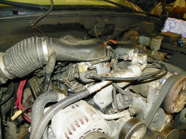

Here are the pics of the install!
Part# of the Delphi MPFI Upgrade:

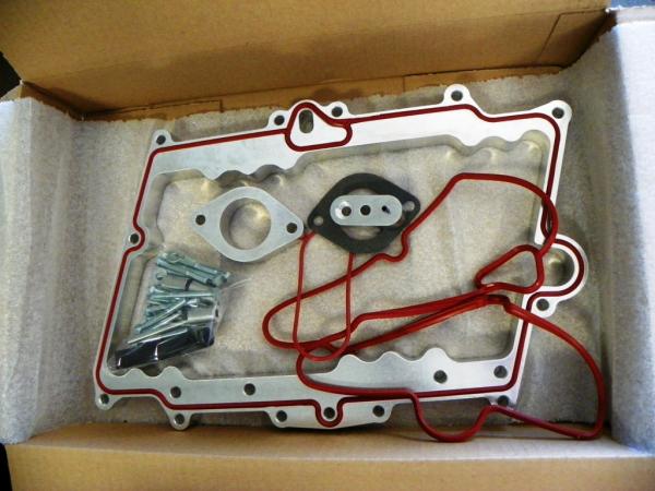

Part# of the Taylor Vmax intake spacer:
Pic of the Intake spacer:

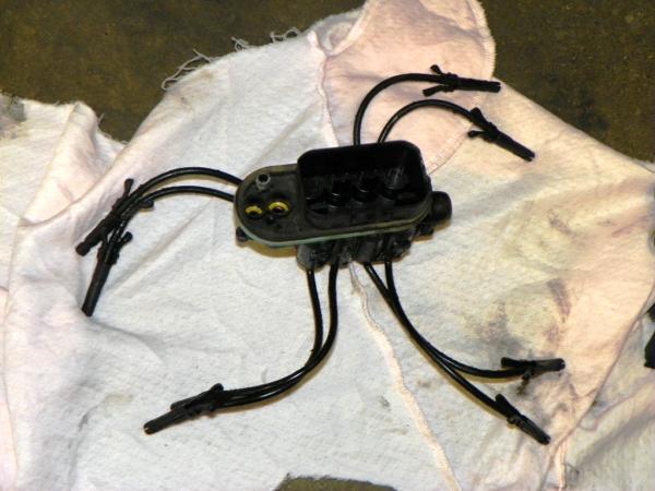

Pic of the NEW MPFI spider:
Pic of the OLD oem poppet valve spider:

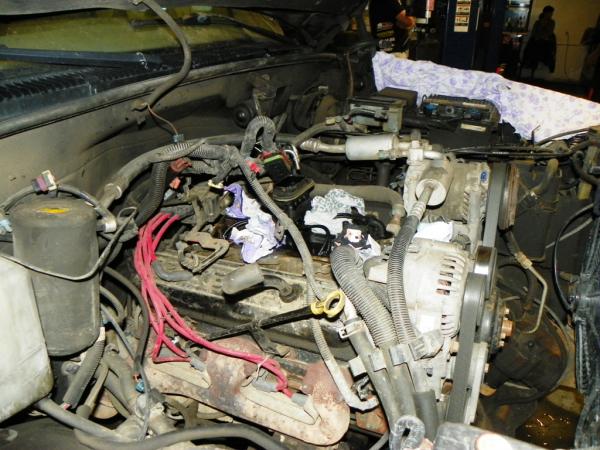

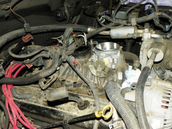

Working on removing the upper intake:
Upper intake has been removed!

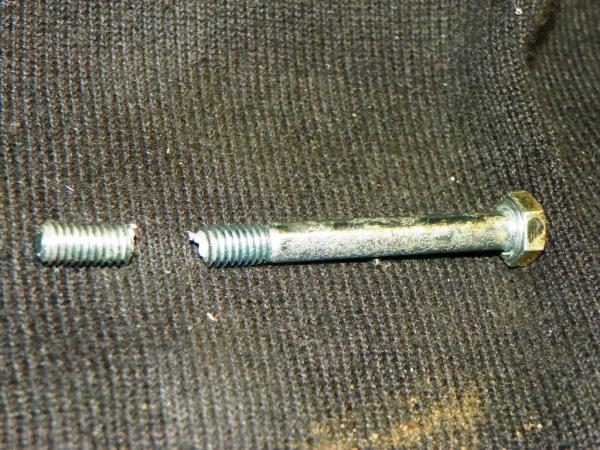

Busted bolt in lower intake, what a PITA...
Finally got the bolt out. I had to get replacement bolts, lock washers and flat washers from our bolt bin.

The intake spacer kit came with gaskets and o-rings, etc. The kit instructions were pretty adament about using those or I would get vacumn leaks. I used what came with the kit... Thanks for the info!

howd ya get it out??
Please don't laugh, but I used a small jewellers flat screwdriver against the broken lip, and hit on it with a very small hammer, very lightly. Enough so that it turned out little by little. Eventually, I could get the needlenose vice grips on it and then just turned it all the way out. :D
In my mind, I was very lucky. It could have been worse.

yea good thing the bolt broke there instead of down further. Tap and die comes out next. But whatever works to do the job!!!
