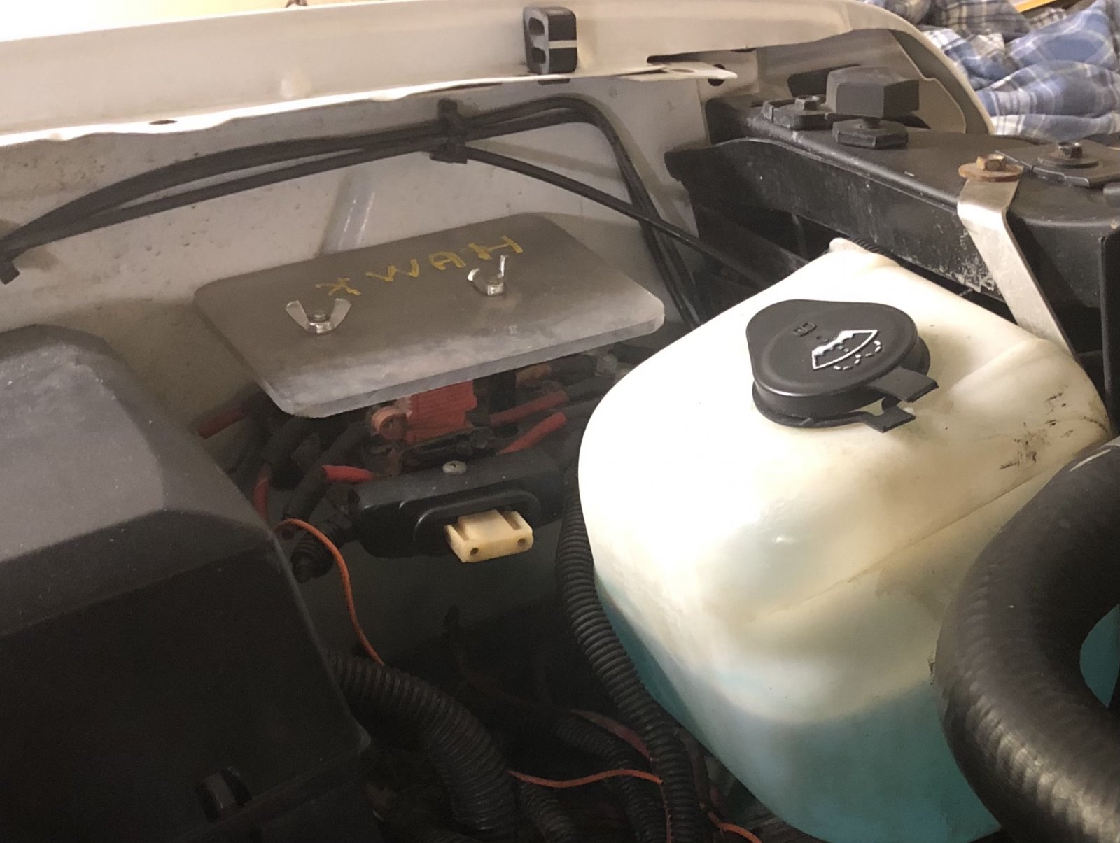

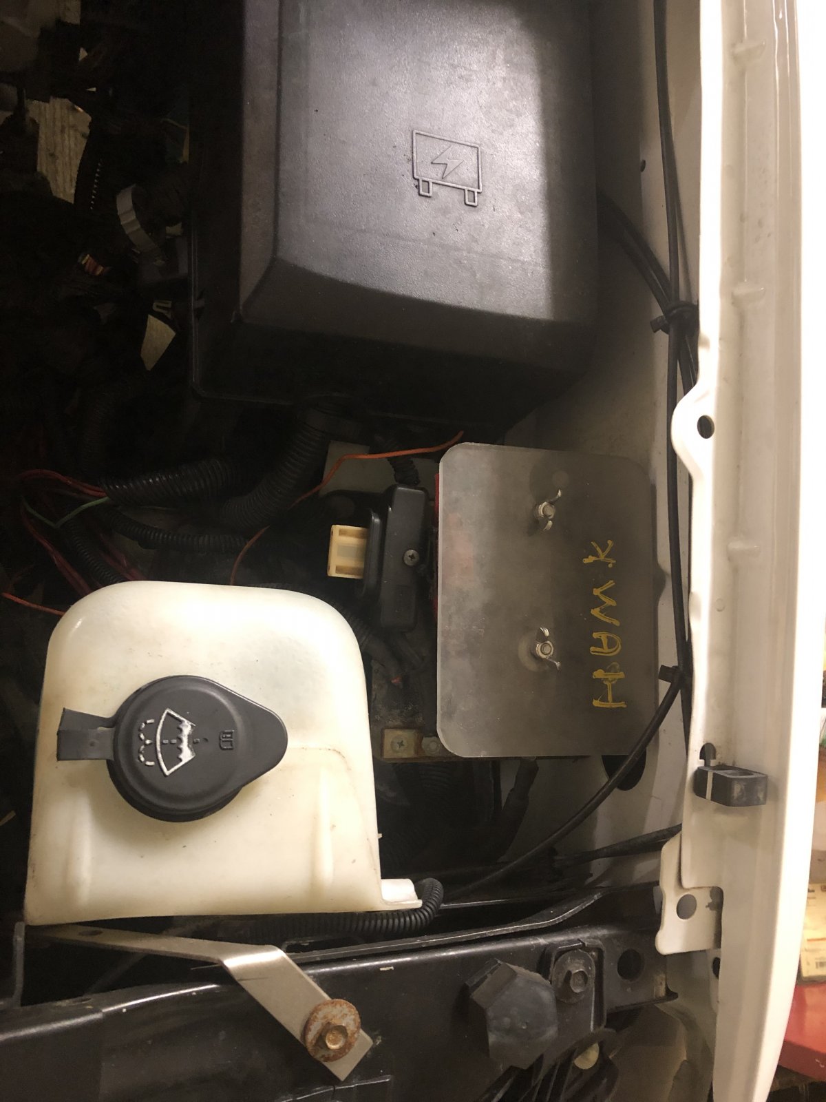

Here’s the mess they left behind :
055F711C-53EC-4909-885A-9DE41E34E08C.jpeg C507BE62-BEC5-408D-BD0A-80E40177FFE9.jpeg
