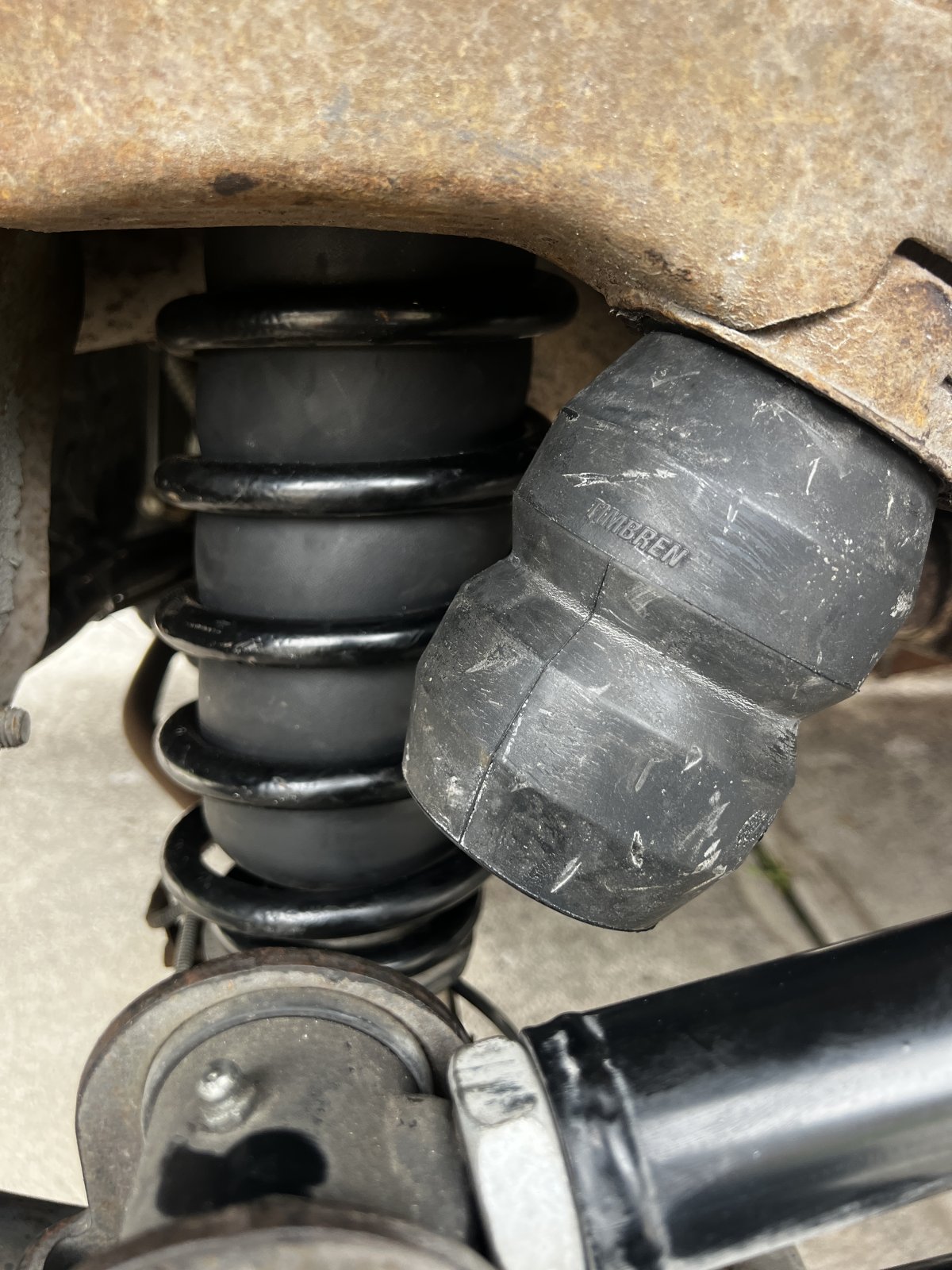

Got a pretty good deal on some Timbren bump stops from someone who never installed them.
Installed on a 2003 Tahoe Z71.

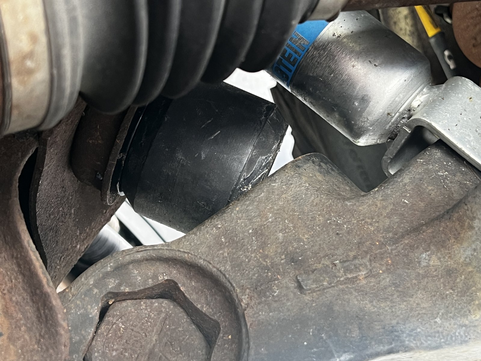

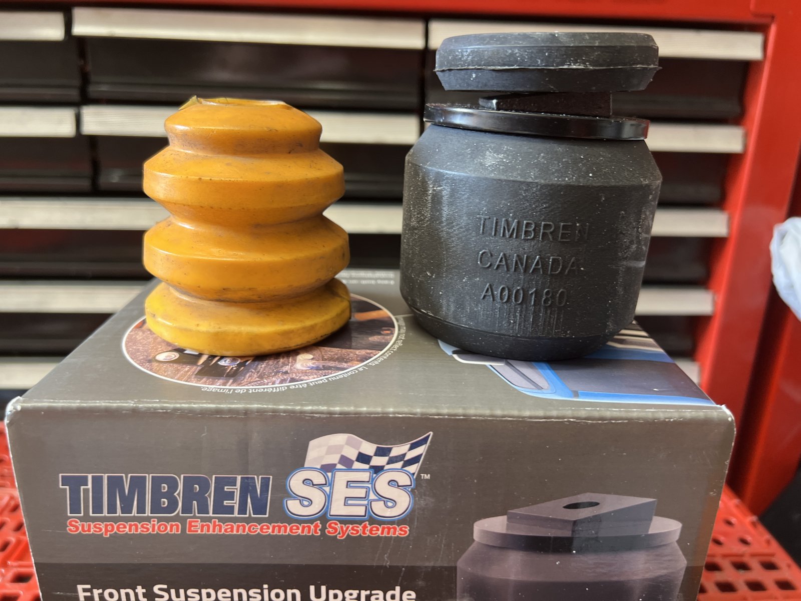

Had bump stop contact with LCA on driver side only prior to swap. Timbren are significantly taller.
Size comparison (front).

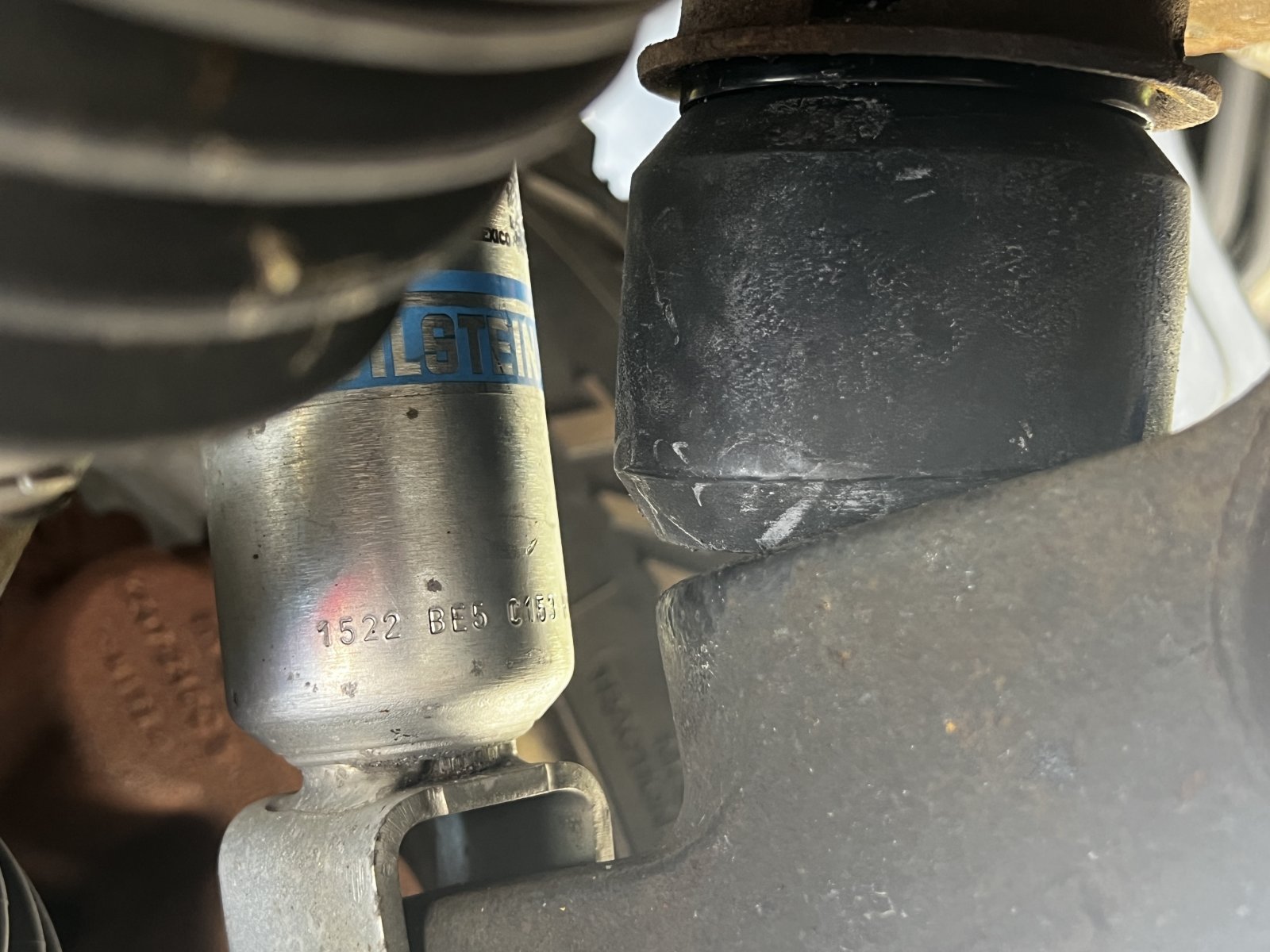

Installed:
Need to take it for a ride and have them settle in.

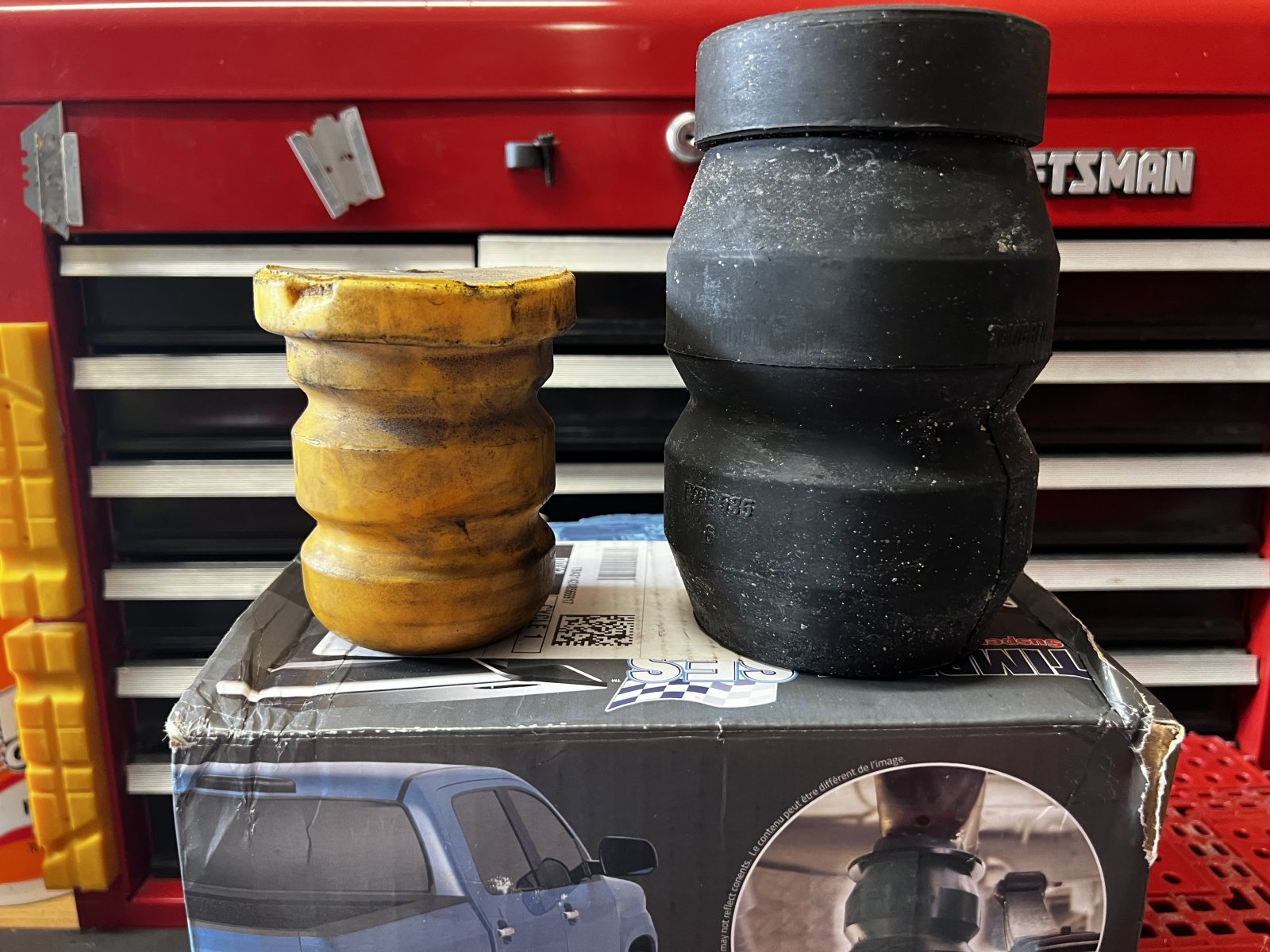

Have not replaced the rear ones yet.
Size comparison (rear).

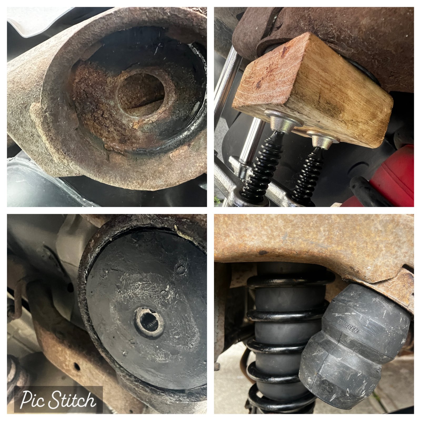

Rear upper and lower control arms, and pan-hard bar were replaced with adjustable tubular units when the original bushings gave out. Airlift bladders installed inside the springs.
The rear Timbrens have not been installed yet … on the list to be completed prior to the next road trip (along with new Z71 springs, air bladders, and shocks)… too many other projects that are more urgent pop up; moving these down on the priority list. Needs to be completed in the next several weeks though.
Under normal conditions, there will still be a gap. Under trailer load, I imagine they will contact the axel and firm up the ride.
Based upon how the front are working, the ride will be stiffer but still comfortable.
