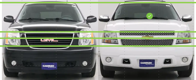

CarMax thankfully does some quality 360 views of vehicles, quick sketch up to view where the bulbs and light beams are.

The bottom of the headlights are on the same alignment (slightly different distance between the bottom corners). The 2500 and 1500 have slightly different frames and the tow hooks/ bumper mount differently.
