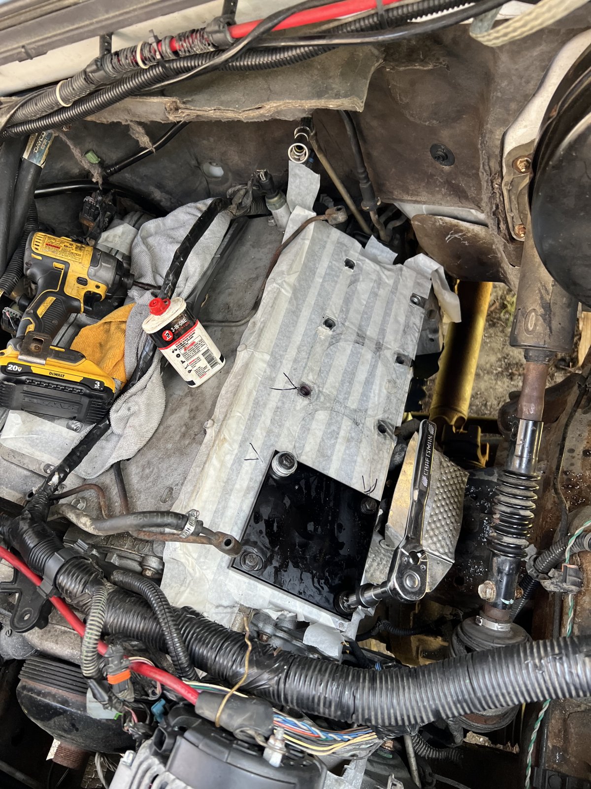

I am in the middle of replacing my head gaskets and one of my head bolts stripped out the threads. It's the driver's side by the firewall. I was on the final step of the torque procedure (it was the second to last bolt) and it stripped as soon as I started to move it.
Now I need to repair the threads. I am thinking about a time sert, but I don't have a way to get a drill in there since it's up against the firewall.
Has anyone successfully repaired one of these with the engine in place? How did you do it?

I did this in my Silverado with the time sert kit
I refused to pull the motor and actually ended up drilling it with a ratchet as that was all I could fit in there. It was nerve wracking but it’s definitely manageable and was honestly very easy the plate time sert gives you makes it foolproof.
I will say I recommend doing all the holes on that side so when you go to put it back together you don’t have another strip out causing you to pull that head again
So you were able to get the back bolts next to the firewall with a ratchet?
That's what I needed to know!

Don’t they make extensions that go in the chuck to allow an extension, hand held chuck to connect?

I was also wondering if the right angle drills would be of any help. Like the slower RPM used by electricians/plumbers for drilling holes between studs. They are high torque/low rpm.
What kind of head bolts were you using? Did you clean the bolt holes?
I took a few old head bolts and cut some slots with an angle grinder with a thin cut off disc. I use them as a poornan's head bolt hole thread chaser.
