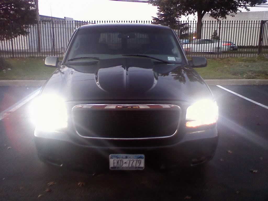

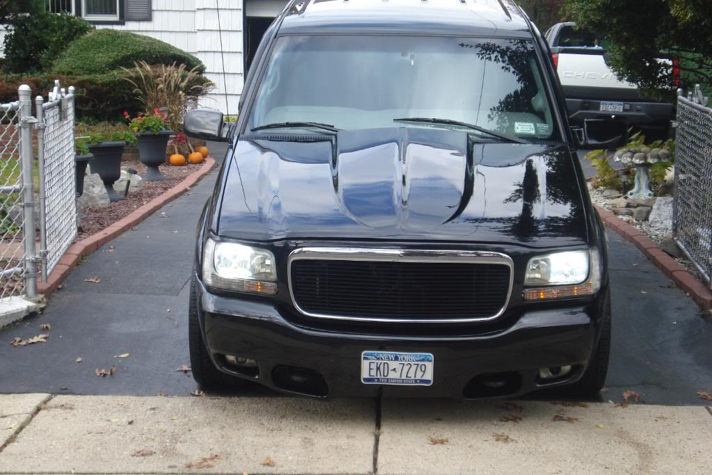

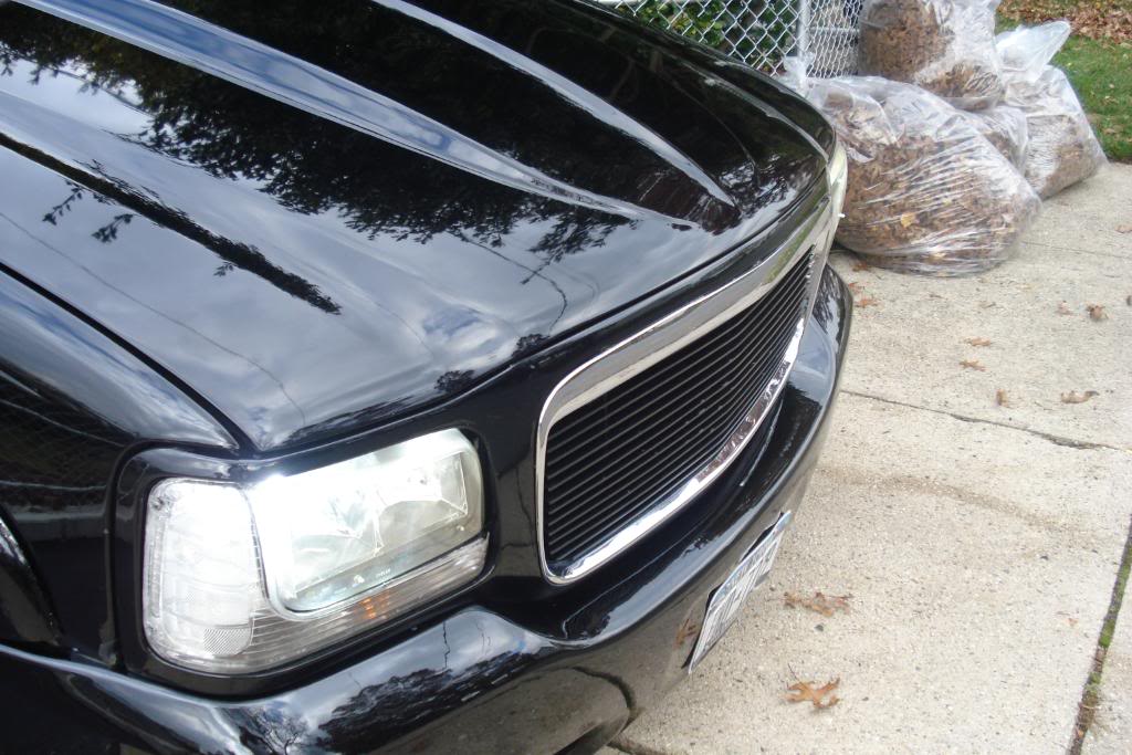

I would hit the SEARCH button...almost dure I did a write up.
Mine was a BILLET GRIll.
Chrome you ETCH to get paint to ADHere to it. I'd try the scotch pad. Multiple layers of paint.
Before:
After: Actually right after the paint dryed and installed IMMED PIC
More Pics:
Final Front End Shot
