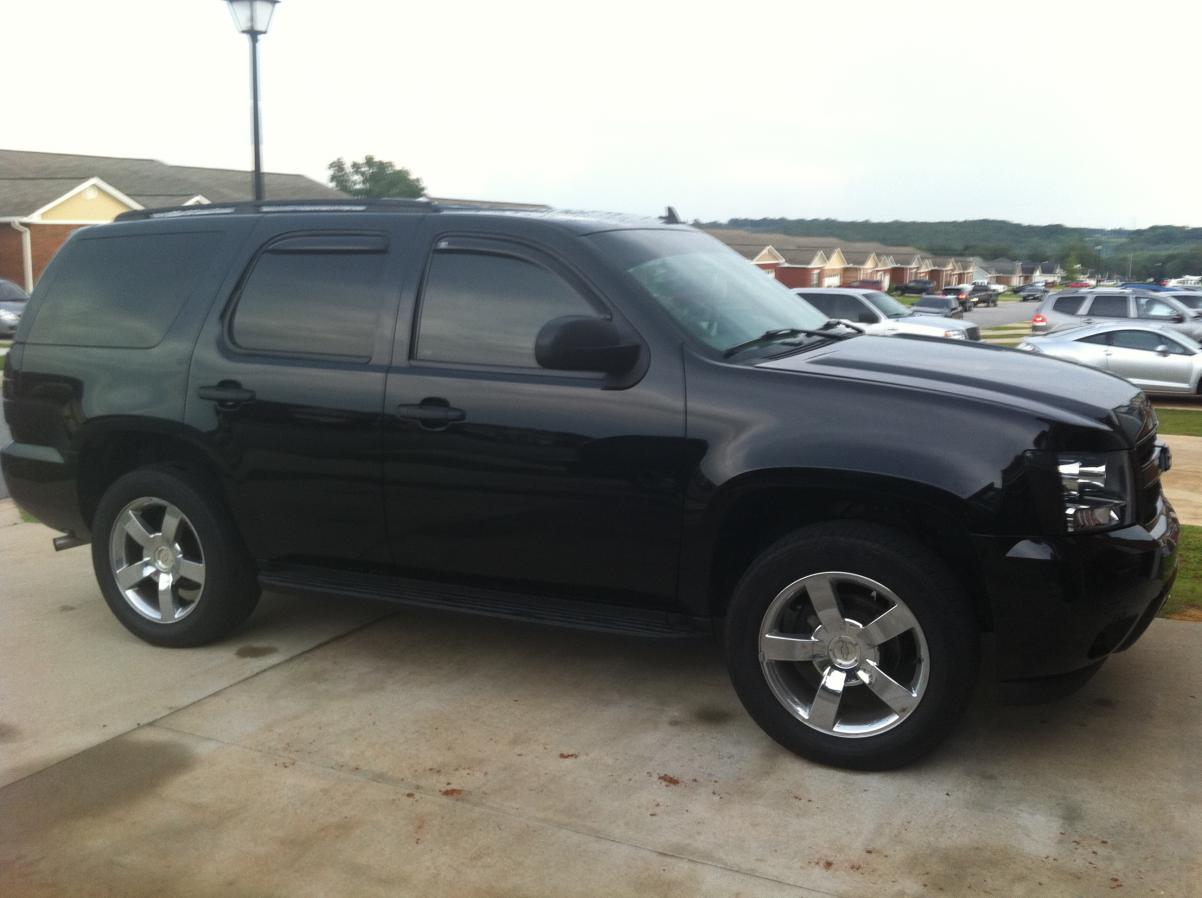

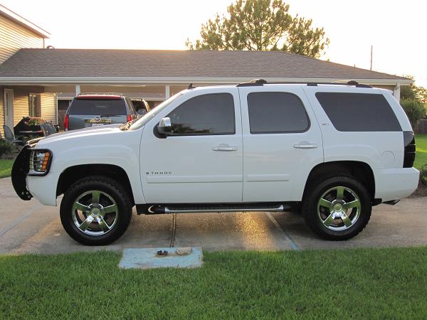

Here is my 07 Z71 with SS wheels. The first picture is them with 275/60R20 Michelin tires, and the second is the SS wheels with 305/55R 20 BFG A/T. I never have had any problem with them rubbing. They are great rims. Those tires you have should work just fine. DO you plan on leveling it any or is it leveled? As far at TPMS, I have the sensors on my Tahoe and a lot of times the dealership just resets them. When I initially put my rims on they were not working properly but I took it to the dealers and they said they just reset them. IM not to sure how that helps but thought I would help where I could.
