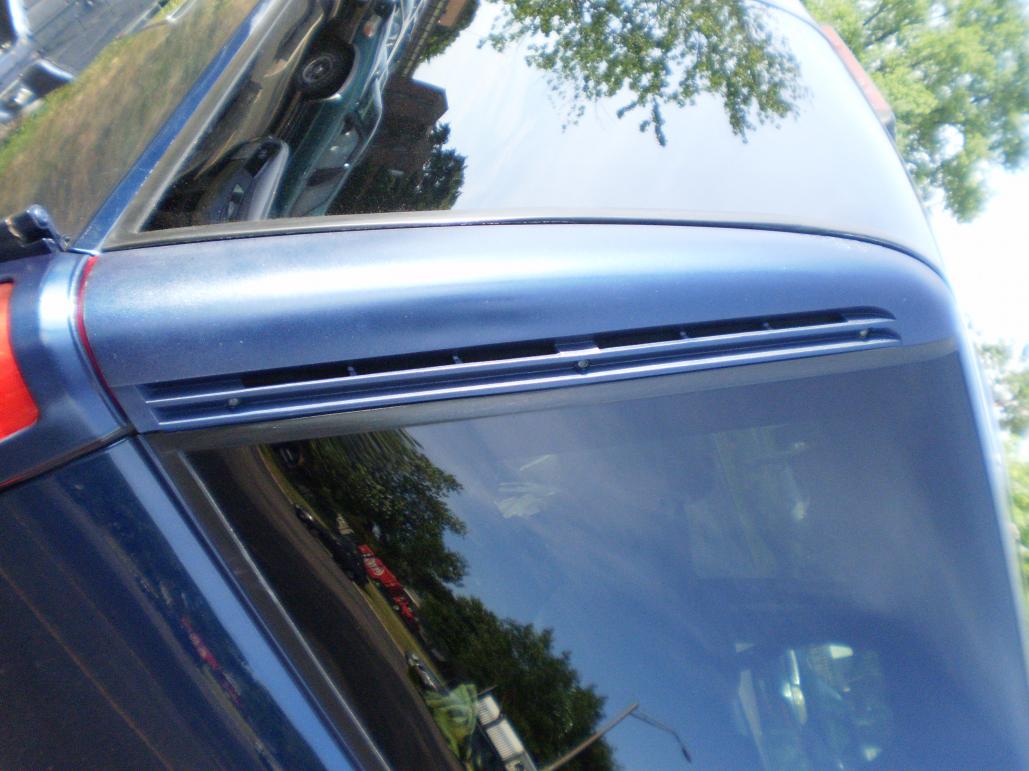

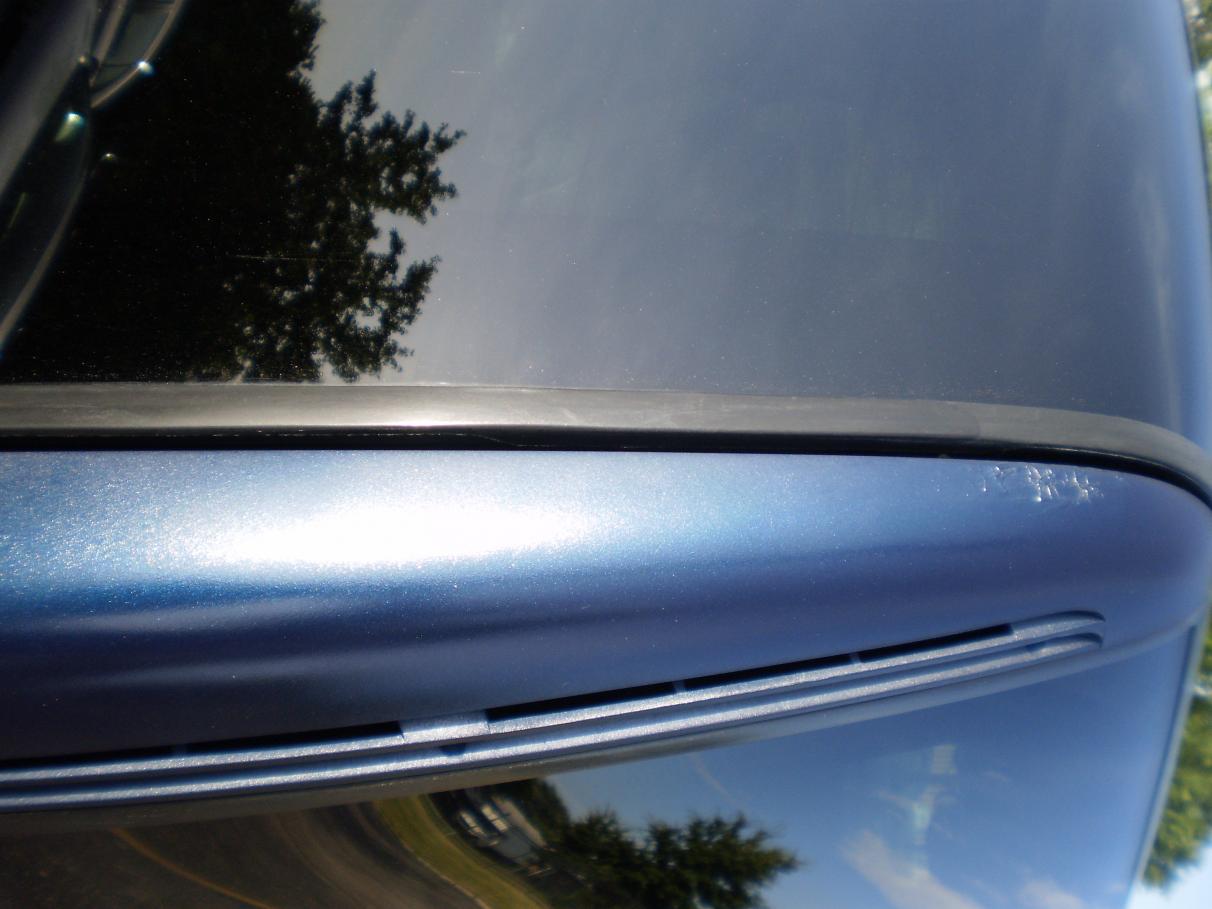

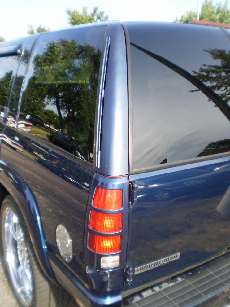

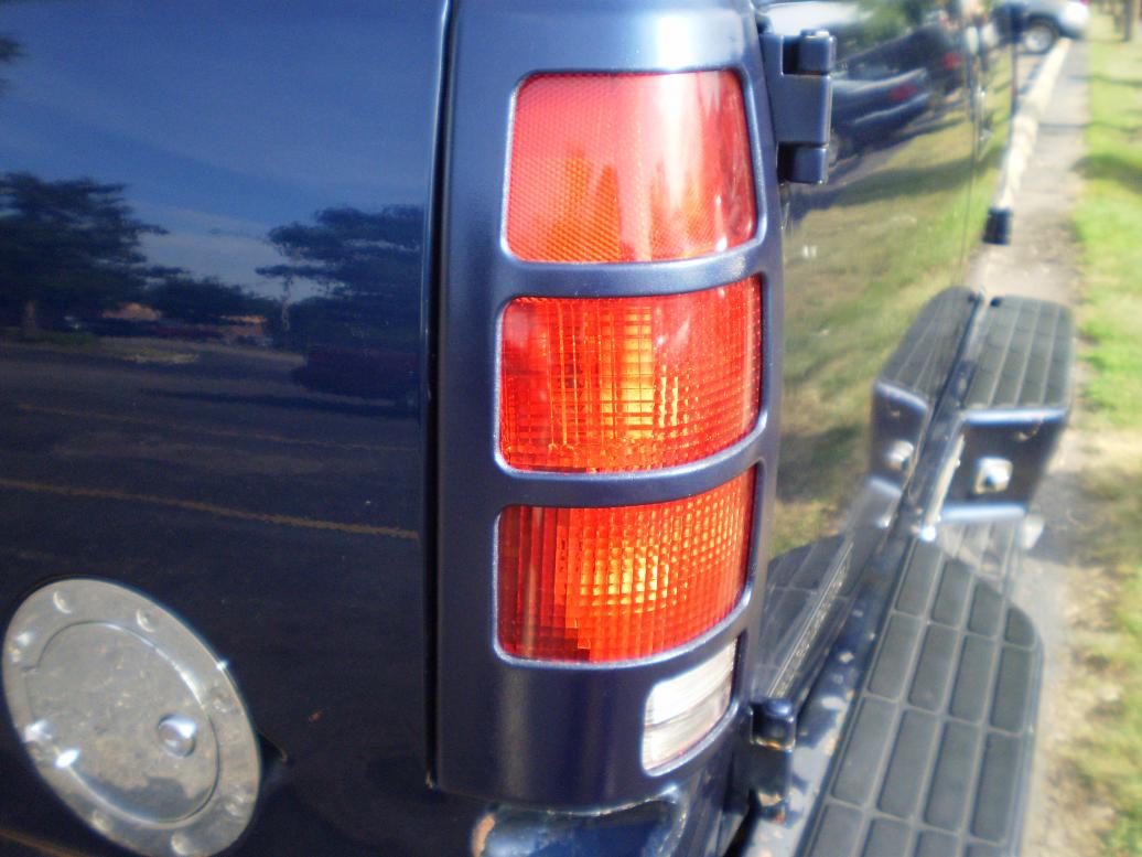

ok guys heres how it came out i think i might have to clear again and i kinda messed up on one but it looks ok for now if anyone konws any ways to inprove it let me kno didnt do the side mirrors yet wanna do them right so any insight would help i think i used the wrong kind of primer or something???

To get the gloss finish you might be looking for it will need more clear and it will gloss out like the exterior paint. Good job by the way! As for primer any basic primer should work for this application just make sure you get some adhesion promoter. It helps paint stick to plastic
