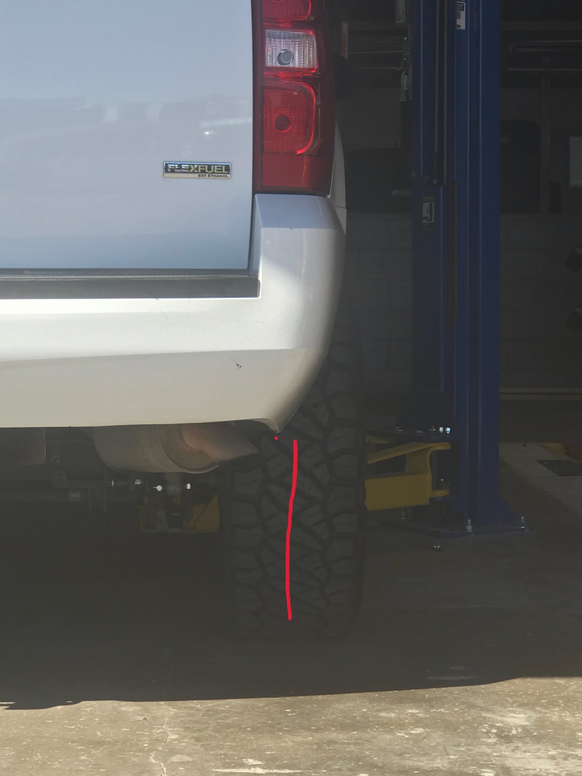

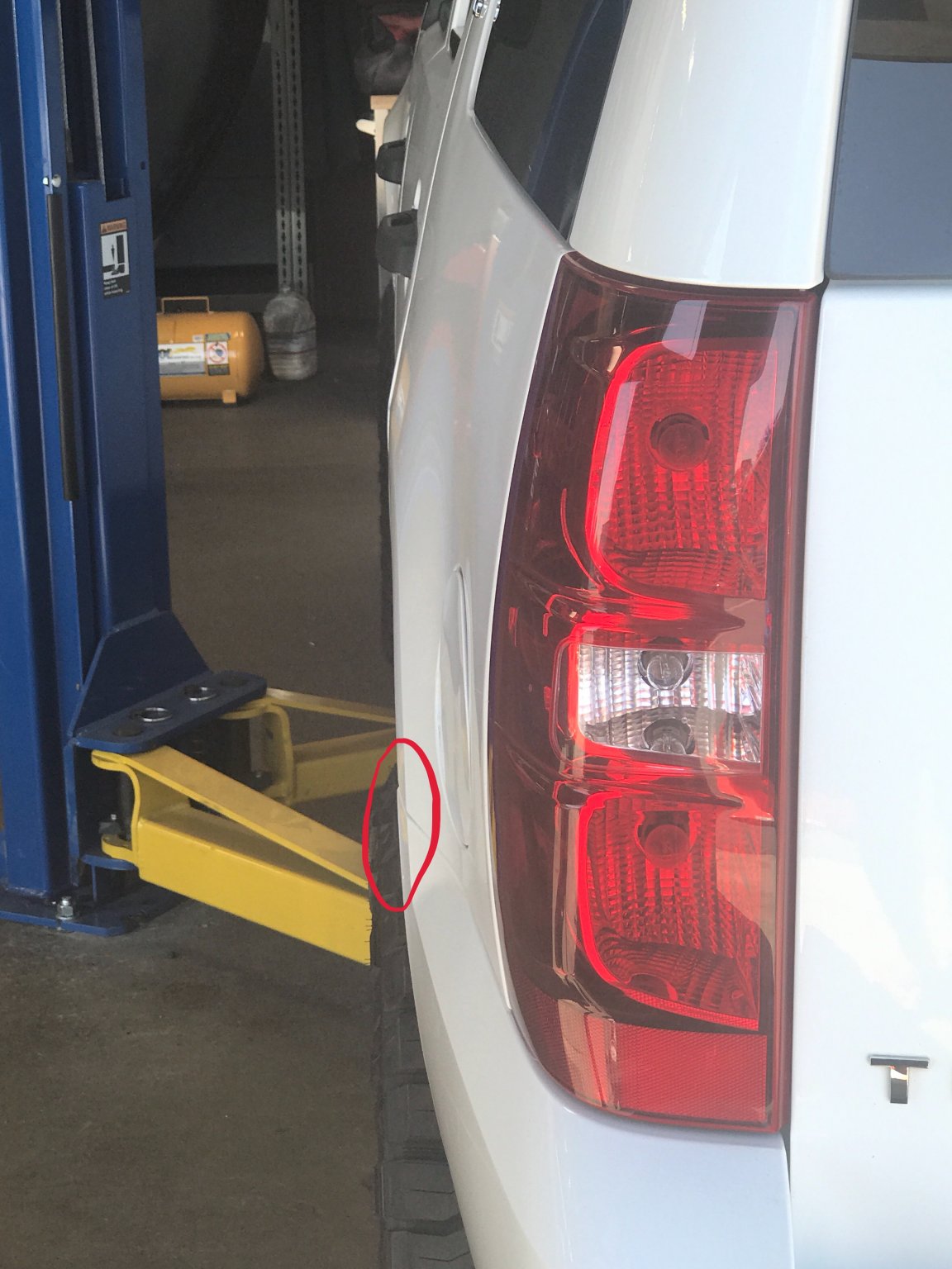

BIG POST ALERT: so I installed my 3.5 RC, 18x9 Fuel Kranks and threw on some 33x12.50 Ridge Grapplers this past weekon my 2009 SSV. Everything seems to be riding nicely, however the right rear wheel appears to be sticking out more on the right side. I spoke with rough country and they assured my that it was just the "preload" and it should correct itself within a few weeks. This is also in line with what my mechanic has told me. Anyone have experience with this? Also...now my truck is throwing a "service stabilitrac" code and the abs light is one. WTF?! any knowledge on the situation would be greatly appreciated

normal... You need a spohn panhard bar. When you raise or lower, the stock panhard bar will pull or push the vehicle to either side. So you'll need an adjustable bar to return it to the middle.

That's what I thought...but wasn't sure because of what rough country told me.
Next question: this is what started as well...

Did you stretch any of the ABS sensor wires during the install. They have connectors on the frame for the rears that may have came loose also.
Could also be that you need to adjust the tire size in your ECM/TCM programming.
How would I do that? Do I need to buy some sort of programmer or could I just take it somewhere?

Most buy a tuner like the diablosport i2 or do a blackbear tune. I'm sure a speed shop near you could set your parameters for a fee.

I'm willing to bet the sensors on your frame got unplugged.

Typical answer from parts suppliers.. he have no idea what he is selling and how suspension works, preload my a..
