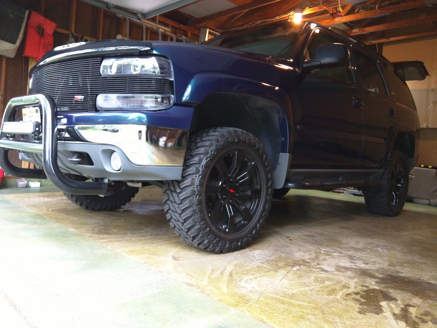

Monewill2003 - The Bermuda Blue on the rims is hurtin' feelings. Can you elaborate on how you got it to stick to chrome? Looking to paint the rims, grill, bug, bull, vents, steps, trim and rear vents to start.
