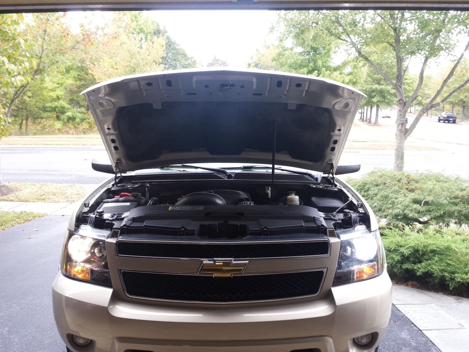

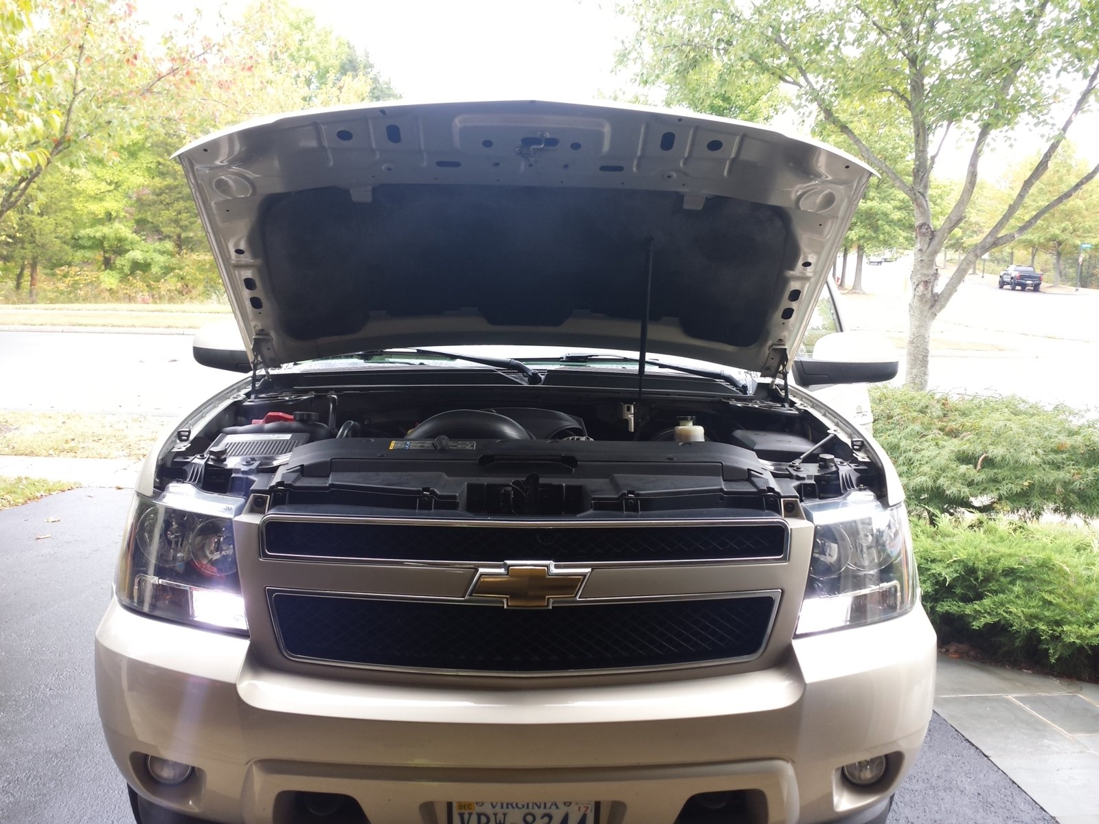

Installed LED headlight low beam and DRL bulbs.
Shot of headlights shows incandescent on passenger side and LED on driver side. Pattern on garage wall seems pretty darn sharp but it's daylight so can't be sure.

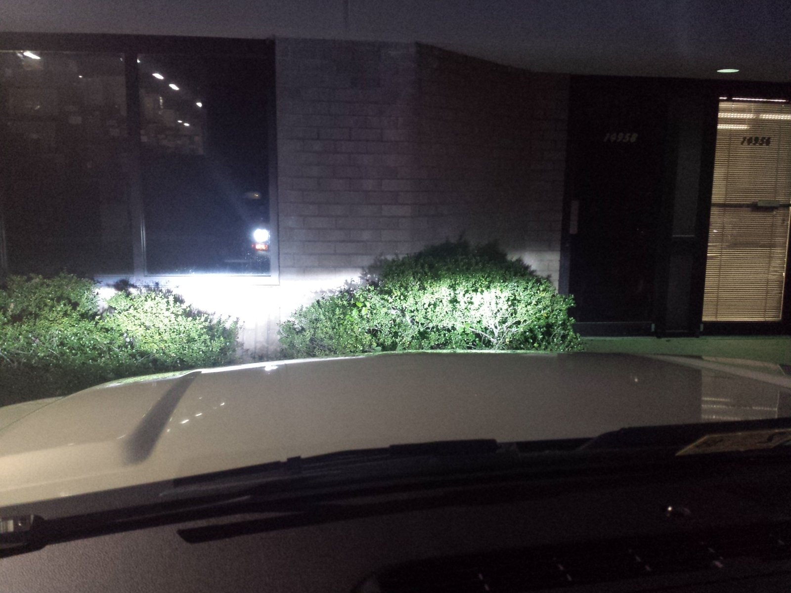

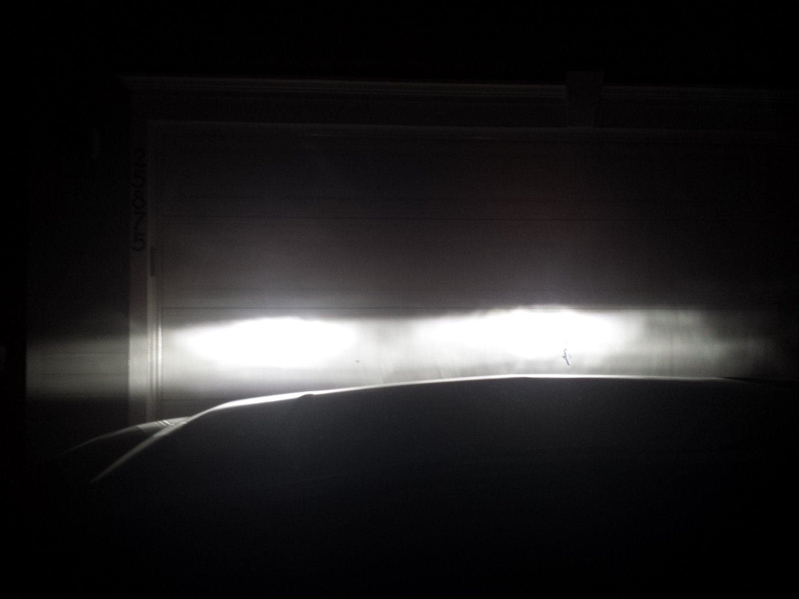

You guys know way more about this than I do, but so far I'm happy with these LEDs.
Here are two unedited images from about 7am this morning. One image shows the headlight beam pattern on my garage door from about 15 ft away (driveway slants a bit), and other image is when I parked at work. I gotta find a clear, white wall sometime....
I'm no expert on headlights or lighting technology but I like these LEDs. Beam cutoff is good, spread is good-----both significantly better than with halogen bulbs. No glare towards pedestrians or other drivers. Much longer & brighter throw.
As good as HID? No. Better than halogen bulbs? Yes, and are 100% plug-n-play.
I know there are projector retrofit kits out there for around $1K, but I'm not spending that on headlights when I can get maybe 80% (??) of that performance for under $150 simply by adding good-quality LED bulbs with integrated drivers. Simple, easy, and not expensive.
