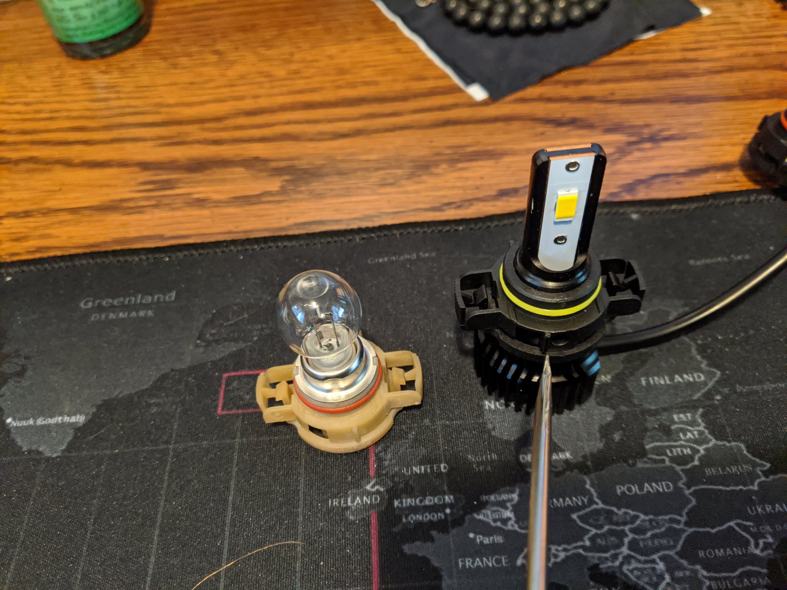

First lesson I learned is that LED bulb size 5202 is sold universally as ps24w, psx24... shoot, even the stock halogen I pulled out says ps24wff on it. Bought 3 different sets from different sources the other night and the 3rd set arrived today and each set is psx24 size.
Comparing the bulb surround between the LED and stock halogen; it's evident a guy can remove the vertical tab and get'er da go without leaking, but as a cautionary - you'll want to be aware of the idiots that sell these. Here's a photo of the tab i'm going to remove and test:
