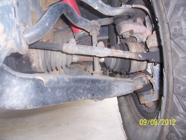

Have the torsion bars been cranked up at all? could you get a picture of the front end so I can see the cv shaft angles? also is there a block out back?

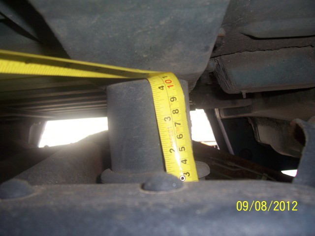

I will post other pic in a sec. I just guessed it was a 4" BL I measured the cyclinders that hold it up and they are a little over 4 inches thats why I thought it was a 4" bl. I dont know anything about domestic cars. thanks for your help.

pic in order front drive shaft angle-rear driver side two lift cylinder-measurement of rear lift cyliner-measurement of front lift cylinder from bumper hole

I believe and someone please correct me if I am wrong, just the block is 3" but looks as if they left the stock body mount on there also so making it a 4" bl. Again bowtie would know better. I am new to the IFS stuff as I have had lifted ford trucks (f250-350) no IFS.

I've never body lifted anything but that looks like a stacked lift on top of the stock mounts. Can some one confirm this for me?
I just checked my truck and that's what tell me that is stacked. if it is it is not safe but again lets get confirmation.
