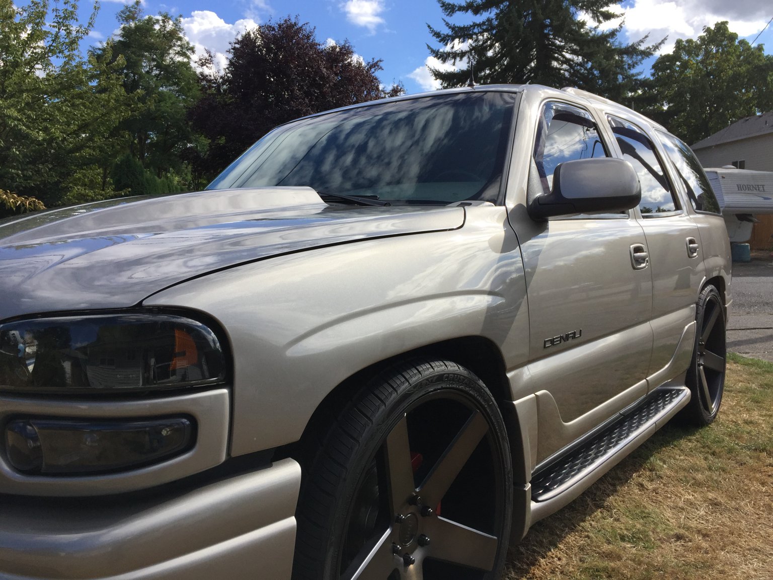

I tow a pretty heavy trailer with mine and the Autoride let's me do that and still ride lowered on 26's. I love the fact that my rear wheel clearance doesn't change when I hook up the trailer and load it up.

I used 2" drop rear springs and shortened the ride height sensors in the back , used 2" drop front spindles so nothing changed as far as ride or geometry, then beefed up the sway bars and end links and used poly bushings on them. It now handles amazing, especially for a huge SUV. Flat on corners, flat during hard braking. You can see more in my build thread if you'd like.

I learned just about all I know about my rig here on this forum. I read they might rub on big wheels so I took a look and saw they had indeed rubbed a tiny bit, probably on real hard cornering.

I thought I explained that- if you're starting the engine and the headlights are already turned on via the auto headlamps, I feel the voltage drop damages the ballasts, as they're trying to fire up when the voltage is low. I do know that once I disabled that, no more ballasts have burned out in 18 months or so. Previously, 3 ballasts in a couple months.
