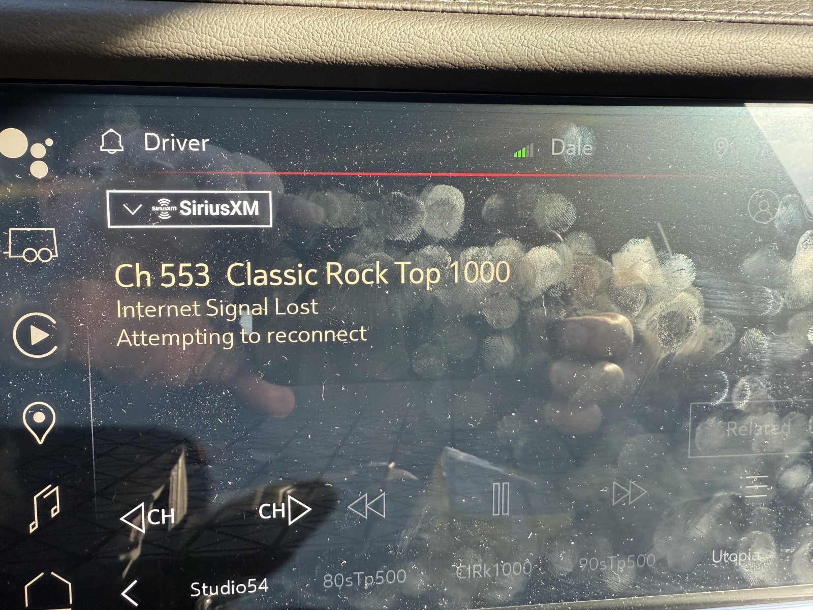

Local dealer did the recall updates to the wife’s 23 Yukon. I noticed a few intermittent issues.
The XMRadio will display the channel, there isn’t any audio, has “Internet Signal Lost”, “Attempting to reconnect”. It has done this twice, unobstructed view of the sky.
The other issue, intermittent issues with audio. Start the Yukon, no volume from Infotainment, it will show the audio volume bar, increase it all you want, no audio. If you go to any other preselect station, the second the tuner finds the channel, audio comes on, audio stays on when you switch back to the preset that previously had non audio.
Anyone else have this issue? Pardon the fingerprints.

Actually, Channel above about 220 are not Satellite channels, those are part of the 360L service and get streaming data via the Cell Data signal. So internet lost may be indicative of a poor cellular data connection in that area.
As for your other issues, this infotainment system is full of bugs. Audio Dropout for about 1s is common, there is even a dealer communication saying GM is working on the problem. It has been there since I first got mine in Feb of 2022.
