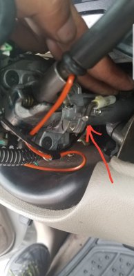

I had a similar issue when thieves did the same except they jammed a screwdriver into the cylinder and tried to turn it. You have to get that cylinder to turn or else it won’t come out, check out YouTube videos on the cylinder removal. I’m thinking the shift interlock isn’t working since they broke the shifter. There might be something broken in the shift mechanism.

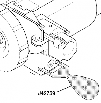

Ignition Switch Replacement
  • Tools Required
  • J 42759 Ignition Switch Connector Release Tool
Removal Procedure
  1. Disconnect the negative battery cable. Refer to Battery Negative Cable Disconnect/Connect Procedure.
  2. Caution: Refer to SIR Caution in Service Precautions.
Disable the SIR system.
  1. Remove the hush and knee bolster.
  2. Remove the steering column trim covers.
  3. With the key installed, turn the key to the RUN position.
  4. Install an allen wrench into the hole on top of the lock cylinder housing. Push down on the allen wrench to release the tab on the lock cylinder inside the lock cylinder housing.
  5. Slide the lock cylinder out of the lock cylinder housing.
  6. Disconnect the PASSLOCK and key buzzer from the lock cylinder housing.
  7. Insert J 42759 into the lock cylinder housing to release the tabs on the ignition switch.
  8. Pull the ignition switch out of the lock cylinder housing.
  9. Disconnect the connector from the ignition switch.
  • Tools Required
Removal Procedure
My problem after the thieves messed up the cylinder was I couldn’t get it to turn at first so I couldn’t get it in the run position so I couldn’t remove it to replace. I finally used a big ass pair of Vice Grips and got it to go. The tumblers were all messed up so even with the key in, it wouldn’t turn without a lot of force. I figured I didn’t have anything to lose because the only other way was to replace the column. Just glad I got it.

Ok issue has been fixed temporarily.
As some of you suggested the shift interlock was bent and prevented the key from turning.
Thank you for all the help and replies
