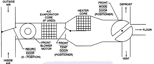

Howdy - My '96 four-door Tahoe (258K) is starting to torture me with small but hard-to-diagnose problems. Case in point - the heater not longer heats, and the defroster setting only blows air if the temperature control dial is centered or on cold.
More details: the heat just went away between one drive and the next. All three of the control dials (fan, temp and mode) appear to work; at least, the fan goes through all speeds, the vacuum-powered heater water valve in the engine compartment actuates, the air goes from coming out the floor vents to the dash vents to the defroster vent (more on this in a moment). *But*, there's no hot air anywhere! So maybe the heater core suddenly got blocked (unlikely but possible)...but also, the air will come out of the defrost vents only if the temp dial is *not* turned to hot. If I turn the temp control back to the middle position or colder, the air starts coming out of the defrost vents again.
There's a gif file attached from the AllData site that shows the HVAC ventalation system. I'm too tired to go on any more right now - I've got carpal tunnel surgery in the early morning. Any and all theories are welcome. Thanks so much for your collective help!

get under the dash on the drivers side look up laying on your back to the cienter of the dash there is a little black box with some levers attached. that is the blend door actuator. the default setting for the actuator is to blow from the dash. these things can stick move the arms with your hands. my 97 silverado needed a new actuator but my 97 tahoe just need a slight nudge they were stuck from sitting without being used and now they work fine..
