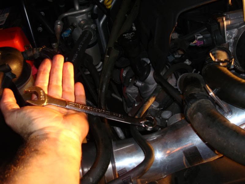

you have to hook a 15mm box end wrench on the top tensioner, then hook another box end over the open end, to get enough leverage sometimes.

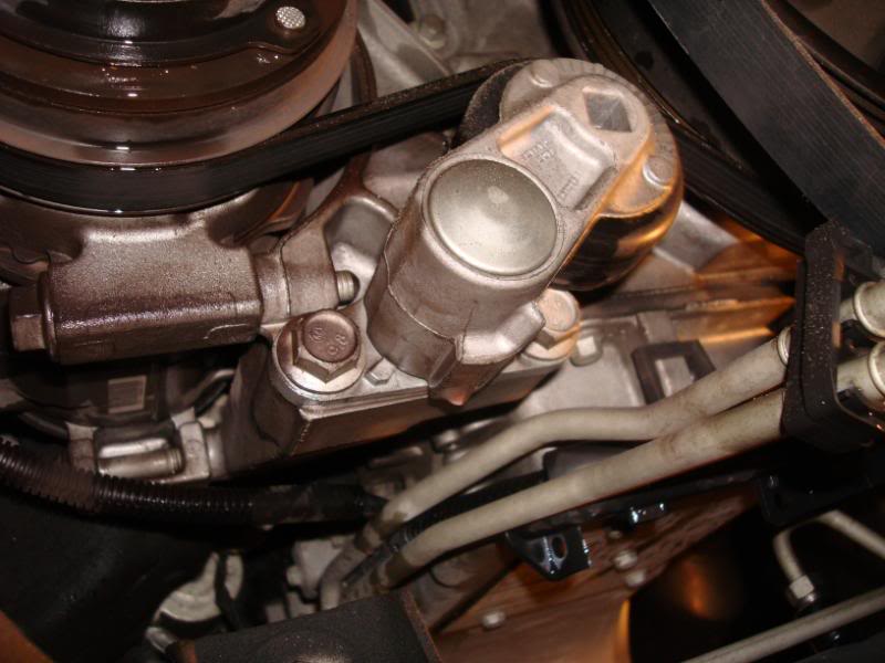

FWIW, you should throw on new belts (or at LEAST an AC belt, since you have to take so much off)
you have to take off the main belt to take off the AC belt,
and you have to take off the skid plate / splash guard (4 15mm bolts)
and you have to stick a ratchet in there, and release the tension on the AC tensioner, so the arm will move up, so you can access the bolt head.
belt on, bolt blocked:
belt off, access:
