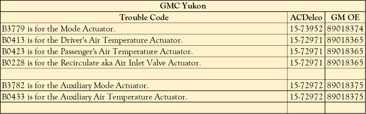

Pulling the dash to replace the heater core or evaporator or some internal HVAC doors is not a big job to a man that does it often.
If you have a bi-directional scan tool that can read BCM codes, you first use that to ensure that all the relevant actuators are working properly and test them.
Then you want to do as Wes mentioned and make sure the heater core is making heat.
If you have to replace the Recirc or passenger side air temperature actuators, see my post where I explained how to do it and what tools are needed.
Posts: 1,174 and 1,186 Here: https://www.tahoeyukonforum.com/threads/useless-information.97483/page-118
