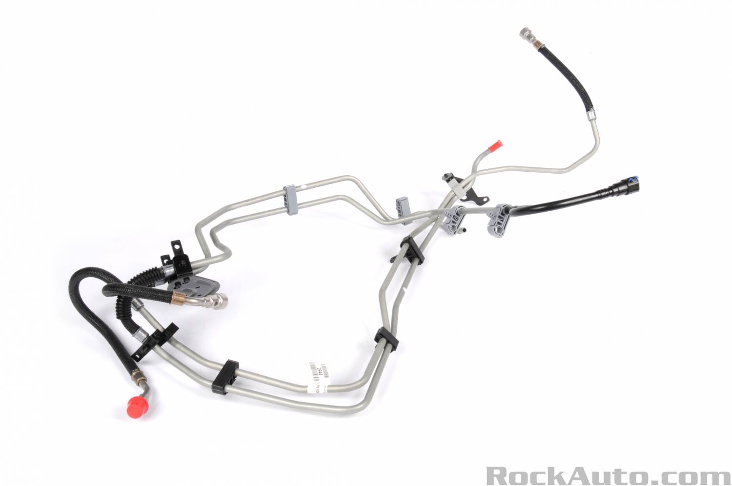

My mechanic told me that my fuel lines are done and I need to replace them. Supply / Vapor / Return from the top of the fuel pump.
He said from the dealer it's $230. I'm looking online for a better deal, but I can't find anything that says those 3 key words in the description.
Is this what I need? http://www.ebay.com/itm/Fuel-Line-Set-ACDelco-GM-Original-Equipment-15872644-/162098147055?fits=Year:2005|Model:Yukon+XL+2500&hash=item25bdcd6eef:g:gUIAAOSwRQlXgFPW&vxp=mtr
Or is there a better / cheaper option?
Thanks guys.
Edit - forgot to mention it's an '05 Yukon.

That set is for an XL2500 only- look at the application. You didn't specify other than an 05 Yukon. There is a difference it looks like between the regular and XL, and also between different engine sizes. Go to www.rockauto.com and look it up. Also FYI there is a supply line and a return/vapor line, not 3 lines. Also looks like by the time you pay shipping, $230 is about right for OEM. You can get the OEM p/n from the dealer and shop online also. Are you going to install it yourself?

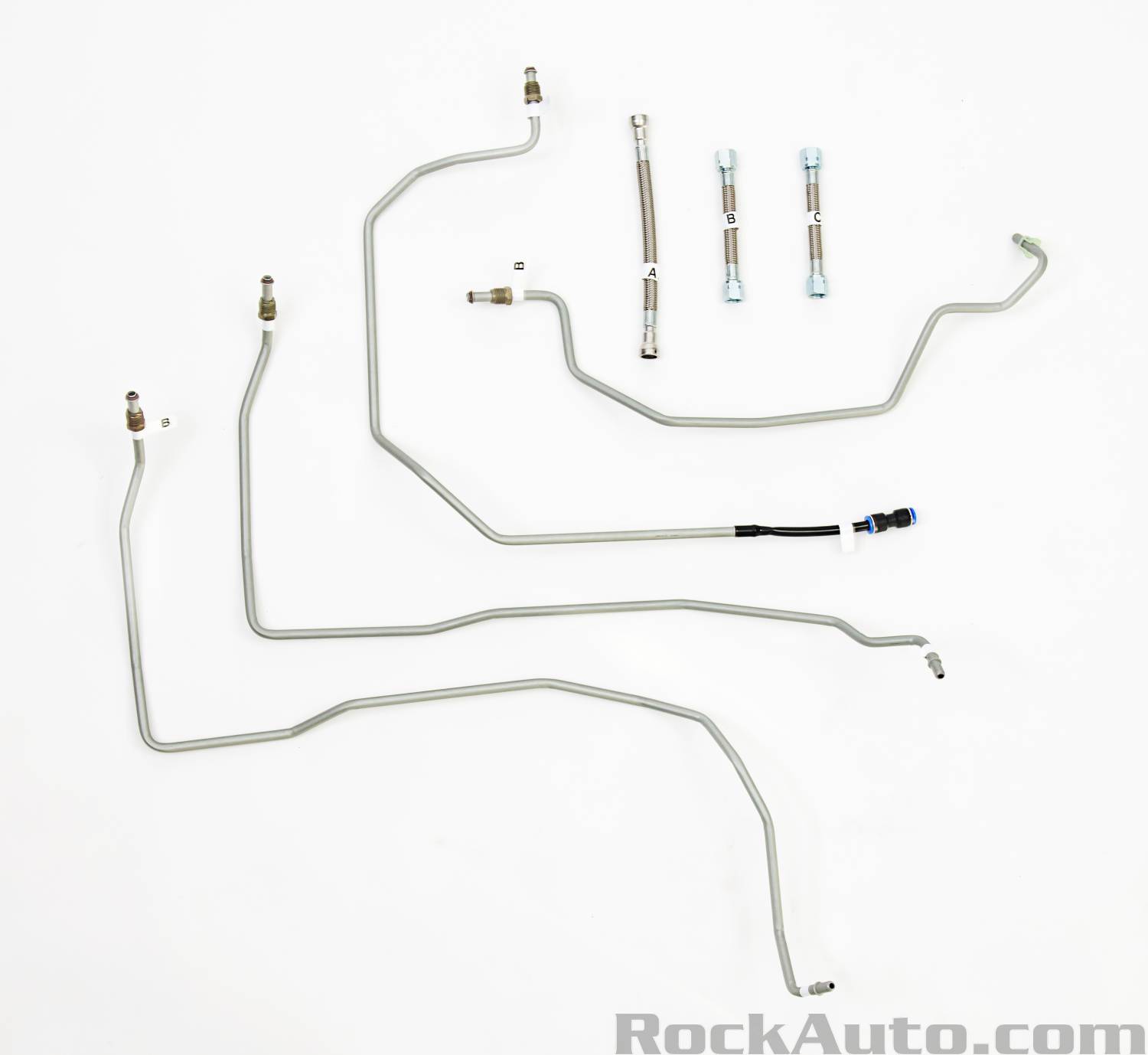

The rockauto one confuses me. This is the only fuel line option they have on there...
....This is why I'm confused.

Did you read the description? BTW you still haven't told us exactly which 2005 Yukon you have, or whether you're planning on installing it yourself. Youre making it hard to help you. Here's the description of what I believe you're looking at. Yes, just a picture alone can be confusing if you don't read the description.
"FINELINE FL149E
Complete Set
Engine to Hose Connection off Fuel Tank; 1 supply line 3/8" ( in 2 easy to install sections), 1 vapor line 3/8" ( in 2 easy to install sections), hose to engine connection, hoses to join rear and front section, nylon line with union."
Looks like they're trying to make it easier to install since OEM lines might be difficult to route. Also, I assume you know the gas tank needs to be dropped in order to replace the lines?

So my mechanic told me that these 2 are WRONG
He says what I'm looking for is not metal, but plastic. Any ideas guys?
