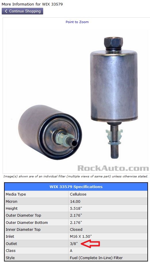

Does anyone know the size of the fuel line. I think it is called the feed line . The one that connects to the fuel filter via quick connect.
