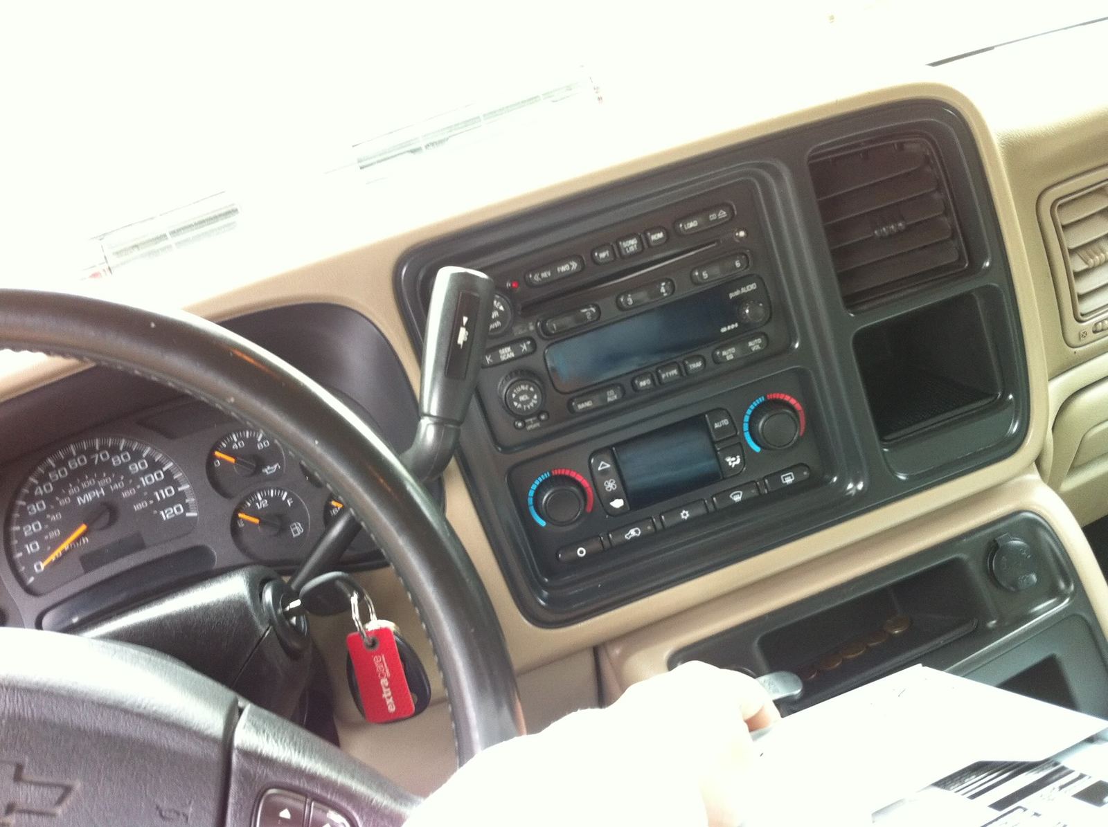

here now im going to show my new installed headunit and i might as well put alil how to

step 1
A-put the parking brake all the way in and keep pressing the brake
B-shift to the last gear so the shifter is not in the way
C-put steering wheel all the way to the bottom
the dash bezel is not held with any screws or nuts.. it has simply clips... so with your hands pull the dash bezel off the dash and it will come right off.. the best way for me to take it out is to pull it from the air vents or from the cluster on the top..
after u take the dash bezel make sure you put the shifter in park
