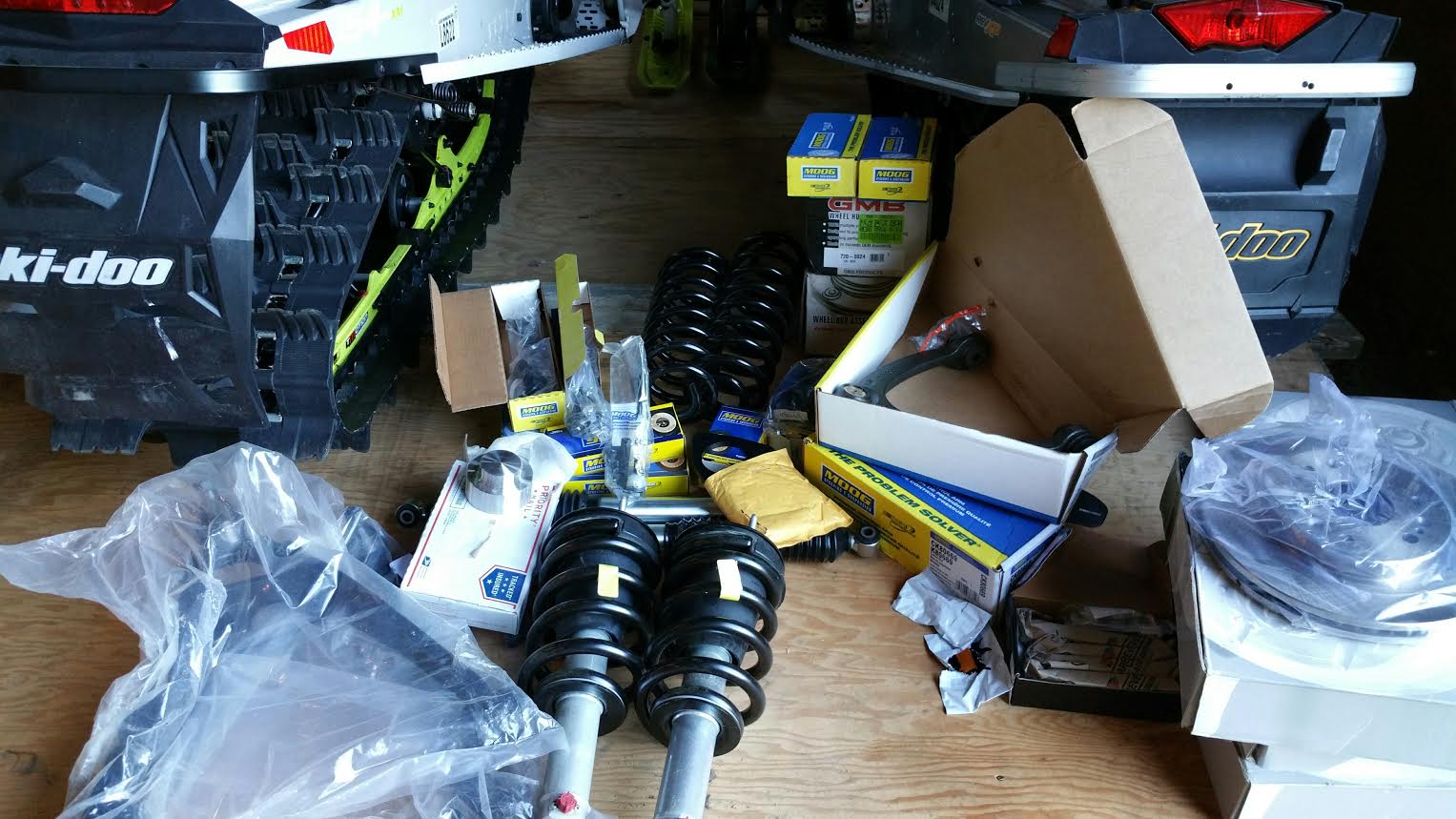

I forgot all about this thread but thought I would update and let you all know of the adventures of this job.
Started out good got everything apart and started on ball joints. After shaving off the lip and beating the ball join out and using the ball joint press I was able to replace both lower ball joints. Being the first time doing these it took me a good 2.5 hours on the driver side to complete the whole rebuild and about an 1.5 hours on the pass side. (balls joint, UCAs, struts, sway bar end links)

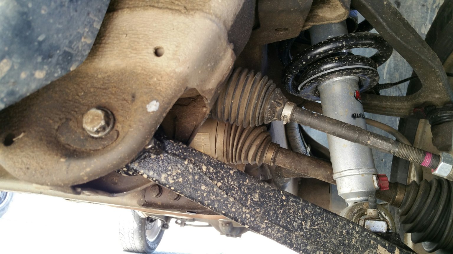

This was the first attempt at setting the height for the adjustable struts, don't mind the rubber bushing I replaced it the next day. I initially went with the 3rd notch on the strut and was way to high. My UCAs were touching the bump stops. So I had to park for the night and remove the struts again and placed the ring on the 2nd notch which is the finished product of this whole ordeal.
This is with the struts on the 3rd notch with a 2 inch spacer on top of the struts. Doing the math 2" spacer plus the supposed 1.75" (3rd notch) I was hoping that after I drove around for a bit it would settle to a 3.5" lift up front, not the case. With the UCAs touching the bump stop while sitting I did not feel comfortable driving it like that. So right after this test drive I parked for the night and tore apart again the next day, to set to a lower notch.

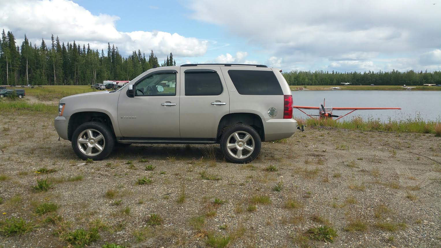

Finally the end product. It sits just a tad bit higher up front than the rear and will correct this in the near future but as you can see its cold and I don't do good in the cold. Eventually I will get around to raising the rear, replacing rear shocks add extenders and call it good till I full suspension lift.
