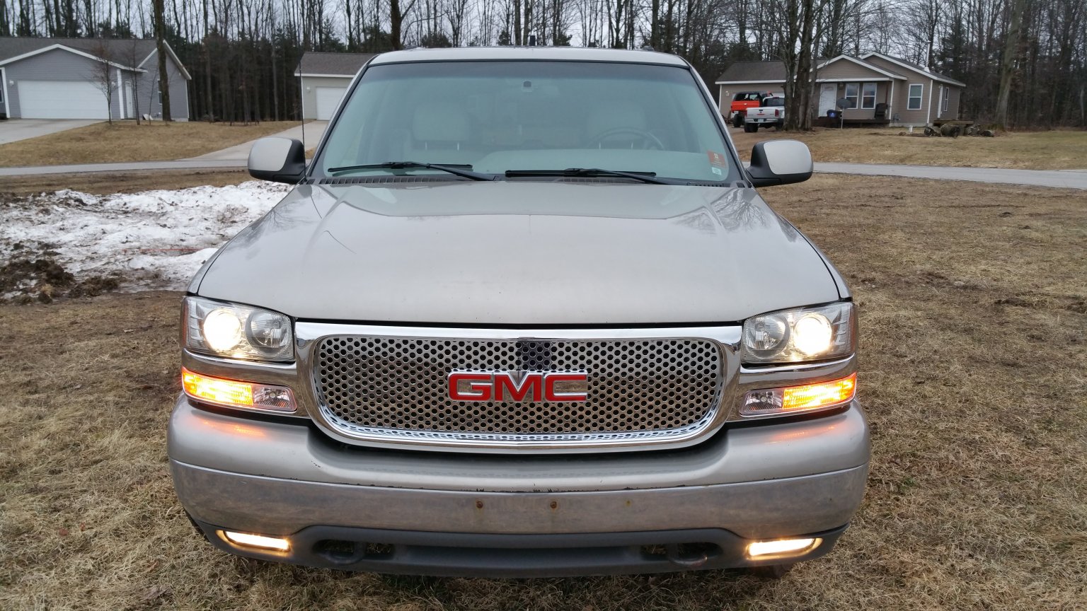

This is my 2000 Yukon XL, it has the dip:
The Yukon Denali (And the C3 Sierra) has a gentle dip:

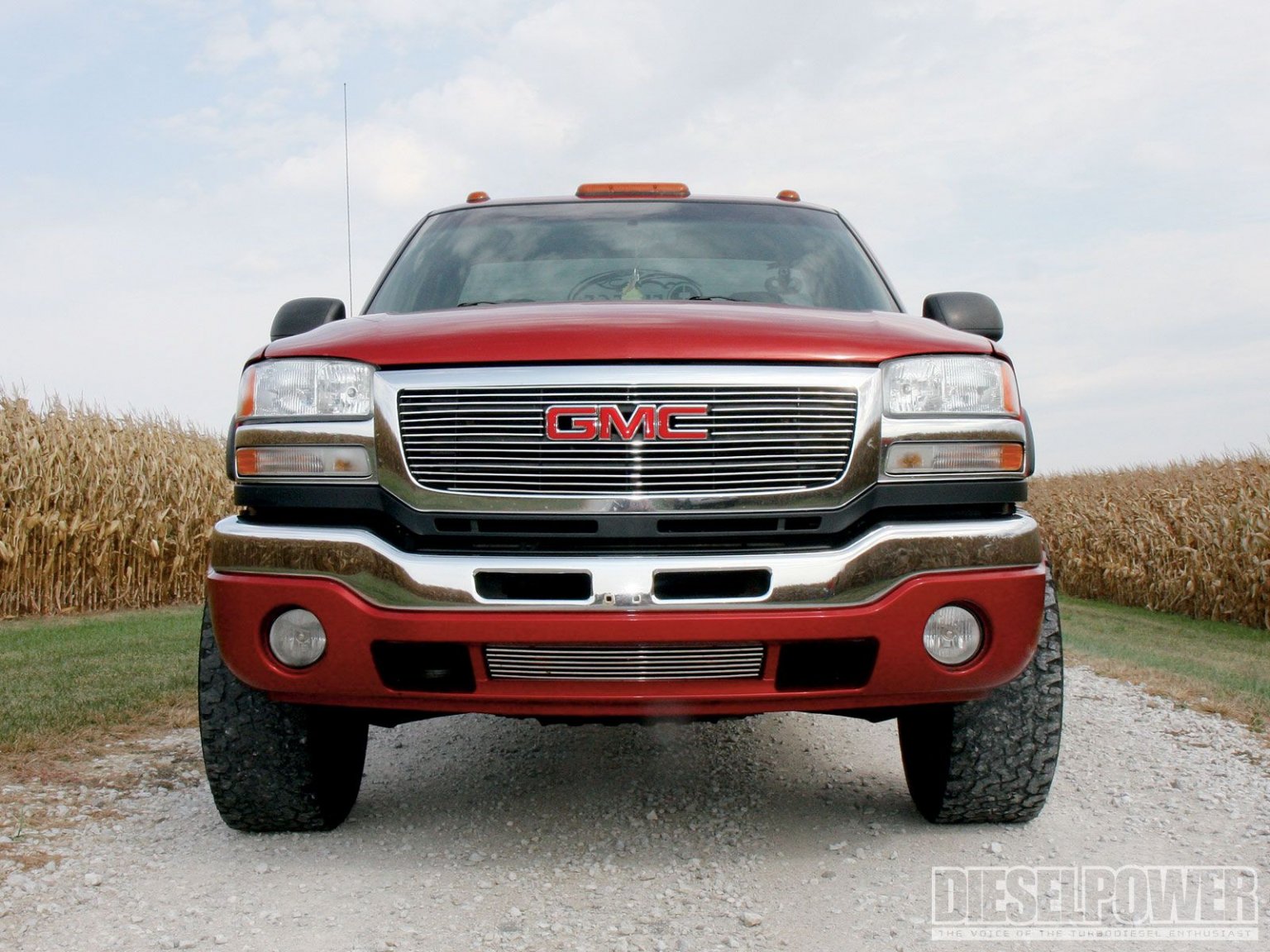

Here is an '03 Silverado HD:
And an '03 Sierra HD:

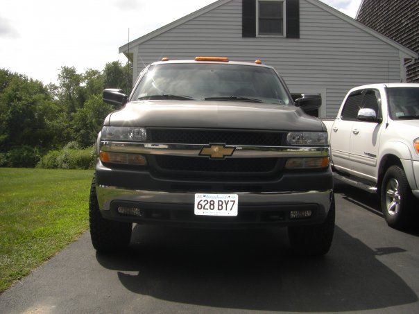

And here is an '01 Sierra HD:
This is the '01 Silverado HD:
It looks like the '02 and before GMC and Chevy trucks shared the same bumper, but after '02 they don't.
If you are talking about your 2005 Tahoe, I think whatever HD grille you pick will require an entirely new bumper.
The HD bumpers tend to include vent holes in them from what I can tell, and I'm not sure about the actual metal bumper would match up with the cap.
I think from the looks of things, the 2005 Tahoe bumper might be most like the '99-02 GMC bumper, but I'm not sure about where the cap clips to the bumper.
If you could give us some more information on what truck you are starting with and where you want to end up, that would be very helpful :D

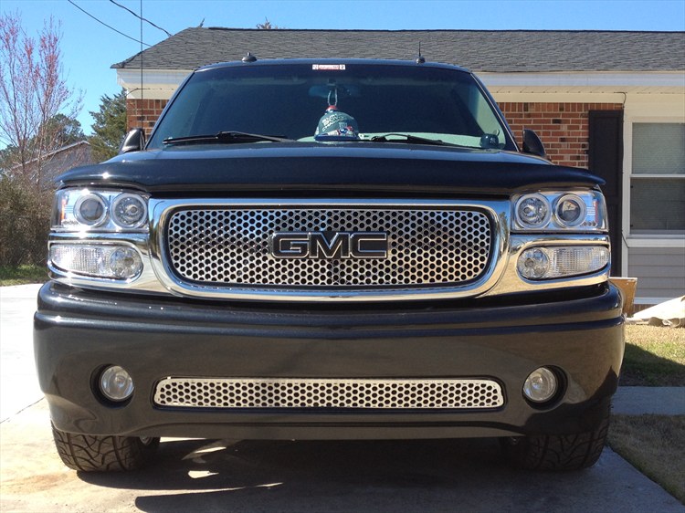

I want that lower valence grill on that black Denali

I have a 05 tahoe with a stock bumper. I was hoping to source some parts from the junkyard. I like the Yukon front bumper with the dip. It was nice to see a pic of the hd grill on the tahoe with the HD GMC bumper. I may prefer the std GMC bumper with the HD grill. I was also wondering if the later (03-on) silverado bumper cap combo would work. It also has the dip in it. I assume I will have to re-mount whichever bumper there is, so I guess it just depends on the size and shape of the dip in the bumper. If the 03-on silverado would work, you could also get away with the "SS" bumper cap that would also have the dip in it. Maybe the sides of the bumper are too long on the 03-on silverado as the grill/headlights does not wrap the sides as much as a 05 tahoe?
