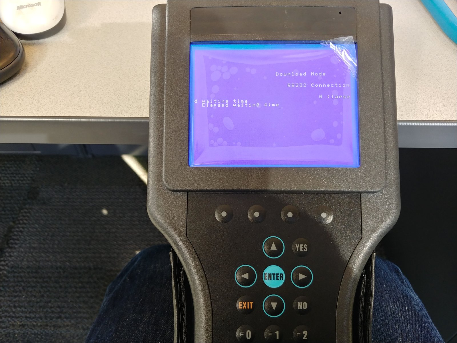

Hi Mark,
When I put mine into the bottom slot and powered up the Tech 2, it went into what looks like a software download mode waiting for a connection from a PC. I figured “future use” may have also included card programming, but if yours works in the bottom slot I hope I didn’t get shipped a blank card.

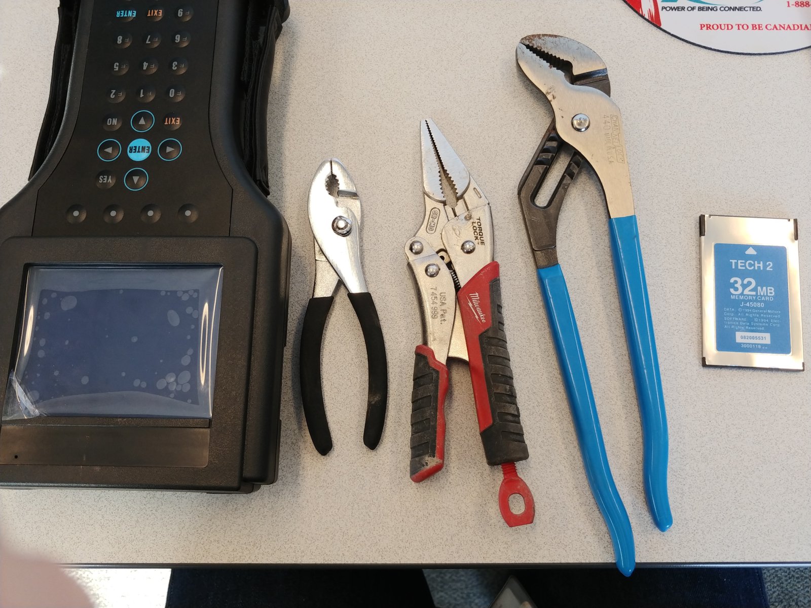

I asked the seller if I had his permission to try and modify the door without impacting my ability to return the item, and he gave me his blessing. So I brought my Tech 2 and a variety of pliers to work and will play at lunchtime to try and cram it into the top slot one way or another! :893Chainsaw-Smilie-

Hi Mark,

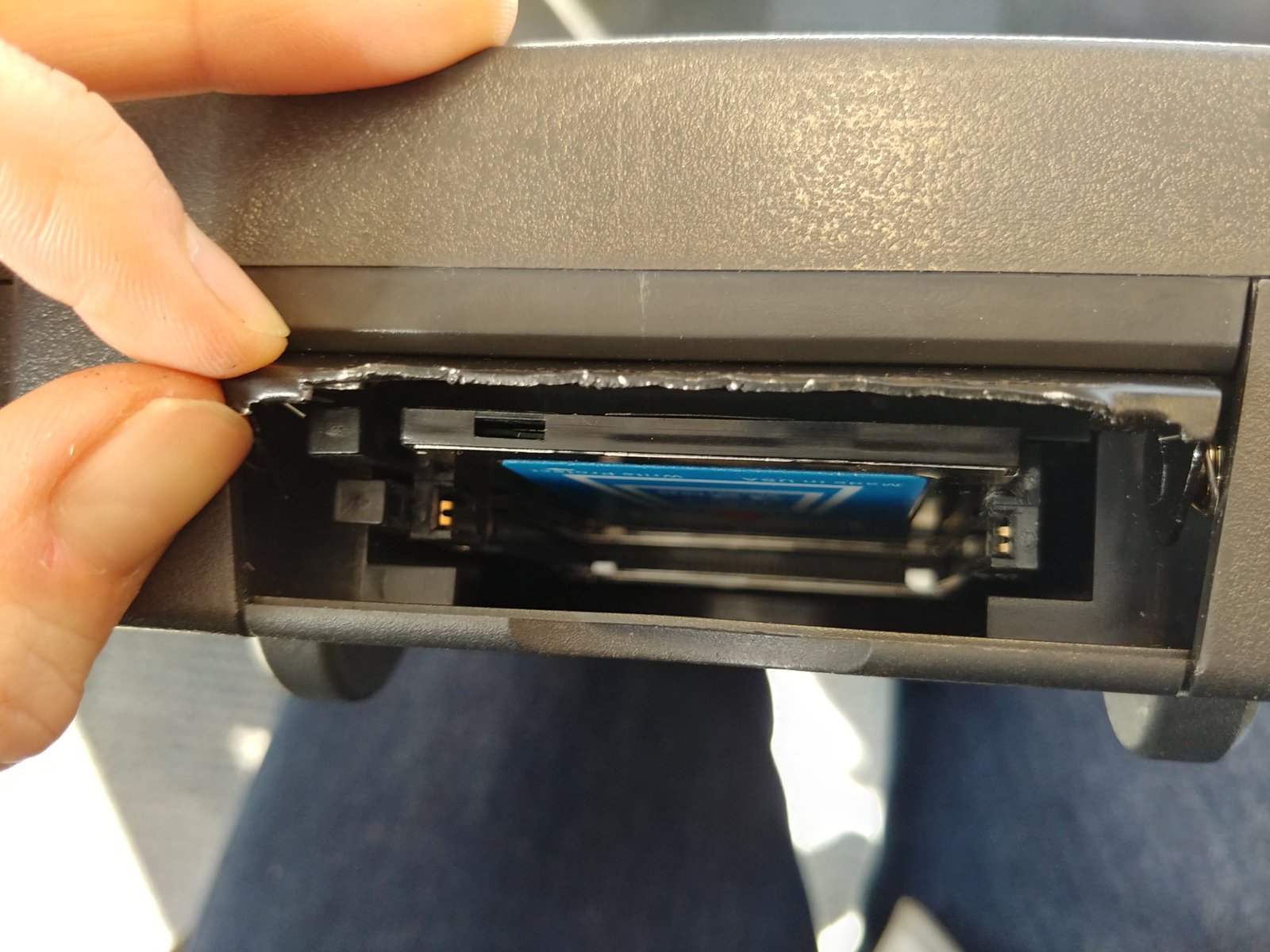

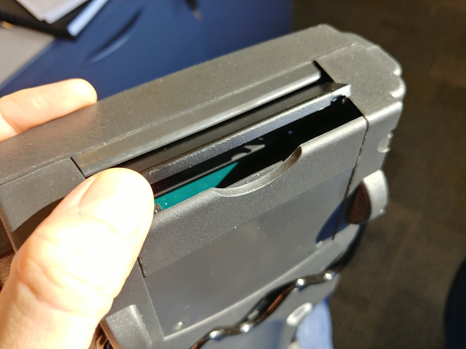

Before:
That opening is WAY too small:
Nurse, scalpel please:
Not the cleanest job, but I can tidy this up easily enough:
PCMCIA card fits in like a glove now:
Oh, I’m so excited!!!:
What?!? :Angry::

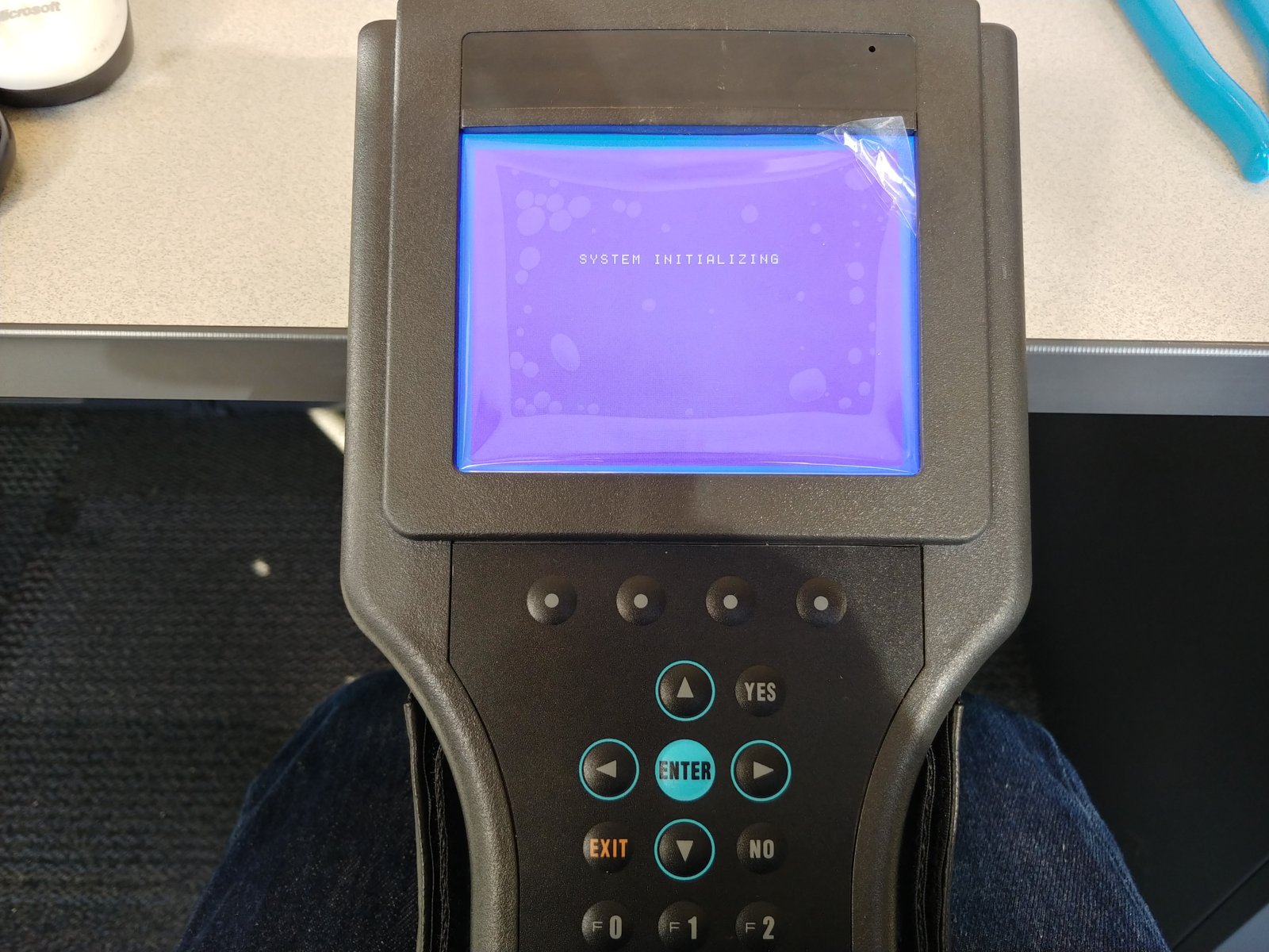

Has anybody seen this before? Is my card blank after all? Sigh, I hope I don’t have to wait another two weeks for a replacement card from China.
The saga continues...

And to make matters worse, the pictures aren’t even showing up LOL
Trying again using “Upload a File” instead of dragging and dropping the images inline with the text (which looked like it was going to work just fine while composing the message). Let’s try this again! :D
Before:
What?!? :Angry::

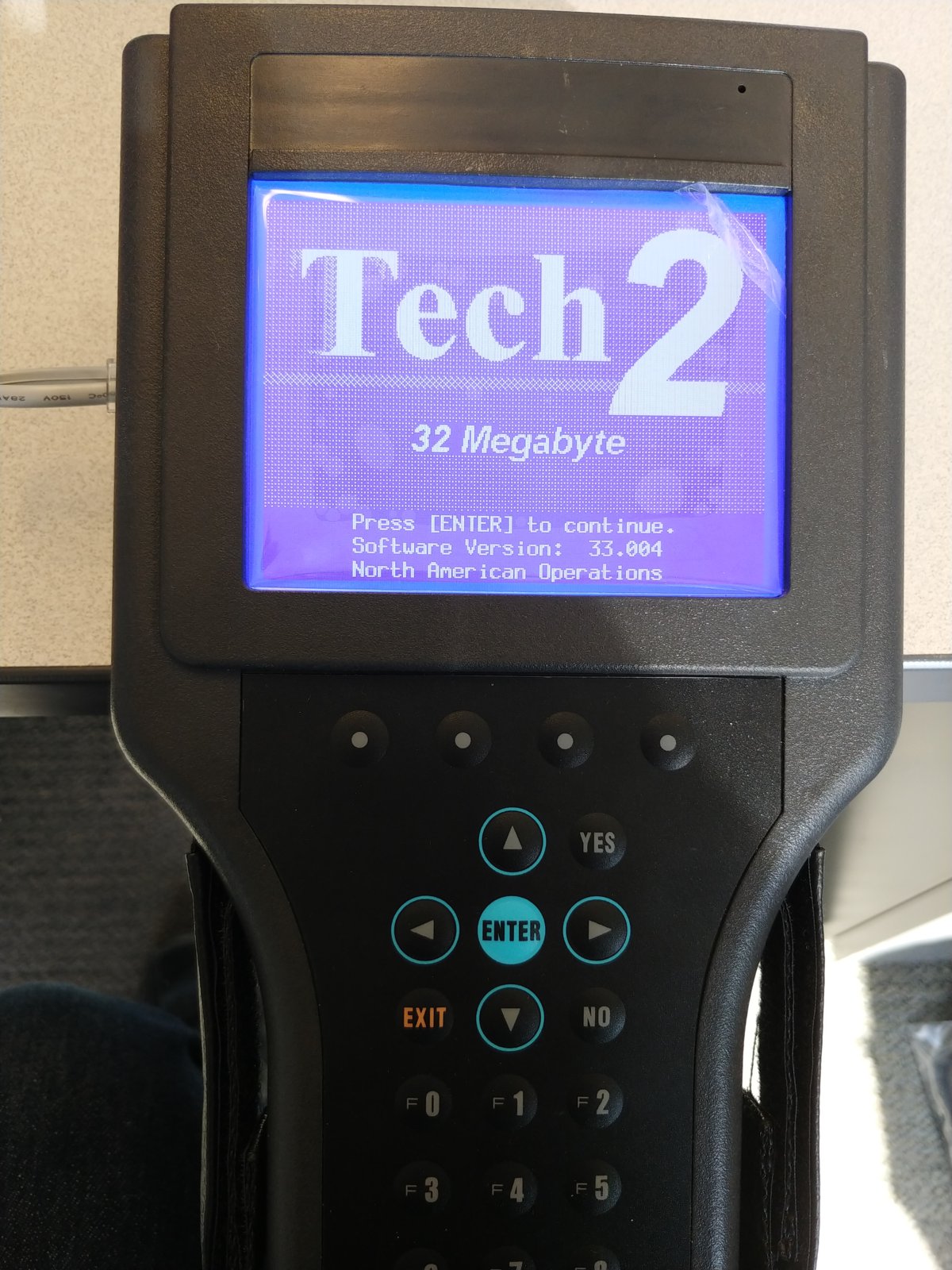

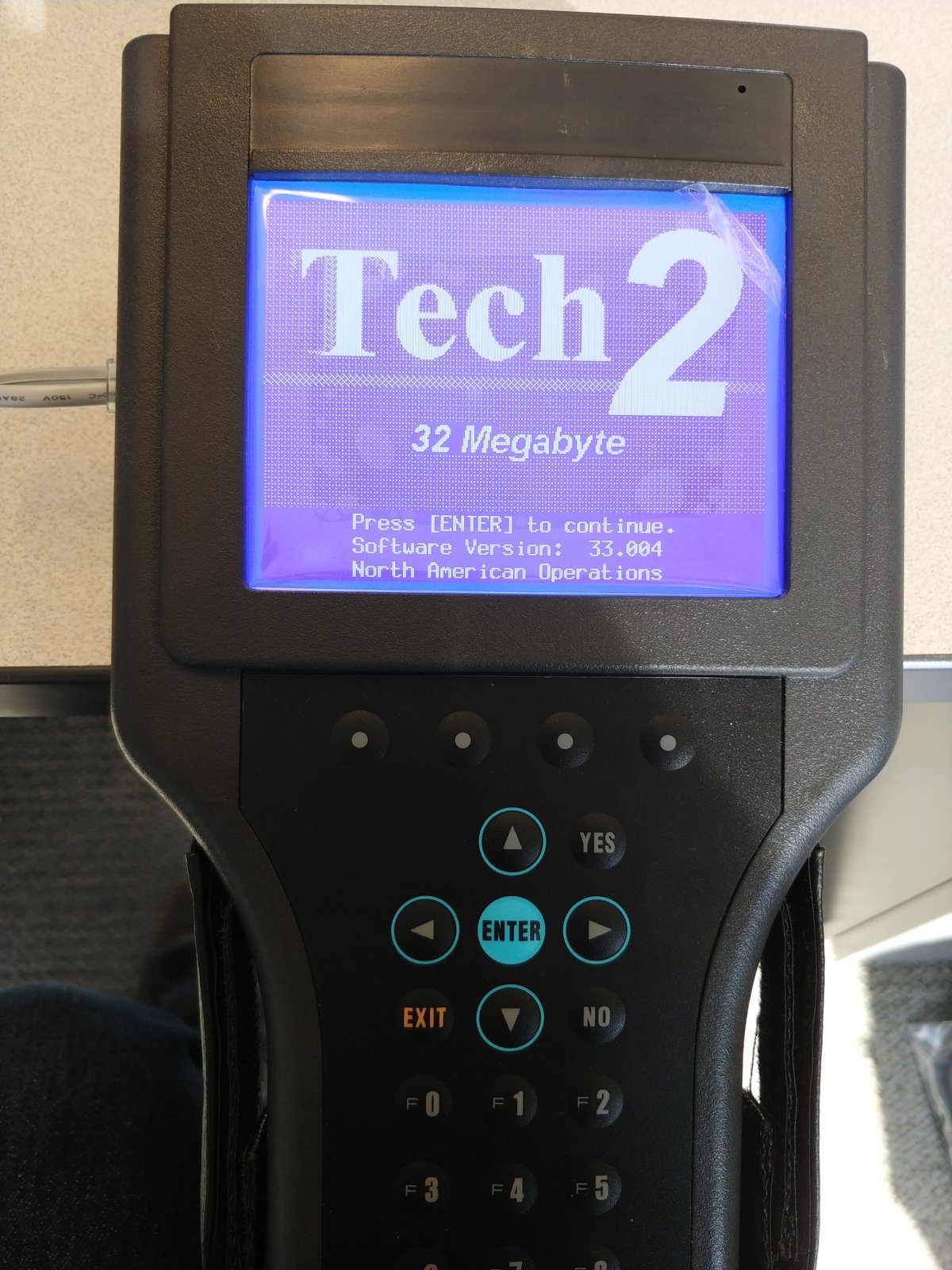

When all else fails, RTFM... The section called “Initial Hardware Installation” under “Getting Started” may have been a good place to turn first. :oops: But I can’t help it, this whole Tech 2 adventure has been such a rollercoaster of emotions, and I was too excited for it to work!
Here is the happy picture I was looking for:
Version 33.004 and all. The work day can’t come to an end fast enough now so I can hook it up and play!

The Candi module was not attached in post #33 right? It should be mentioned on the display right below "32 Megabyte".
Your photo jogged my memory and that lip on the door is the obstruction to the PCMCIA slot on mine too. Must've been a Friday afternoon build or Monday morning build!
