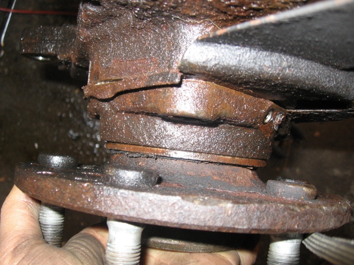

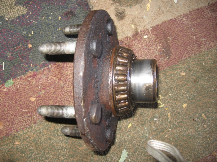

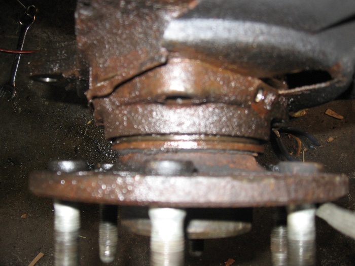

Busted wheel bearing and stripped axle half shaft! The error code kept popping up on the dash and the switch kept flashing for the last few days then today it began to make an intermittent loud grinding noise. I ended up pulling the wheel, caliper and rotor off and began tugging on the bearing only to find 1/4" of play in the damm thing! As I got around to pulling it apart, I noticed the teeth on the cv shaft were ground smooth! And to think I replaced the switching module earlier thinking the problem was in the transfer case and it was the bearing all along taking a shit!

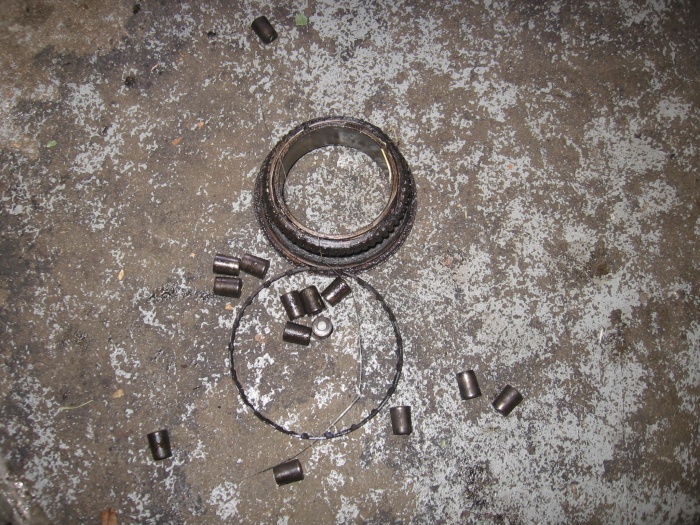

just finished the son of a *****! I cant believe how much it must have been dragging, for the last few weeks it felt like a hung up caliper, there was knocking when turning, a rattle in the front end and the steering wheel wasnt straight, it drives so much smoother now and is dead silent and pulls nice and straight. I didnt get any pics of the half shaft but that thing was ****** too, the teeth on the end of the shaft were rounded off and smooth and the the joints were crunching and very loose. Good thing I didnt wait for a shop because I would have had to drive it and that bearing was just a few whacks away from falling apart. the vid I took of the bearing movement was crazy!
just a small gap.....
did not like the sledgehammer..
