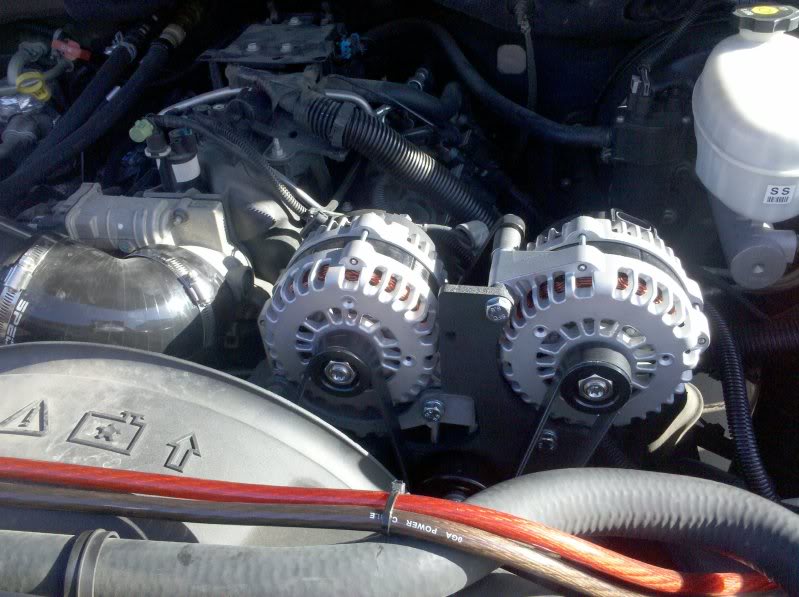

has any one used one of these kits? are they any good of is it some cheap japan crap that is a wast of 450 bucks my system in about 2600 watts 2 jl 1200 watt amps bowering 4 15"inch kickers and i got a 500 watt amp doing the interior speakers and i need more power them the stock oem pice i drain it right down i all ready got dual batterys also

A bracket is a bracket. I'm planning on running duals soon, probably getting the bracket from mechman or dc power and i believe for both the bracket is 300ish alone, but that's a good deal for the bracket and the alt. You should get it and let us know how it goes.

How much output do you need from the alt. You can get one that puts out 300 itself. Iraggi has there bracket that can put up to 4 on our cars for about 420 shipped

imnot shore the output i run about 2700 watts of just system
A 2700 Watt system needs 225A from the alternator (2700Watt/12V=225A). Nevermind all the other electrical load that the car draws. So add 225 on to the top of the rating of the stock alternator.
