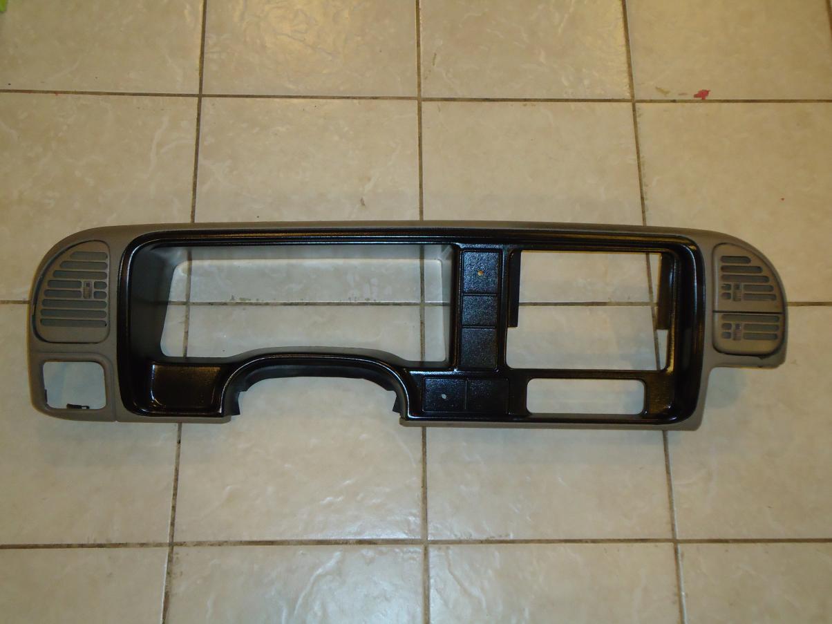

double din installs have been gone over to death here lol everything from an install like mine to this one here, to the detailss kits. Personally I like mine because it looks almost factory with no filler paint etc, but to each their own. the gauge faces look like these here http://www.usspeedo.com/gauge-face-kits/aqua-edition-gauges/

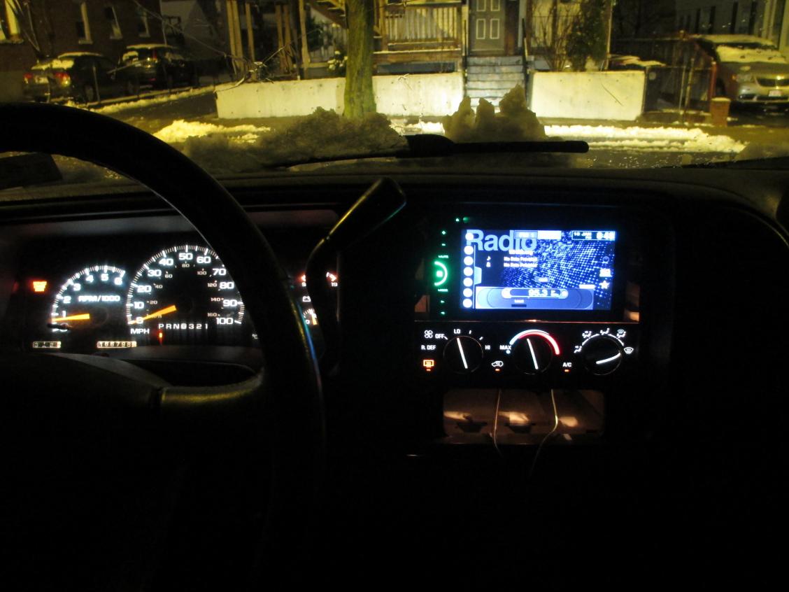

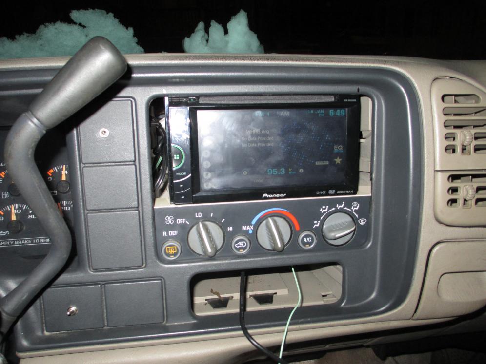

this was before I reinstalled the HVAC controls, but the radio itself is done I linked a write up I did a while back on another forum

My eyes could be playing tricks on me but that looks like a 1 1/2 din not a double din. Either way, looks good :waytogo:

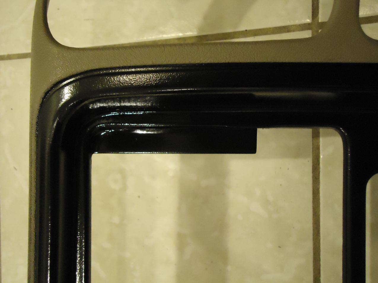

Thats a sony xav 601bt, by cutting up.into the dash instead of down I got to keep the factory look, the upper lip of the dash covers the top of the unit a bit but I can still put in disks so Im cool with it

The xav601 comes with a very thin filler plate the plastic is about as thick as the box that a 12 pack of soda comes in, I had to trim it a bit to fit around the snaps for the dash. I'm not sure if that was a standard piece of equipment for this reliever but there only thing I have found similar was a 2 inch wide ring of untextured plastic by scorpion adaptors I believe, I didn't end up using it
