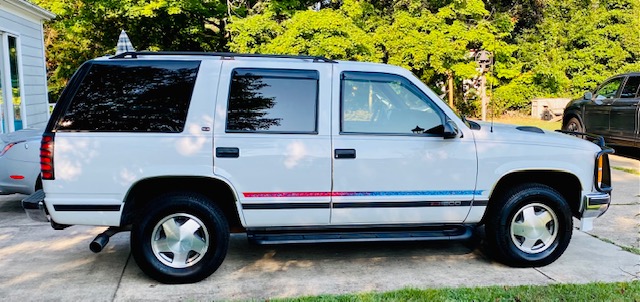

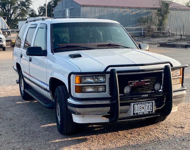

Friends, so sorry for not replying sooner. I checked most of your suggestions - to no avail; The sound seemed to change a bit over time - and sounded VERY MUCH like a brake pad wear indicator (Which it wasn't - nor was there anything in the dust shield making contact). Anyhow, with my available time exhausted, I jumped in the Yukon and drove it 1800 miles from MD to Boulder CO. I figured if something broke, it broke. Well, nothing broke, except that the noise, while still present, diminished in volume. I have since 'sold' the truck to my youngest son (who can say no to a veteran?). I so appreciate all your thoughtful and considerate advice.

most likely the plastic scoop on the hood, these trucks are notorious for having noise's from non oem stuff in the front, i had a bug shield, when you drove over 55 it sounded just like it was raining, you could have closed your eyes and swore it was raining outside, air around the mirror's can make a whistle sound also even if they are oem, led' light bars, etc, etc
