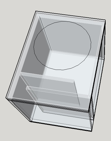

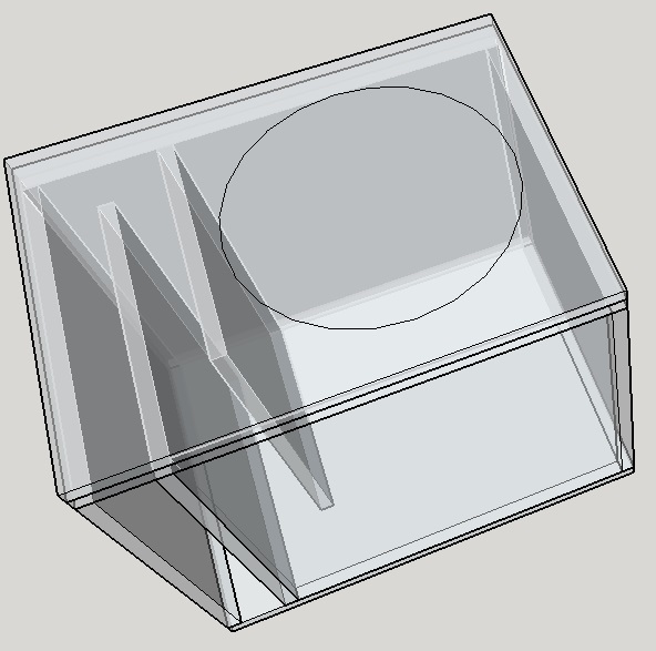

Could someone check out this box design and tell me if im right on my math?
is the port dimension right for the sub?
will this configuration work? any other info/advice you can give me
id be happy to pay someone to help me get this right.
i don't want to waste material and labor building the wrong box
02 GMC Yukon
Pioneer 8600BS headunit
pioneer 4ch 600rms powering front componets and rear 3way's
pioneer gm-d9601 mono amp 1200watts RMS @ 1 OHM
DC LvL 3 15" Dual 2 OHM
Box:
width: 24.5"
height: 20.75"
depth: 18.5"
port width: 2.5"
port height: 18.5"
port length 1: 15.25"
port length 2: 13"
total port length: 32.75
Box volume: 3.43cu. ft after port
After sub displacement i should be around 3.25cu. and
between 31-32hz if this is right.
sub firing up, ported to the back

If you can wait till Monday I can run it through my program at work.
However off of just math I am showing 3 cu ft. After displacement. And 32.9hz tuning. Your port length is actually 31.5.
