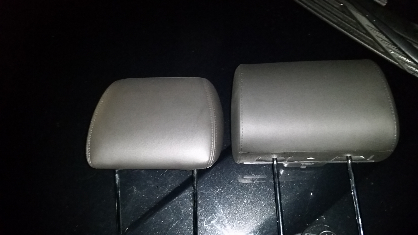

Side by side. OEM headrest on the left and the Concept Chameleon on the right. Noticeable difference in size.
