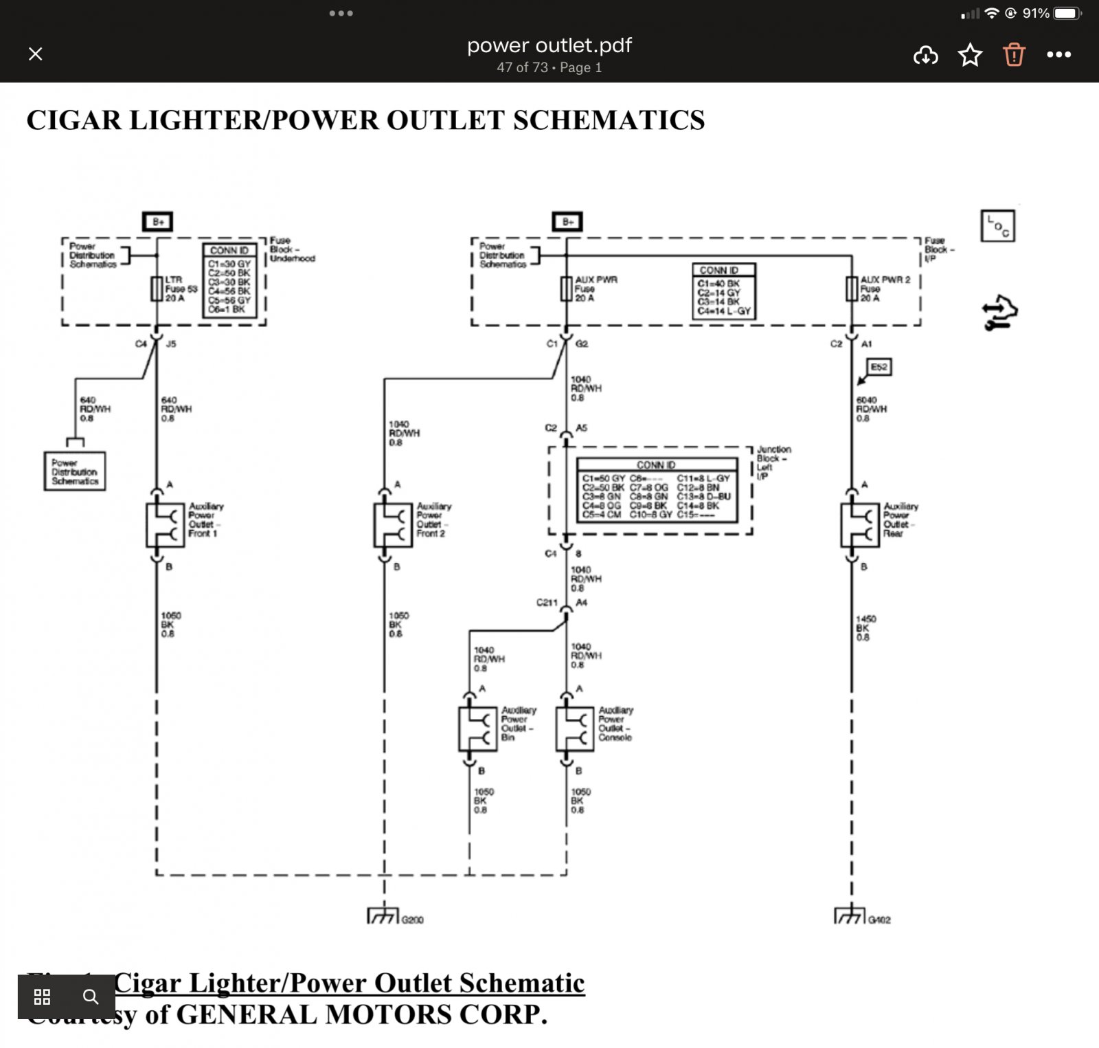

My center console cigarette lighter external port does not work. I’ve checked the two fuses (16 internal, 53 external) and they are both good. The other 4 cigarette ports all work (2 under radio, 1 center console internal and 1 rear area by hatch) and I don’t think that one port has its own fuse (or does it). All the controls on the 2nd row center console also work OK. Any ideas what to check and how do I pull apart that area to check the wires going to it?

Checked the wiring diagram and both center console outlets are served by the same fuse (16). So I guess I have to tear into the console and see if it’s the wiring or the jack itself.
