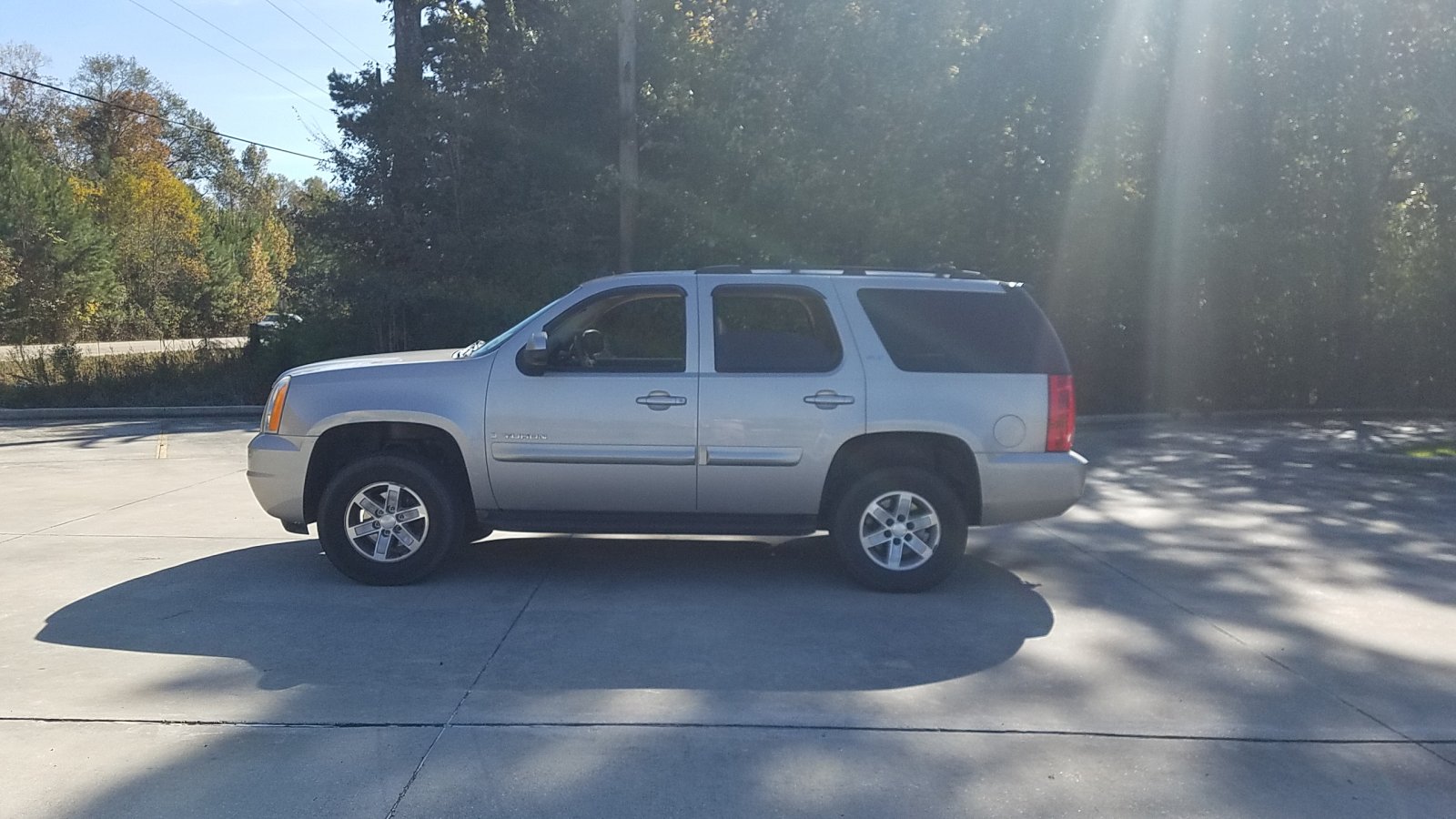

Anybody use this kit and the front is higher than the rear? I think i'm gonna use a 2" spacer for the rear, a slight rake would be fine/better to me.

Did you have rear sag already> word springs? Tired shocks?

95% of every leveling kit Ive seen done here looks like it ended up being higher in the front than the rear.:eek:
I opted for the CCM but pieced mine together because the regular one they sell (2.5 frt and 1 inch rear) has always ended up looking like a Cali-lean. (frt higher)
I went with a full 2 inch rear coil spacer along with the 2.5" front lift. Mine ended up perfectly level with no rake.

It looks like the front may have settle some. Rear is about 3/4" higher now

I have a 2.5 in the front only. And it sits 1/2l higher. Looks great and doesn’t have the *** sag.
