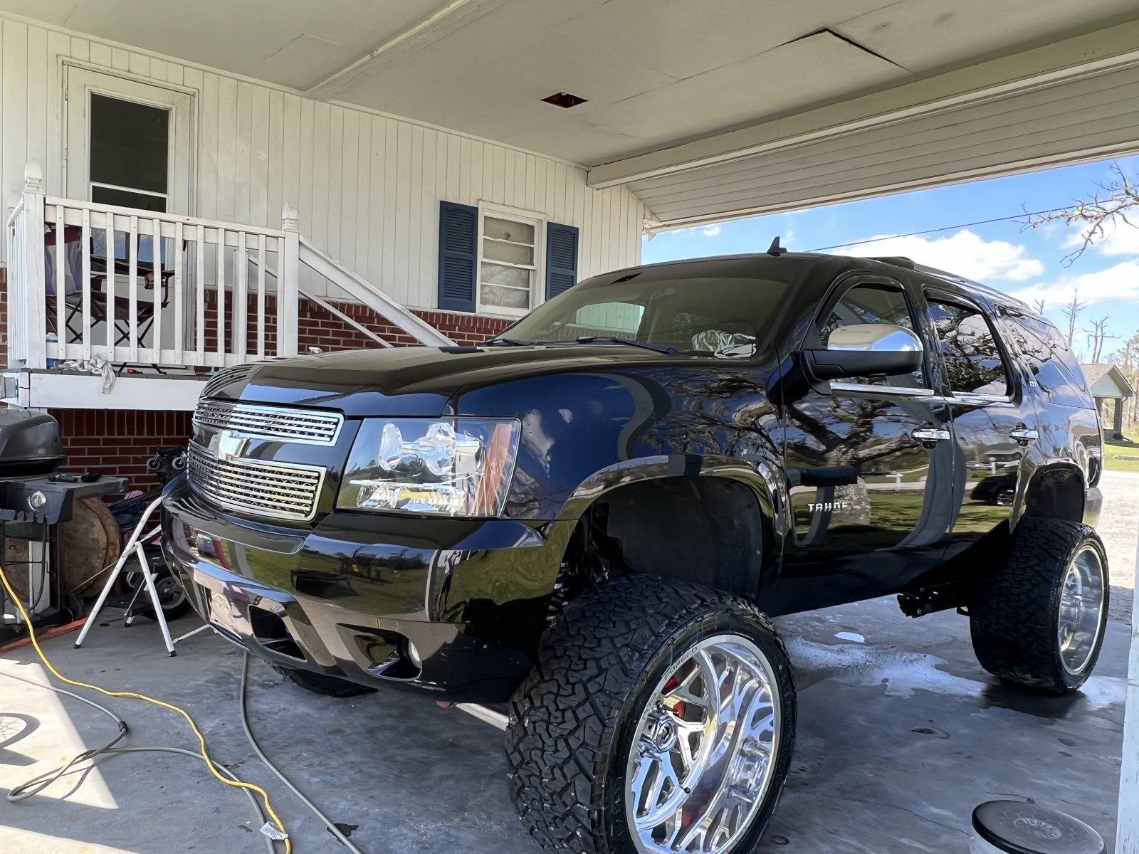

Title says it all my motors getting closer and closer to 400,000 miles leaking oil out the rear seal slight lifter tap on cold starts from the dod lifters I haven’t replaced yet all I did was tune the dod out when we tuned it
I’m going to drive it until something happens to the current motor but I want to go ahead and have a game plan for a replacement costs and start getting everything lined up so when it does happen I can ****** the old one out drop the new one in.
Shooting for around 500-600hp
Trying to keep it under 10K
Any advice or website/company referrals would be greatly appreciated im located in North Carolina
If I could find someone who rebuilds motors I’d be fine with that as I found a mild 6.2 for 5500$ cammed but couldn’t ever get a response from the guy

Damn, your Tahoe looks great for having closer to 400k miles. Mine looks like it was just washed at a concrete plant.
If you can find a bare block and internals, these guys would be good options for a build. Burkett Racing in Jones County & P&M Performance in Jacksonville are two well-known machine shop/engine builders
Thompson Motorsports Sports has a good reputation as well.
Otherwise you can't go wrong with a GM long or short block.
Thanks buddy I talked to p&m about my white truck the head bolt holes stripped and they wanted the motor to be pulled to fix it so I ordered the time sert kit took the head off and fixed it with the help of my step father (retired air force engine shop supervisor) I like to work on myself but do not have the garage or tools to do any internal work so I was trying to find something I could just drop in tune and go and still make good power probably have it cammed out the gate with a good top end internals etc
