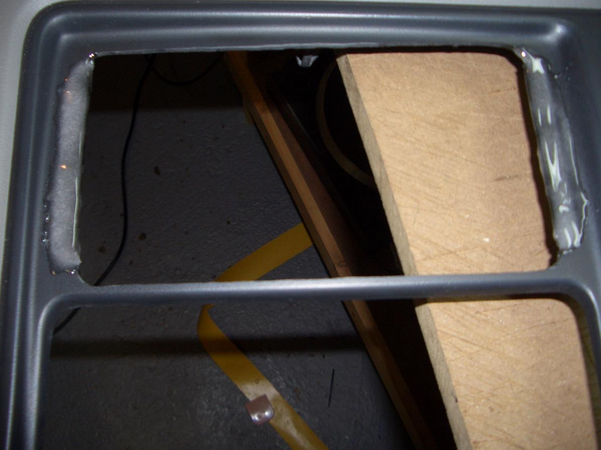

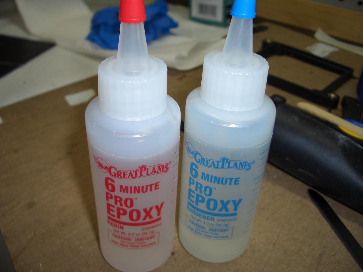

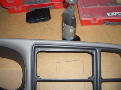

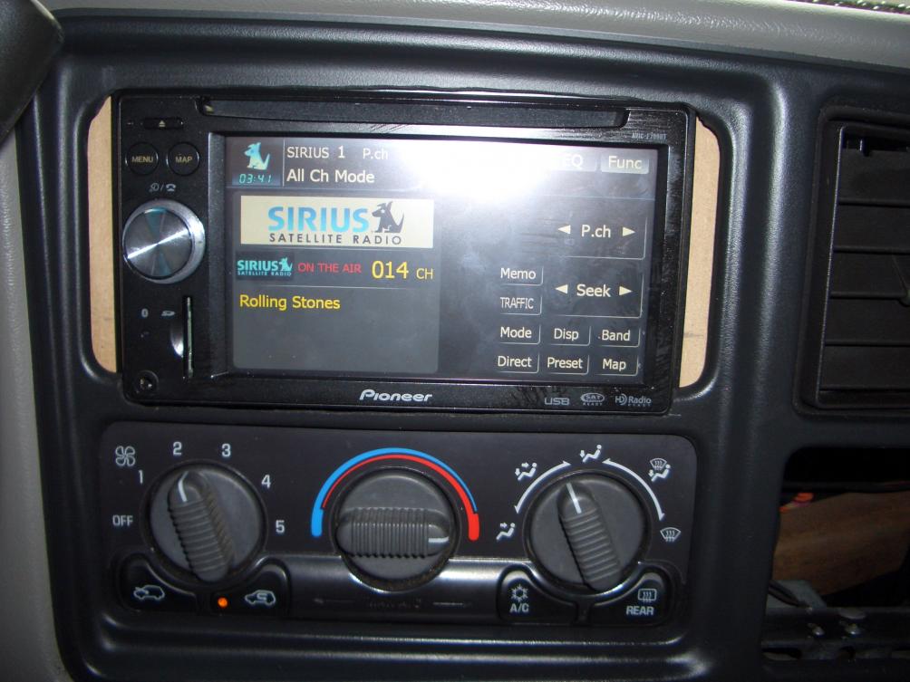

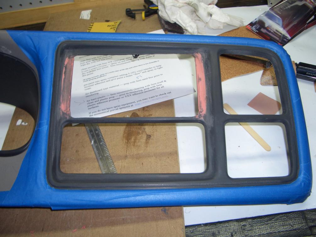

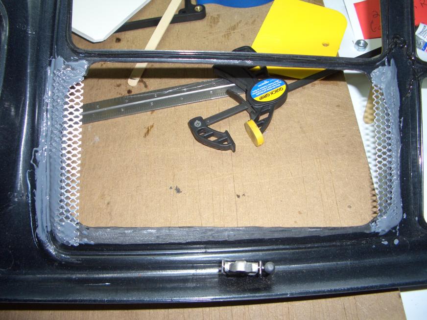

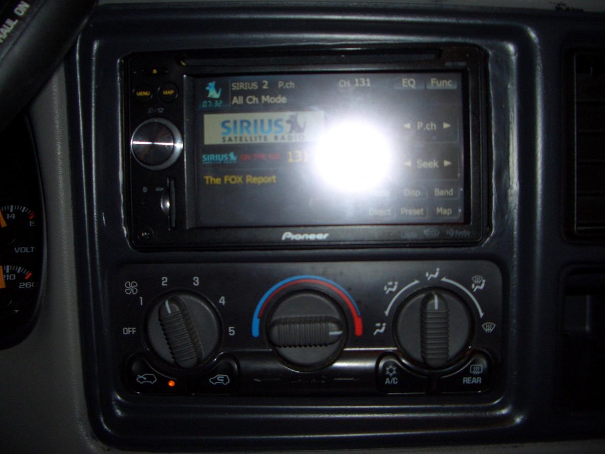

I got carbon fiber sticks and 2 part epoxy from a hobby shop. I used a sticky back screen on the backside of the bezel cut to size. Cut the carbon fiber sticks for both sides, filled with eo=poxy resin. Broke out my trusty cordless dremmel and went to work. I have redone it since smothing it out with a glaze then painting with SEM products
Here are some other pics of the work in progress, never did anything like it before and experimented with fiberglass, popsicle sticks and some other thinks. The carbon fiber worked best especially when it came to sanding and grinding
