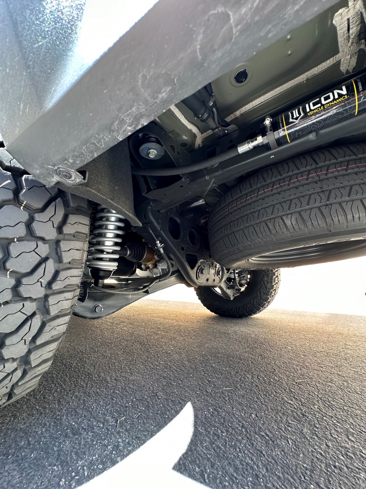

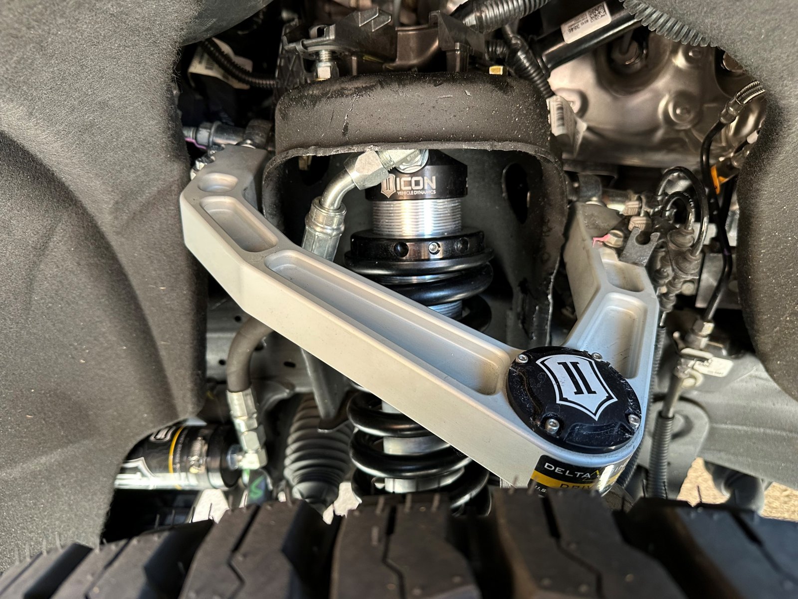

Well, she's done. I went with ICON as i am local and volunteered the rig to be their R&D vehicle. Dropped it off to measure a few months ago and again for installation. I purchased their 2.5" front (and rear) Coilover with R/R and Adjusters, Billet Upper Control Arms, Rear Tubular Upper Control Arm (facilitates more rear travel and tire clearance). Also dropped to 17s, Icon RECON wheels, and a Falken 285/75r17 RT Tire. These cycle lock to lock and NO trimming was required. It looks like 35s will fit with minor trimming but digging this combo for now.
Not sure when they plan to release the kit but I'm THRILLED with the end result. Drives awesome on-road; as much as I want to go hit my local off-road test-track, it's my wife's SUV and i just had it ceramic coated and the Front PPF so i am going to hold off until she gets the first scratch.

Looks great! Can you drop a part # for the upgraded rear control arms? I did the readylift kit on my wife's at4 because it was the only one that retained the magneride but it didnt come with extended rear control arms.

I guess @OCBJJ has left. The rig looks realy good. It doesn't appear Icon has any of this stuff for sale. I may call them.
If @OCBJJ is stil around, what offset are the wheels? Looks like they would be either 0mm or 25mm. I am wondering if no rubbing is due to using 25mm.
