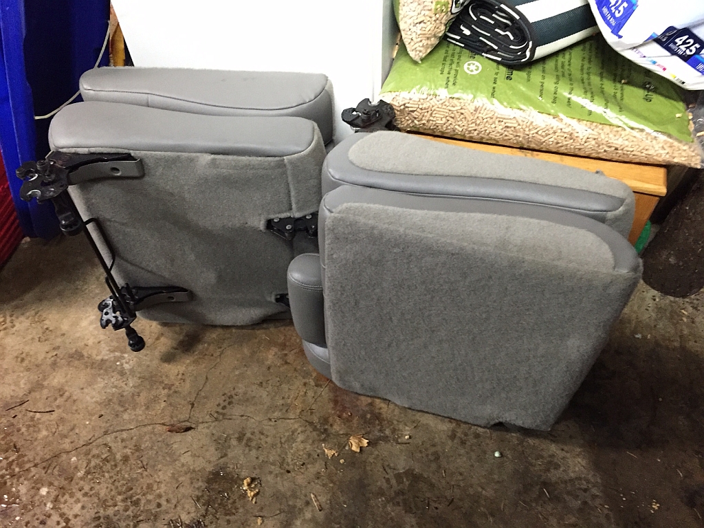

After finding some rare 2007 Z71 seats (black with silver inserts) on a web forum, I picked up the required brackets and go to work.

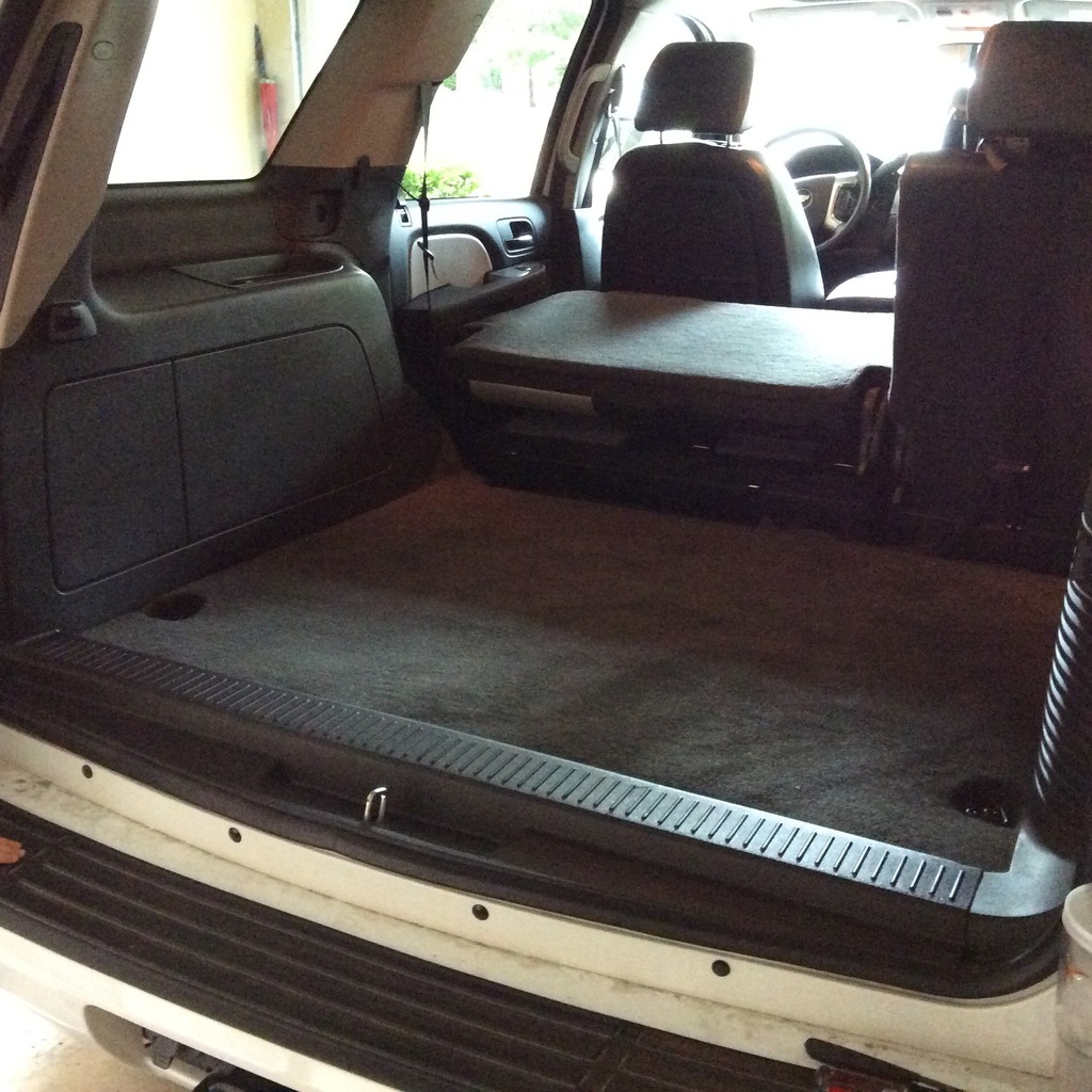

1) Remove the cargo tie down straps. These are 50 Torx
2) Remove the back trim piece. It pulls straight off.

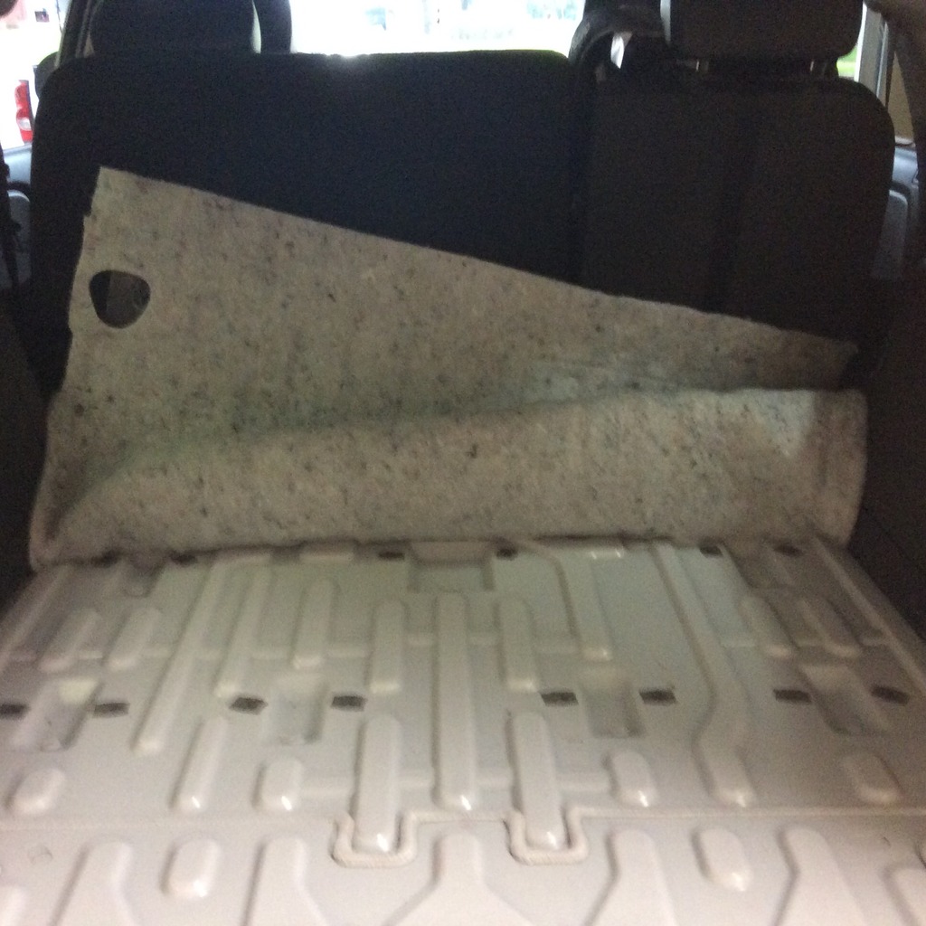

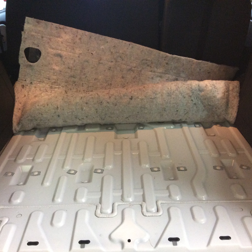

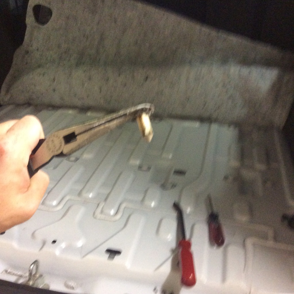

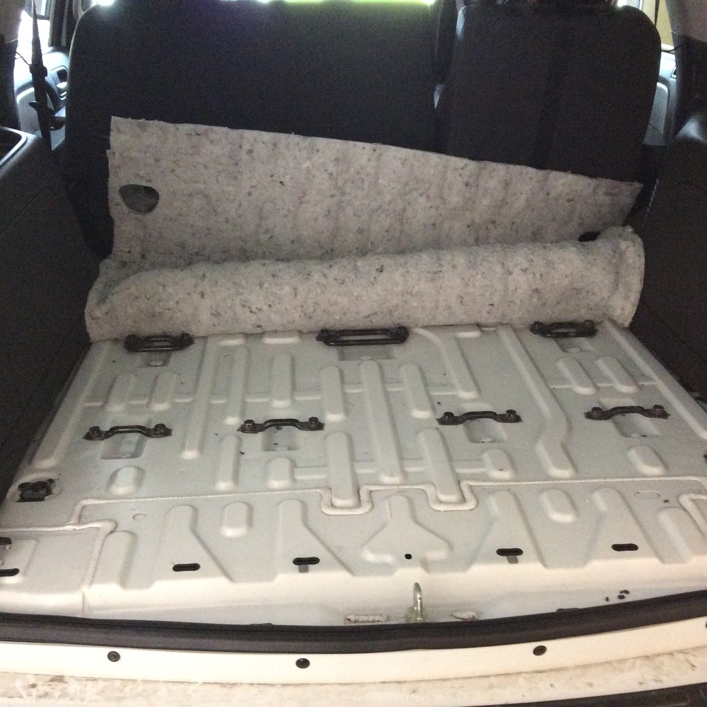

3) Fold back the carpet and insulation. What your looking for is the 14 little plugs on the floor board. If you have these your good to go.

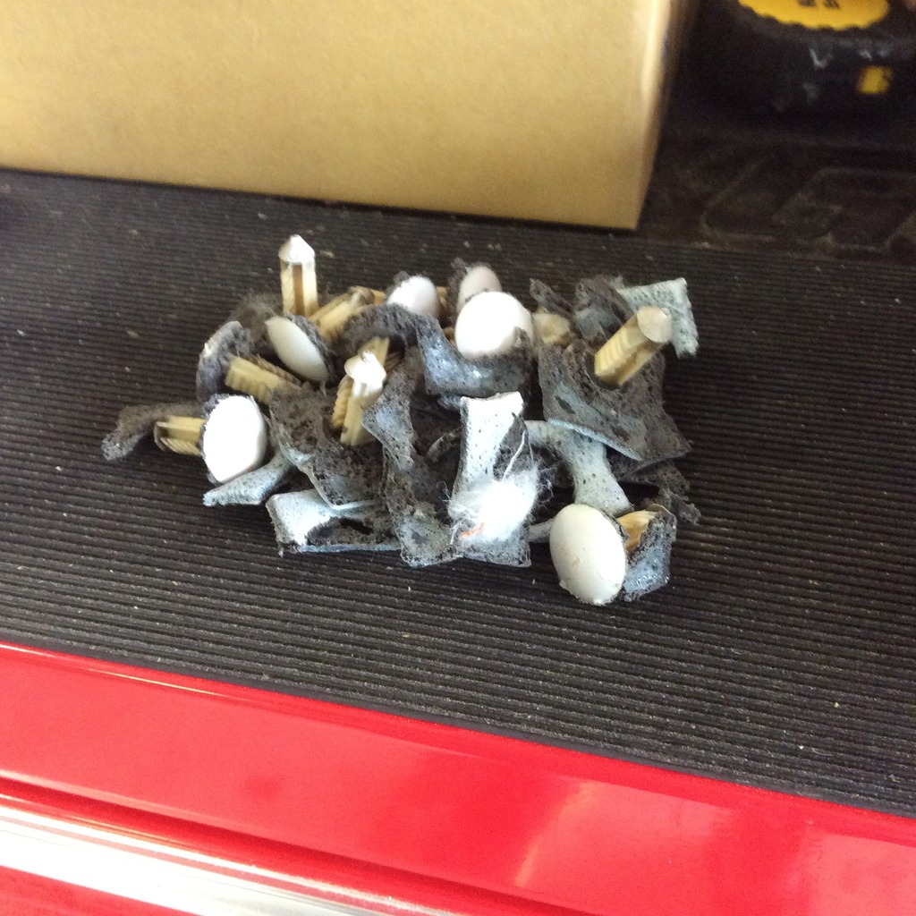

4) Remove the plugs with a flat blade screw driver. Once all the plugs have been removed make sure that the floor is scrapped clean so your brackets can sit flush on the floor.
5) You'll be left with a pile of junk, you will not be reusing it.

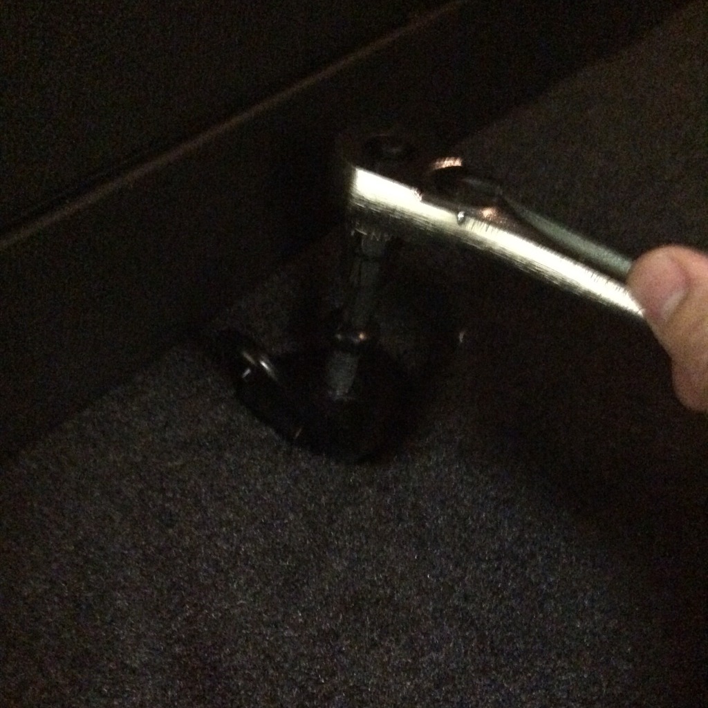

6) Next step is installing the seat brackets. You'll need a 18mm socket and ratchet. Power/Air tools just make it go faster.

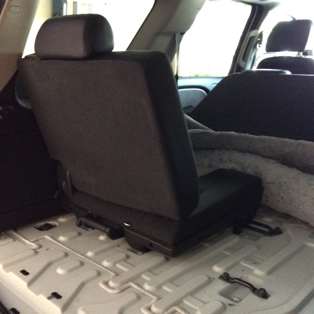

7) Before moving forward make sure your seats fit and everything is lined up.

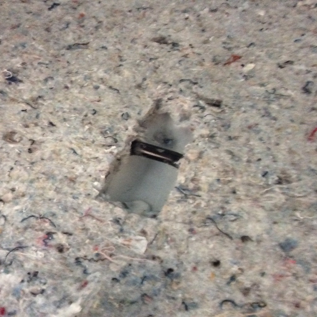

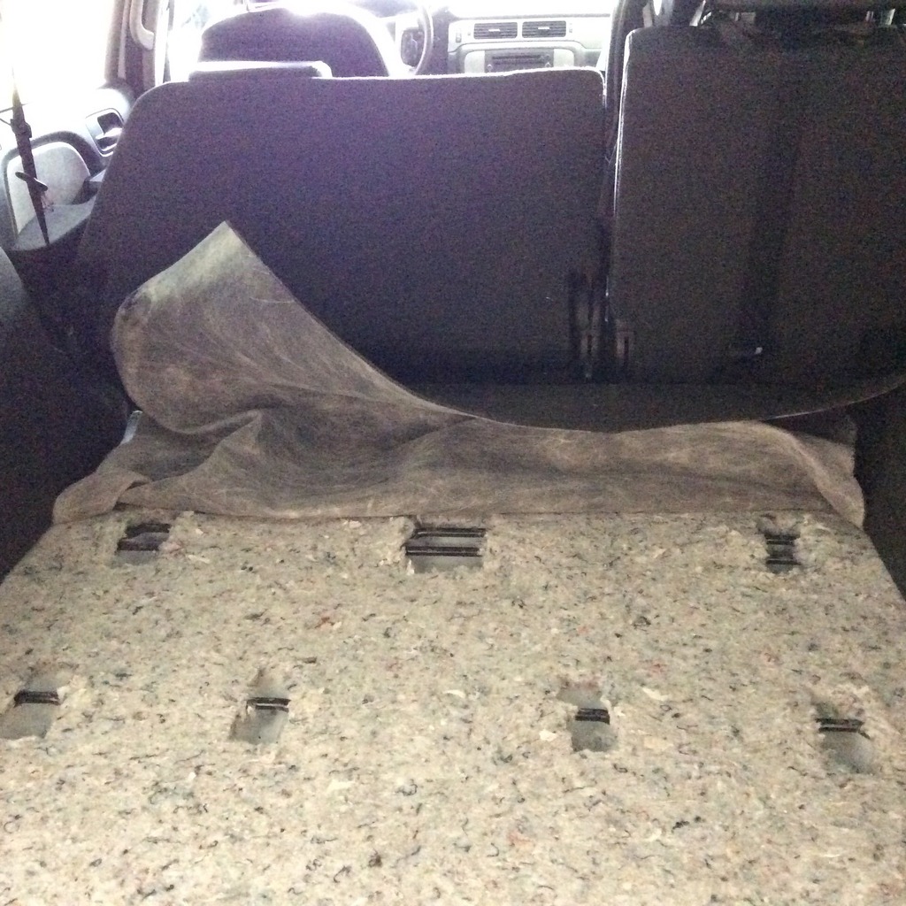

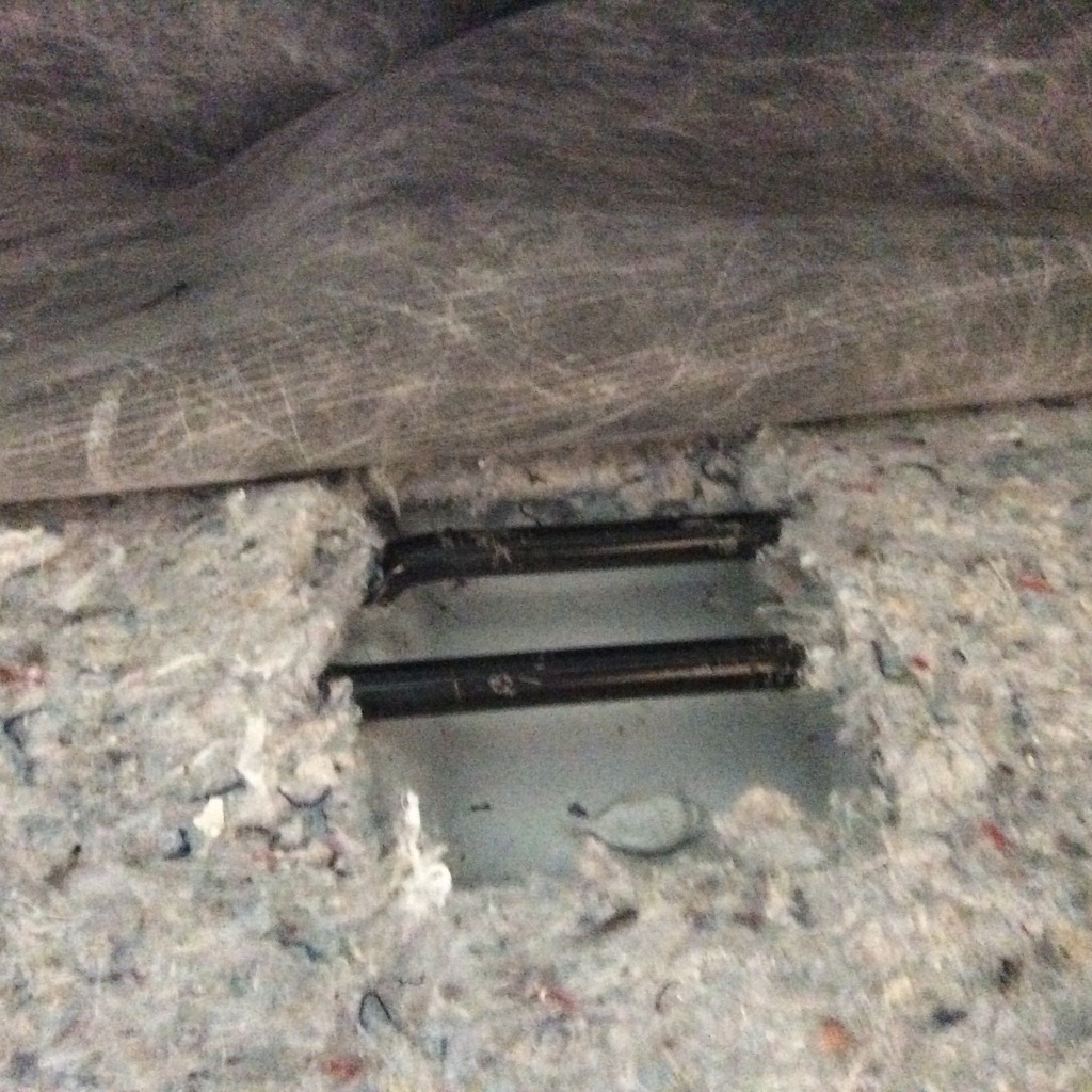

8) Now it's time for trimming. The insulation is stringy so make sure you are using a sharp knife/shear. You need to cut out the insulation that would sit above the brackets. Fold the insulation down over the brackets. You'll be able to feel the brackets and trim around them. Make sure you trim around the bolt heads and the "valley" as the seat brackets actually are recessed into the floor and won't really fit without it.
9) Insulation trimmed. You'll see in my picture that I did not trim around he bolts. To make sure your carpet lays flat make sure your bolts don't have insulation on top of them.

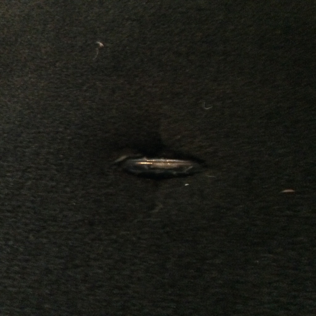

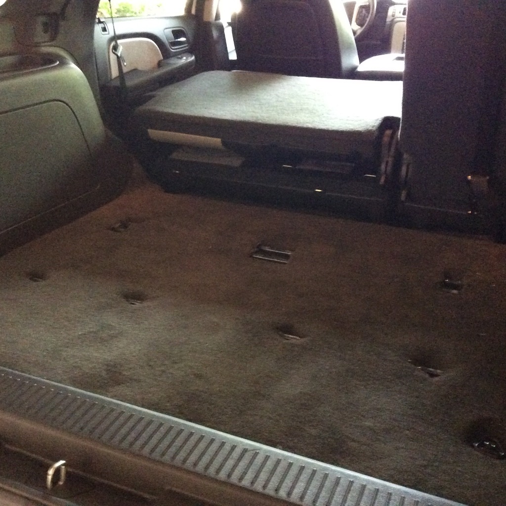

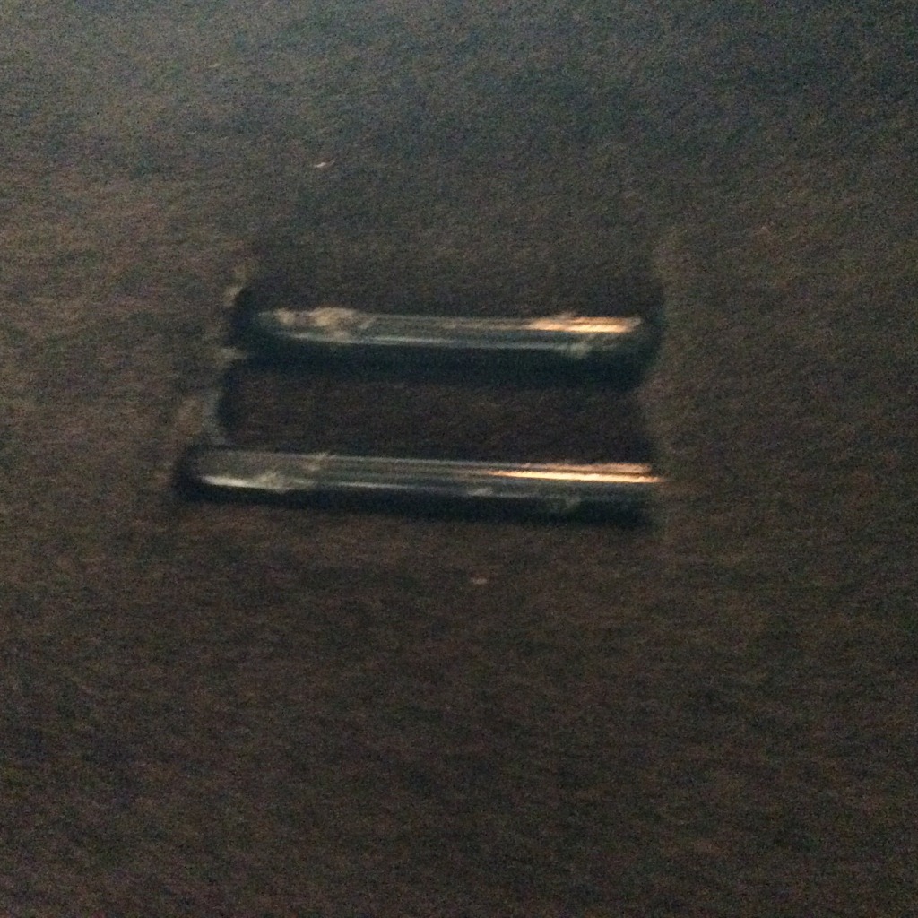

10) Now the fun part, cutting the carpet. Fold the carpet over the brackets just like you did for the insulation. You'll be able to feel the brackets under the carpet don't worry. Tuck the carpet back under the trim pieces and reinstall the cargo tie downs. There are a couple of ways to cut them but we chose to cut the rear strikers in an x pattern. One cut straight down the middle of the striker and another down the valley in each direction. These turned out pretty good.
11) The big brackets are a little more tricky. We chose to cut these in an H pattern. One cut down the middle of the two bars, then two more cuts down the valley.

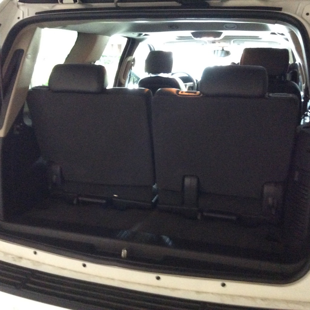

12) All cut and ready for seats

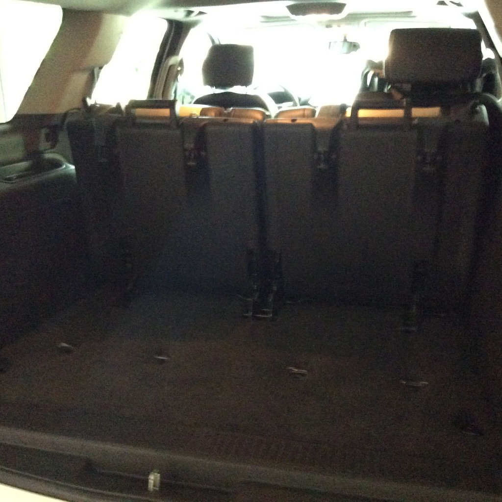

13) Up

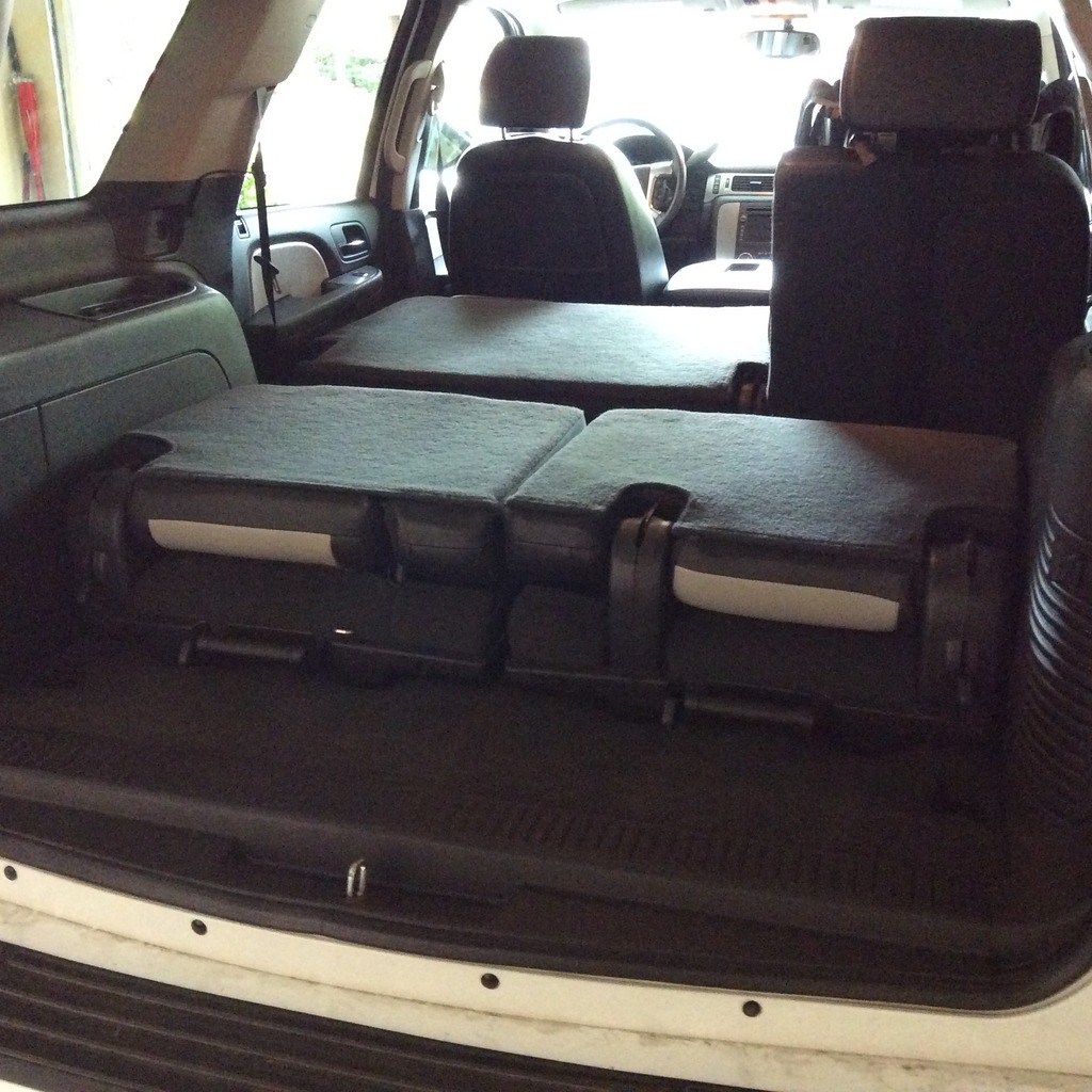

14) Down

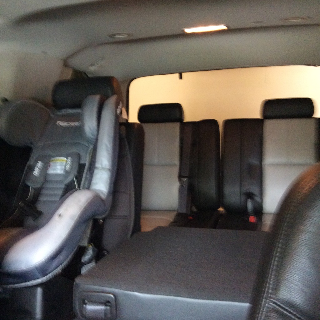

15) Ready to roll
16) Enjoy seating for 8 and your new third row!

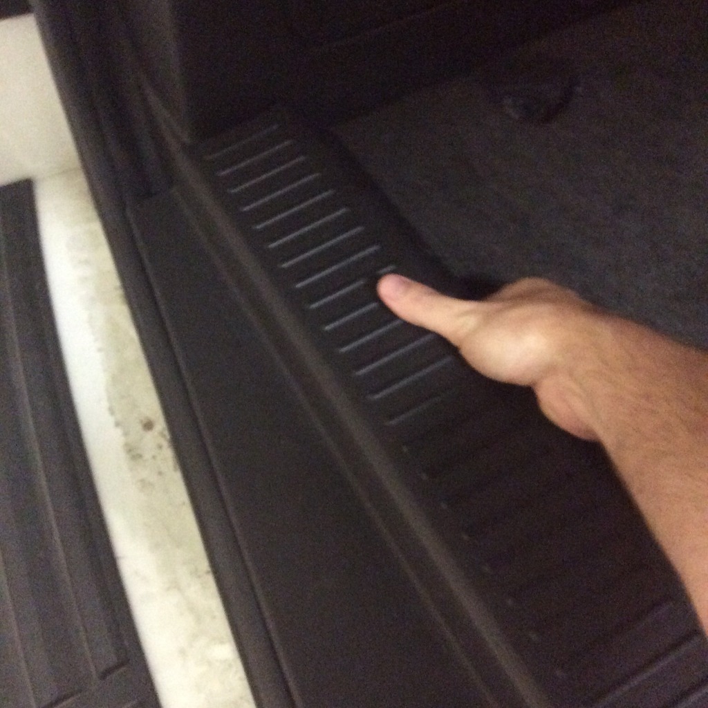

It's worth pointing out that GMT-900 vehicles come with plastic trim to go around the brackets. While I was doing my research I found people often left them off to keep the floor level for sliding loads in and out. I also plan on getting a matching weather tech rear cargo liner to keep things neat.
13) Up
14) Down
15) Ready to roll
