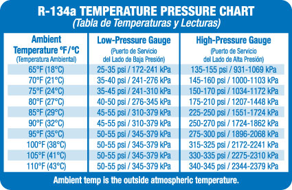

Here is a link to various temperature/pressure automotive HVAC relation charts that list "AMBIENT TEMP" as a variable (probably because ambient temp doesn't matter).
More:
https://www.google.com/search?q=aut...v&sa=X&ei=NITlVJOMAYnYoATQ4oHICg&ved=0CB0QsAQ

Lol, so why do you feel it lists ambient temp?
You do realize you are making my point right?
The ambient temp doesn't matter beacuse you adjust for it. So you can charge when it is 40 or when it is 70. You can do it whenever. You don't need to wait until it is warmer like you said.
It "doesn't matter" because you adjust for it. Reading comprehension my friend.

If you look at the chart smarty pants, if you go below 65F your low pressure gauge would start falling near the 0 psi limit. Get cold enough and your pressures become unreliable. That is why it matters. Is that really that hard a concept to grasp?
