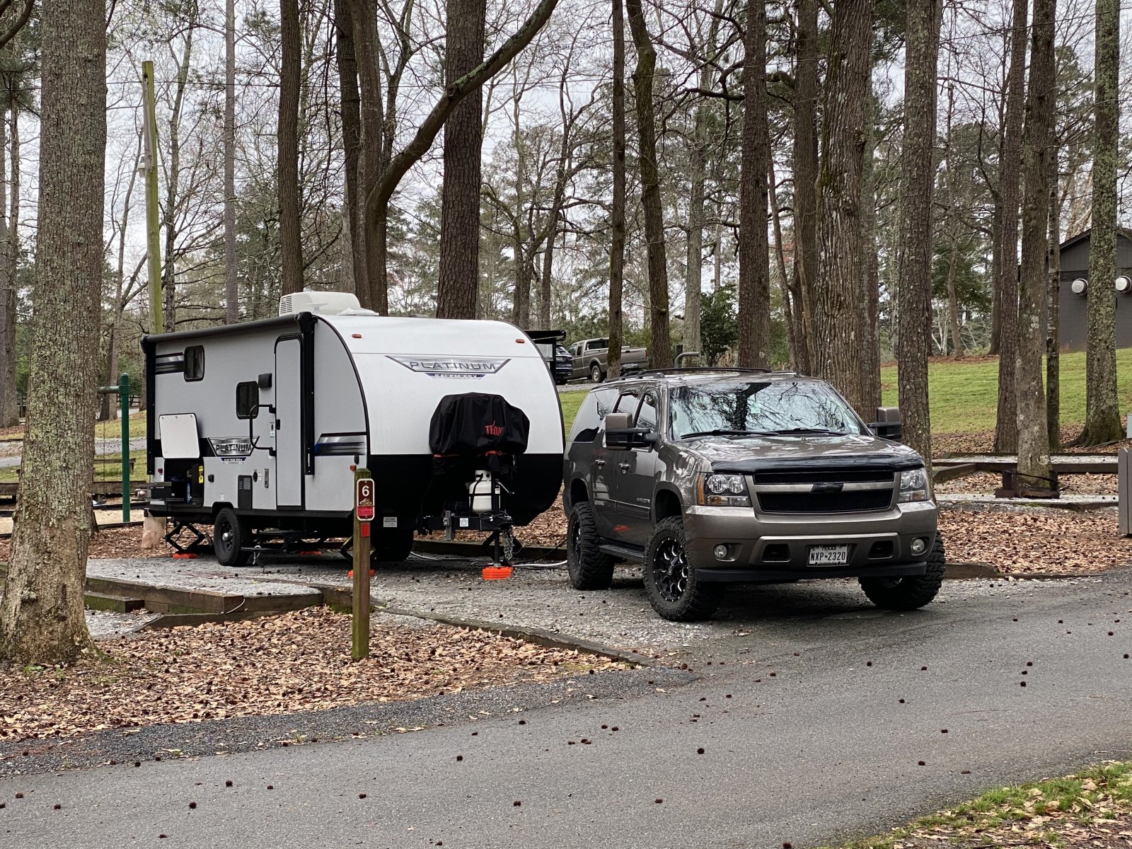

After picking up our new camper with the factory 3.42 gear set I swapped in some 4.11 gears. With the 33’s and towing 65mph it hangs right around 2500rpm and holds speed pretty good on hills. Currently in Georgia but headed up to Tennessee Saturday so we’ll see how it does on some steeper inclines. It’ll pickup speed in 4th. easy and my trans temps have been running 160-175 degrees in 75 degree ambient.

Nice! That a 4-speed truck?

Cool, looks great! So that 2500 rpms at 65 is in 5th?

Nice rig! You staying at Cloudland Canyon or Fort Mountain? That site could be at either park and both are very nice. I added the 40k Truecool and it made a world of difference but haven't towed yet this year. The factory transmission cooler looked to be useless on my Suburban it was so small. Headed to Gulf Shores for the wife's Medicare birthday celebration in a few days so I'll report back after that trip but I wish there were a few more hills to test it out before we head up to the UP and Wisconsin later this summer. Enjoy the hills - the dogwoods are starting to pop.
Bob
Also - any issue with the 33s and the fenders? I'm running 32s and a slight lift thanks to Bilstein 5100s and getting just a hint of scrape at full lock.

That was in John Tanner state park near Carrollton while visiting the in-laws. We’re currently up in Virginia after a few days at Pigeon Forge. I agree the factory cooler is rather small but so far it stays plenty cool while towing. It actually got hotter easing through Cades Cove without the camper so I will probably add a bigger cooler for the Texas heat this summer and maybe an electric fan as well. We have a 3.5” lift with some trimming (just plastics) and don’t get any rub. They’re 33x12.5/R18 with -12 offset.

Thanks for the info on the tires; I may just trim the plastic a bit and call it done. My lift is more like 1 - 1.5" from my bigger rear springs and setting the front springs on the first perch up from bottom on my Bilsteins. As a data point for you - with the Tru-Cool I never saw more than 135 degrees from the transmission on that trip to Gulf Shores (daytime temps in the mid-70s). I'm going to keep an eye on engine temps this summer; want to make sure all is well with that big cooler hanging in front of the radiator, even if it is a 3" thick dual core. I could switch out the Tru-Cool for a Derale with fans that might fit below the radiator if I don't like my engine temps. I don't want to hit Big Bend later this year without some serious cooling for everything. We'll have to check out that park in Carrollton - it looks nice.
