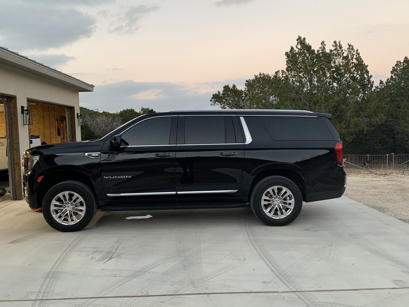

Only picture I had stock right after we bought it

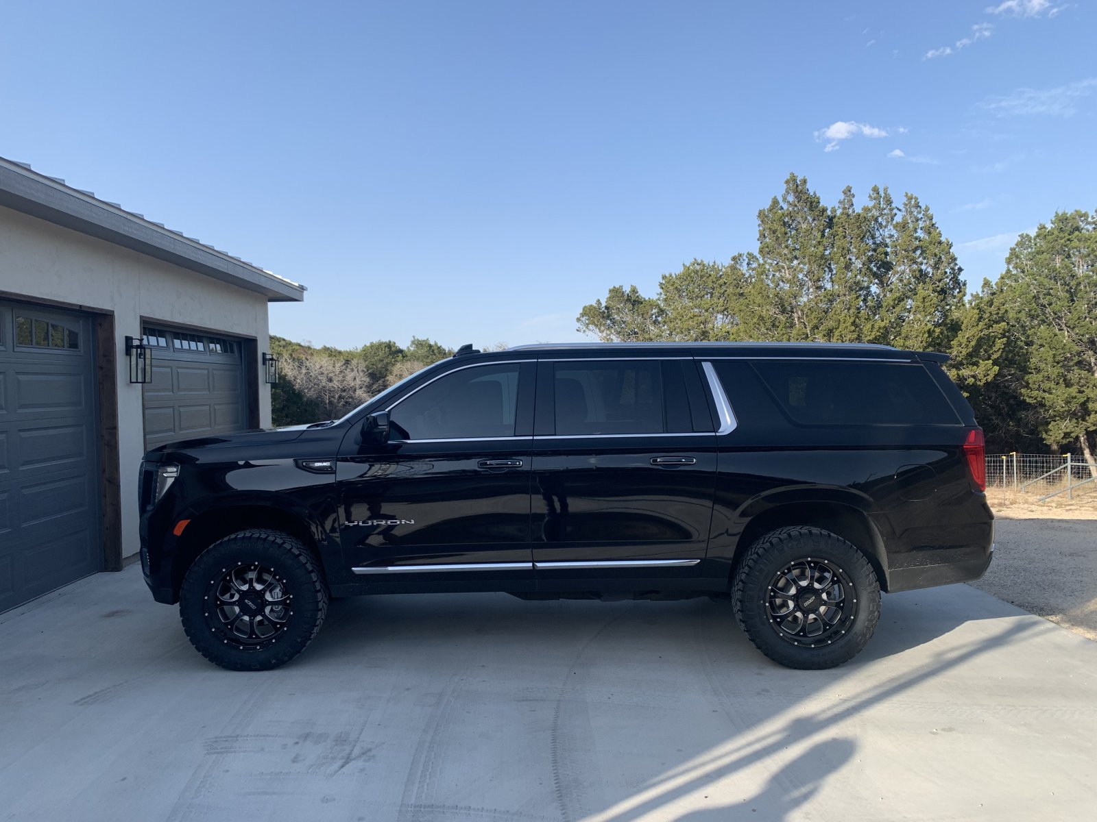

3” front lift on
2” rear lift added

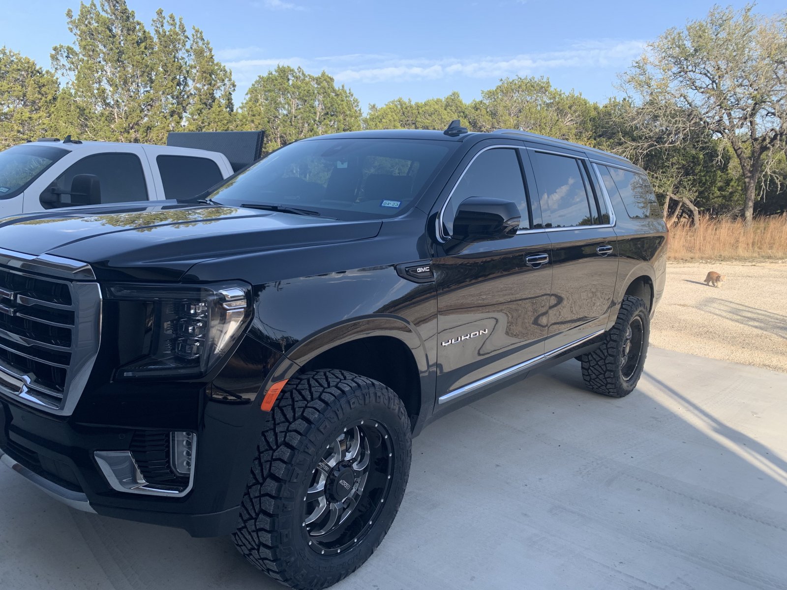

Wheels and tires on

Any rubbing with that set up?
Just on the Huskey mud flaps and just a little bit. I trimmed the flaps a little and it's pretty good. I will still get a tiny little rub when........backing up with the wheel turned to the right about 1/3 from max right, while ...... backing down the apron of the driveway. Has to be backing up, has to be going down the apron and has to have the wheel / tire in the perfect spot.
Hope that makes sense.....LOL
